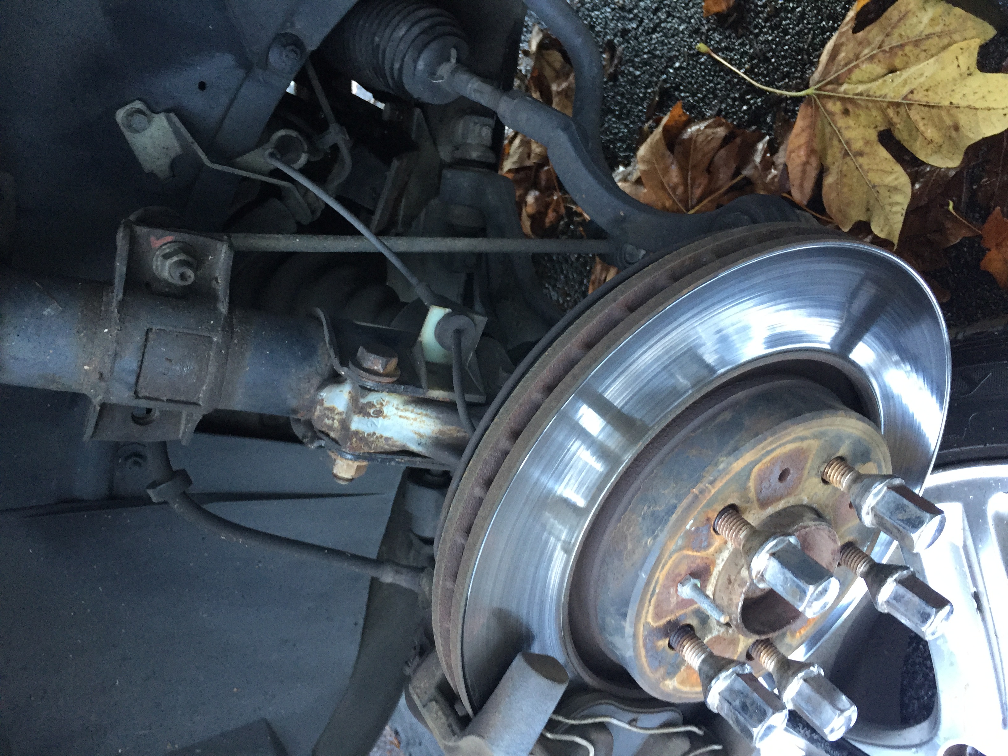

I can snap a couple pictures in a few hours when it's light out again. It is a very nasty noise. What's strange to me is that if it's transmission or differential why it makes such a sound bringing the wheels to a stop under braking.
That being said I can spin the wheels pretty freely by hand. I'll see if I have my stethoscope laying around somewhere still and go back under. It does seem to be coming from the transmission side up front.

beigg wrote:I am unable to watch the videos.
Any pictures of the braking system (with wheel off) ?
If I had to guess, hub bearing is bad.

Great pictures! Thank you!
Just to be certain, one last photo request.
Snap pics of the forward facing section of the caliper; Ensuring visibility of the open pocket area of the pads clamping the rotor.

I really appreciate the input guys. I'm sure a lot of you have been there before but this has me really stressed out having a newborn and all. After getting the car into the garage and on jackstands I was able to remove all the wheels and really see what's going on. As in the video you can see the passenger front barely moving and easy to stop by hand. Looking underneath it the shaft is spinning at a fraction of the speed as the female side for lack of a better term. This has to narrow it down! Seems to be an angle gear problem but the rears are spinning fine. Is there a collar or spline I can replace or something?
- rspi
- Posts: 7303
- Joined: 5 November 2011
- Location: Cincinnati OH
- Has thanked: 34 times
- Been thanked: 72 times
Contact rspi..
If the collar is worn, the gear teeth are likely damaged as well. You can pull the shaft out to see if that is the problem. Takes about 40 minutes.rdwhittaker wrote: Is there a collar or spline I can replace or something?
These are usually damaged if all tire sizes are not the same.
