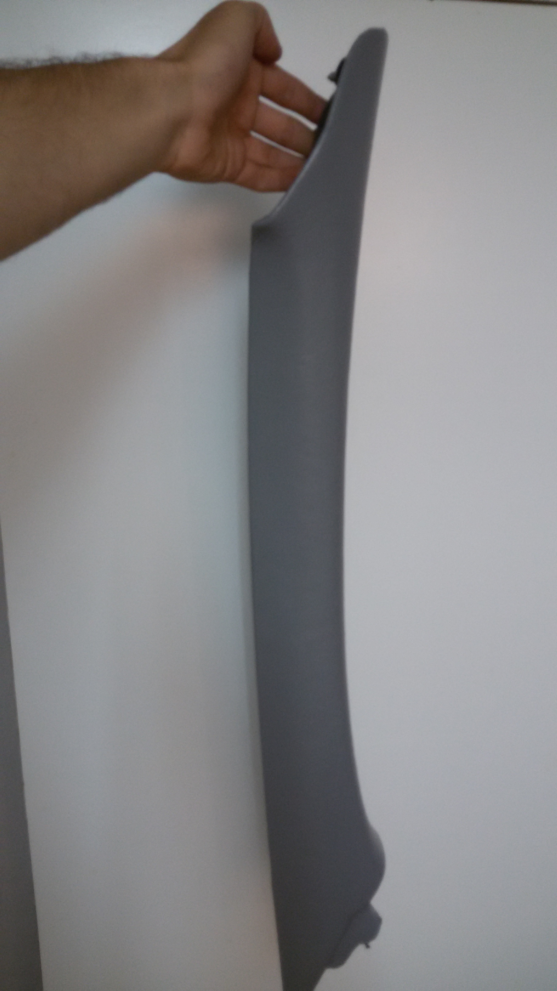

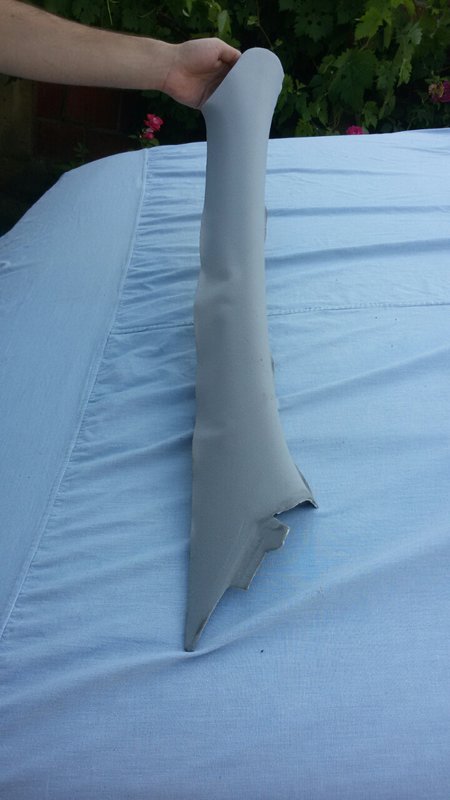

Hi Thomas,
I did remove my A Pillar trim on my S80 but it is a 99 model, I did it because the material was peeling.
It should be the same, you should remove the door seal which you only pull and then you put your fingers on top of A Pillar trim under it and you pull it gently it will only pop a little than go a little bit down where you will find another clip which you pull too gently, after you do this you go on top and under the trim you should be able to see the spring you should remove it from the place where it is holding on A pillar with a screwdriver, after you do it nearly at the bottom there is another clip and then you should move it up and down while you pull it to remove the teeth from dashboard .
Check also the drain hole under the windscreen wiper as there could collect leafs which block it and then the water goes in the blowing fan on the cabin filter and on the floor.
I hope I could help.
