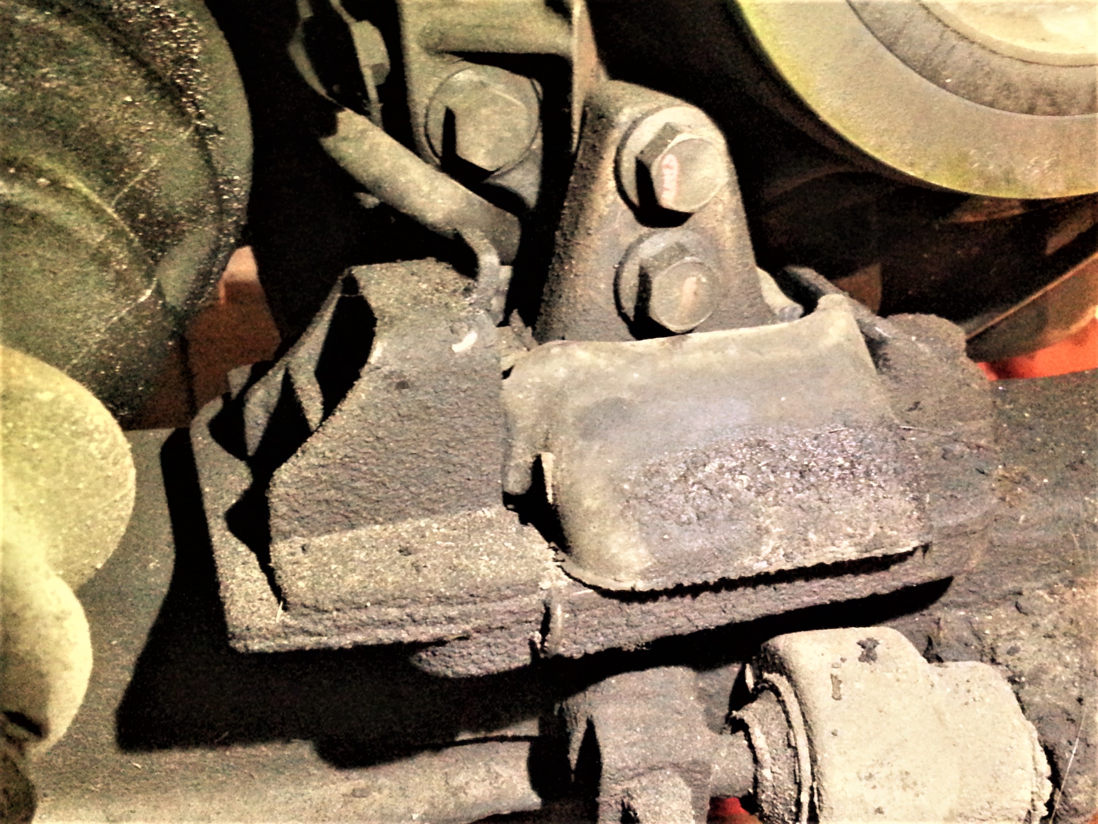

1999 V70R 160k miles has developed an anonymous knock from what sounds like under the car and to the front passenger side. It doesn't seem to be affected by light load and is intermitent when driving along jerking the steering left/right. It will stop clunking when over 40/50 MPH. It is not an obvious dangling or loose part. I replaced the struts 3000 miles back and the knock didn't start until a 1000 miles ago, so I can't say one caused the other. Can detect tiny amount of play in 1/2 shaft that side. Drive shaft to back axle has small noise but different frequency so I don't think that's it. Any one know this noise ??
Also......this car smells a lot of engine oil at start up with no obvious leaks. I think it's most lightly the PCV valve and related kit. I'm wondering if the PCV valve has any effect on the throttle response, it being intermittent and prone to surging. And would the PCV affect the transmission which had got a bit jerky too even after having the tranny fluid changed ??

IS the axle play axial (along the direction of the axle shaft) or radial (play in the CV joint)? You should not feel any play in the radial direction

Good idea to check the CV axles, but I am also wondering if the AWD drive shaft can make clunking noises when the carrier bearing is failing?

On drive shaft, there is s tiny amount of rotational slack and 3/8' longitudinal. Is that sign of knackeredness ??

As I am looking for a variety of knocks, clunks, groans under my car I wish I could help on those, but having replaced most of the suspension, bushes, end-links, anti-sway bar at both ends it drives me nuts!

On the clonks, check the sway bar end-links, they groan and then start to clunk as they fail, check the bushes on the front ant-sway bar, sheck the engine mounts, particularly the one under the crank pulley, and the top torque mount.

Yup, that will cause a clunk! Buy a good quality part as a lot of the aftermarket ones fail quickly.

Waal, changed out with a cheap and nasty. Still have klunk, so I'll have to gouge the other mounts I suppose, dammit !!
