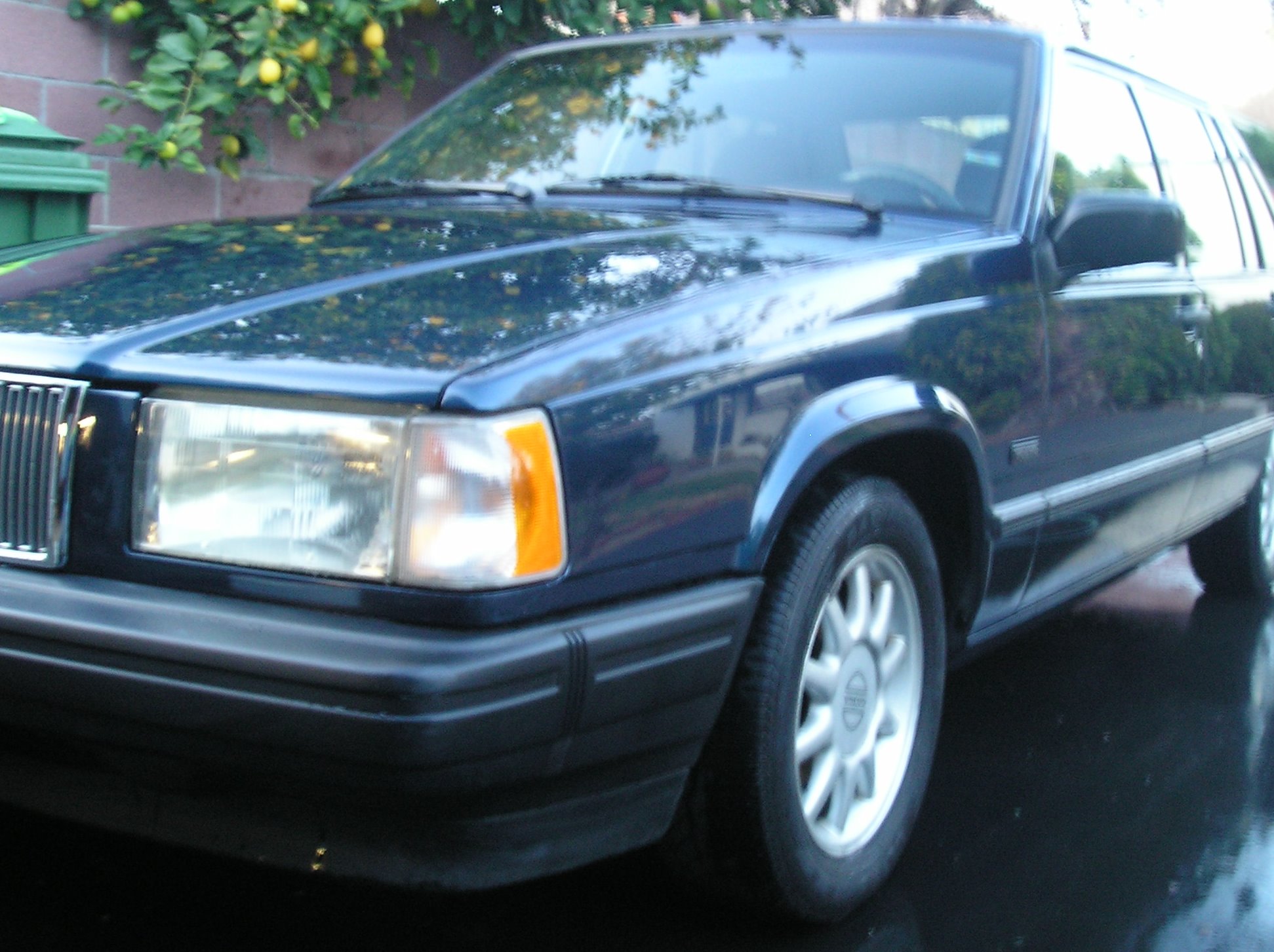

I am creeping toward stage 0 on this 17-year-old car.
Here's what I have done so far:
ball joints
sway bar bushings and end links
new radiator, hoses, heater control valve, expansion tank
new transmission mount
new Bilstein struts, Boge strut mounts, and control arm bushings
new plugs, wire set
the engine mounts, however, were still original. While they were not trashed, I did notice engine shake upon startup and cranking. They also had surface cracks in the rubber. I decided to replace them.
