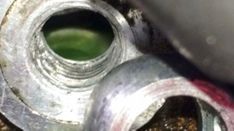

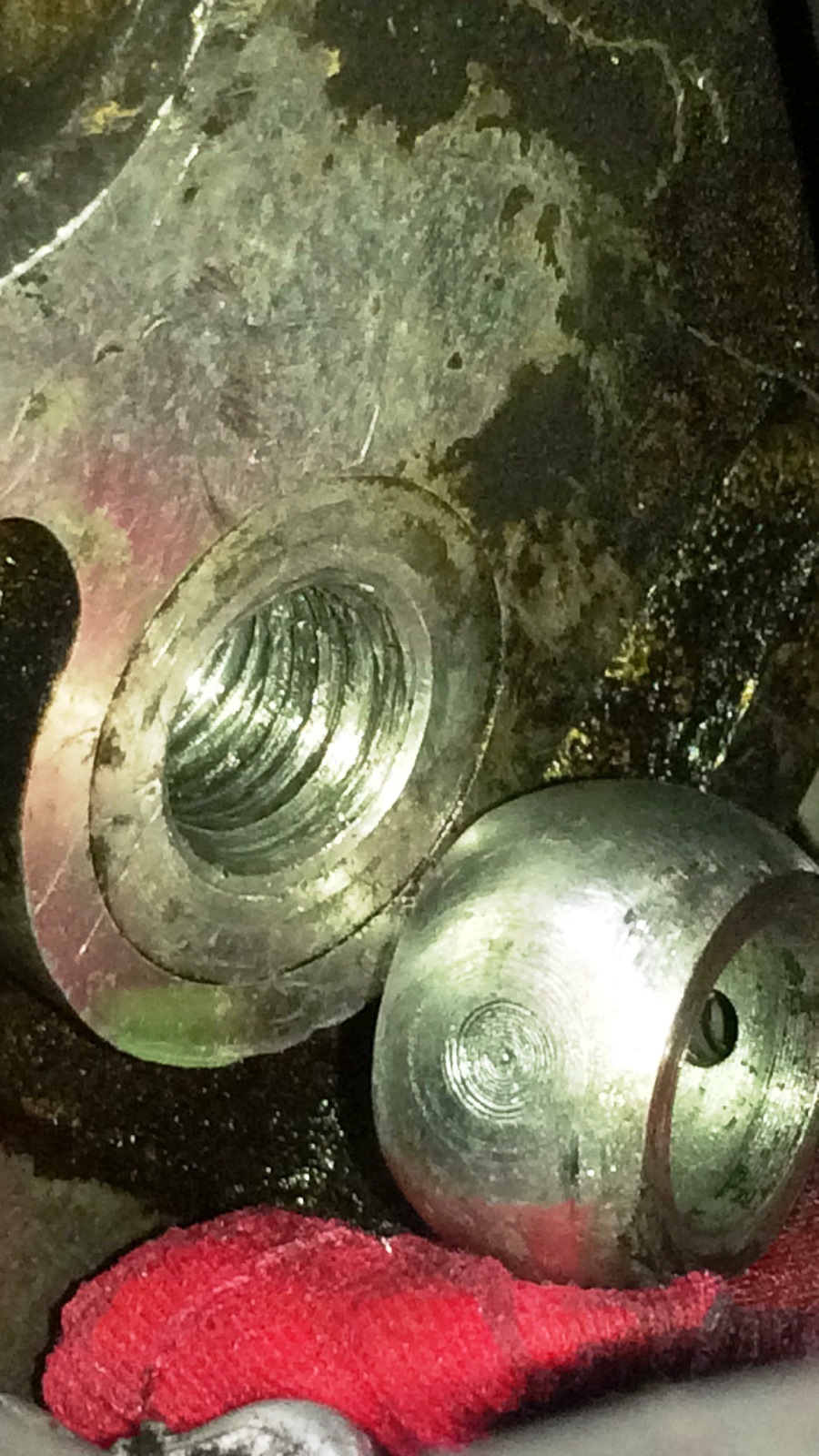

I have verified that there are no existing copper washers in place. I was able to get a closer photo of the port in the block. Appears the threading on the left side is damaged, but the bolt still screws on fine not as if it was cross threaded.
