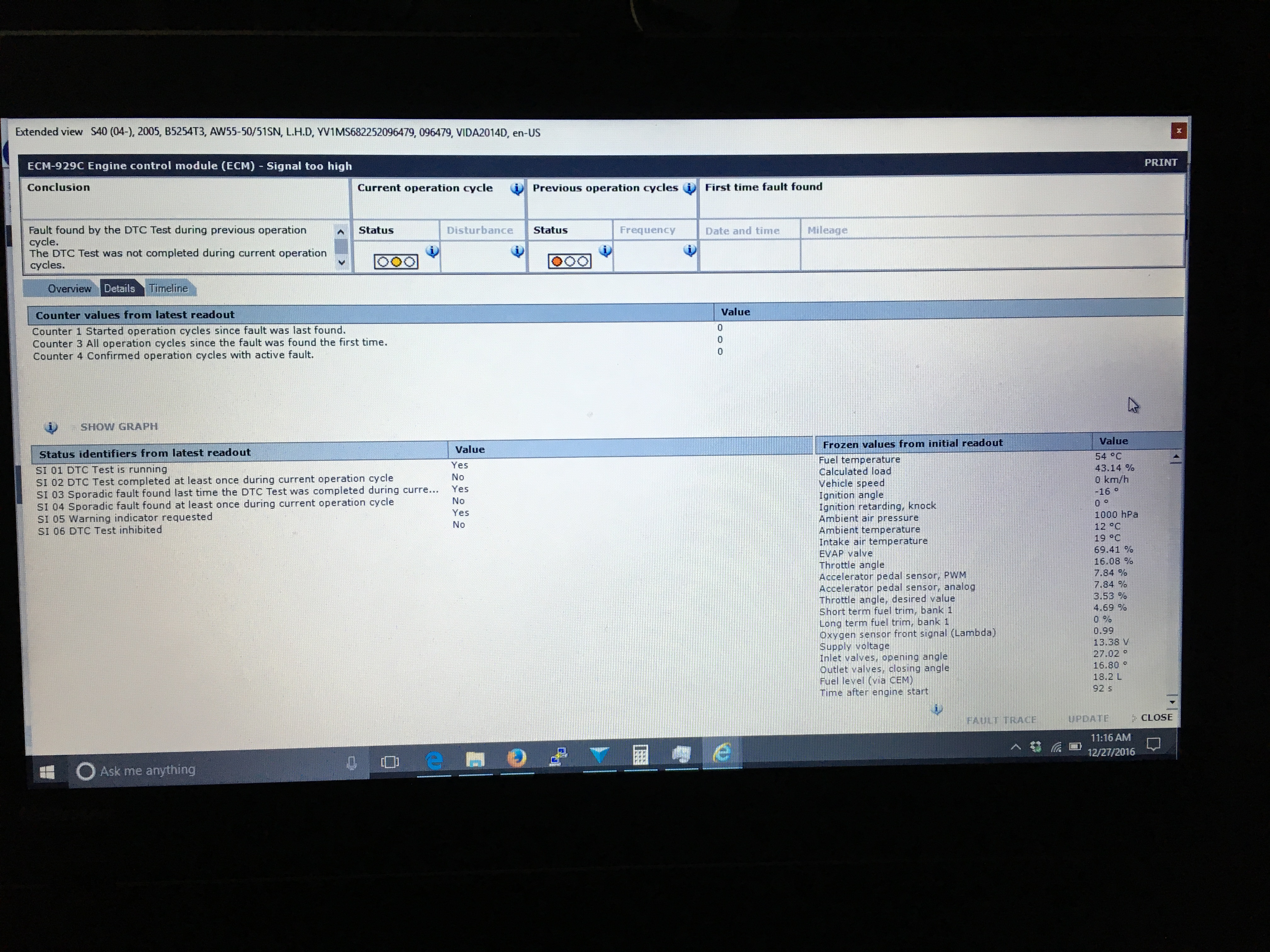

I have taken some pictures from VIDA showing some error codes that are currently in the ECM.
The graph I have uploaded is with the car off, all of the sensors seem to follow each other pretty well but I'm not sure what a "good" ETM feedback looks like. I also have some freeze frame data where expected throttle position is one value, throttle position is another, and nominal throttle is yet another. Not sure if that is expected behavior or if that's why the code was thrown.

OK, I've been playing around with the car some more. Interesting tidbit is that each time I get a freeze frame for ECM-9270 the "throttle angle" is always 17.25% where the Nominal throttle angle and desired throttle angle are both different values that are independent of each other as well.
This is 3.77 volts on the Potentiometer 2 and 1.24 volts on potentiometer 1 if memory serves right.
I'm not sure what the significance of this number is.
I'm going to try and find where I can measure the supply voltage for the PWM control of the throttle. While the engine is off right now it doesn't go through its normal check when you turn the key to "2". It did throw a code, without turning the engine on. It was the one for adaptation not working, 9240 I think. Freeze data showed throttle angle at 17.25% where desired was down at like 8%. Again that 17.25 number...
