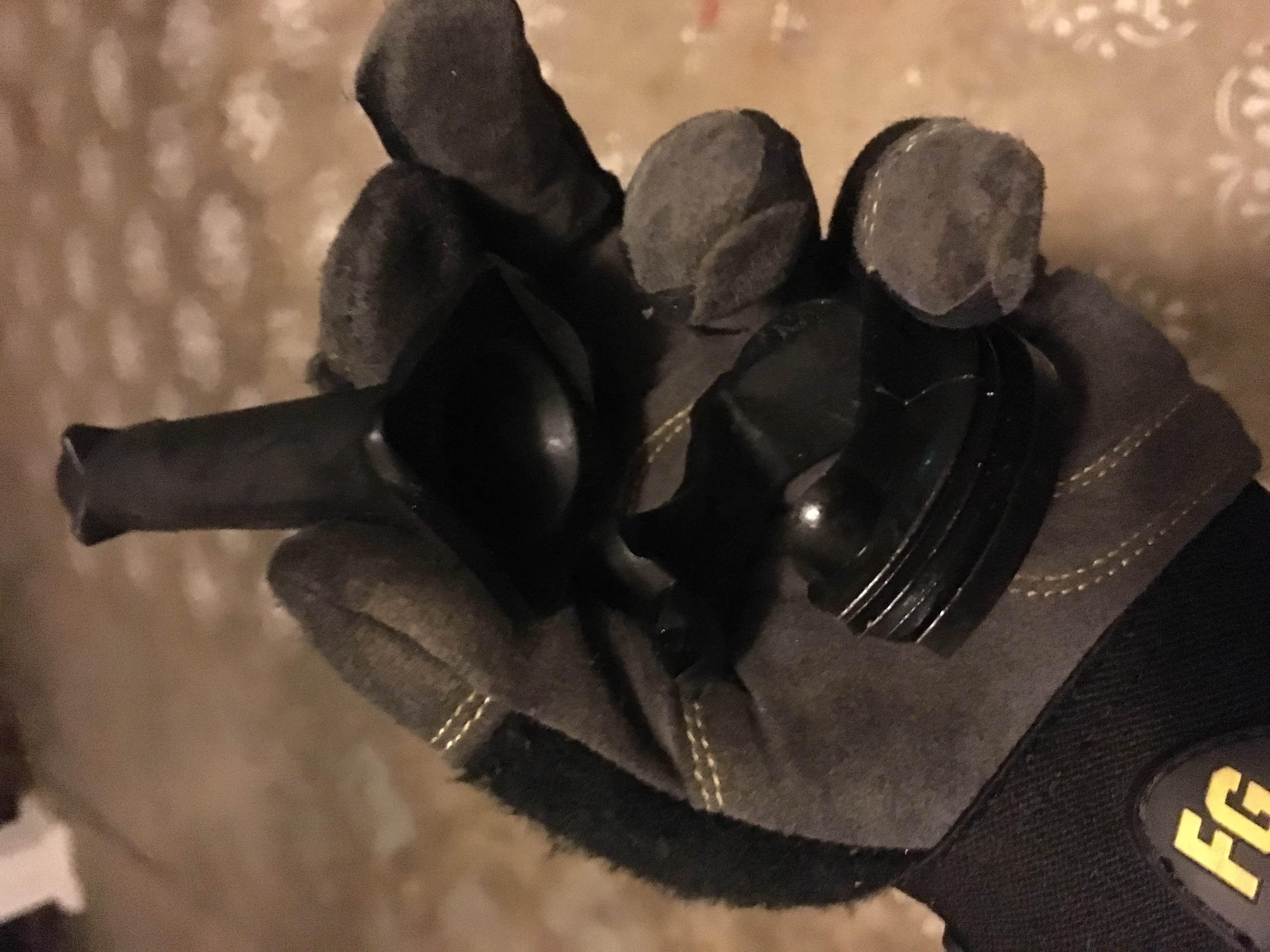

Not a biggie. Pick n pull or cheap replacement. You can even tape it up.
O Reilly's. Rock auto Advance will carry them

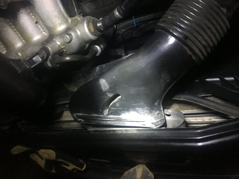

Got them! One plug is still stuck -letting it sit again tonight with PB on it. Just noticed this hose is disconnected! Can't be good... no idea how long it's been disconnected!

Don't sweat the loose hose..that's fresh air to the air cleaner. Just try to stick it back into the plenum on the radiator but it's not too important.
Can't wait to see a picture of those plugs, bet they are ugly. You want Bosch our NGK single electrode plugs in that turbo by the way, not the three electrode ones everyone tries to sell
