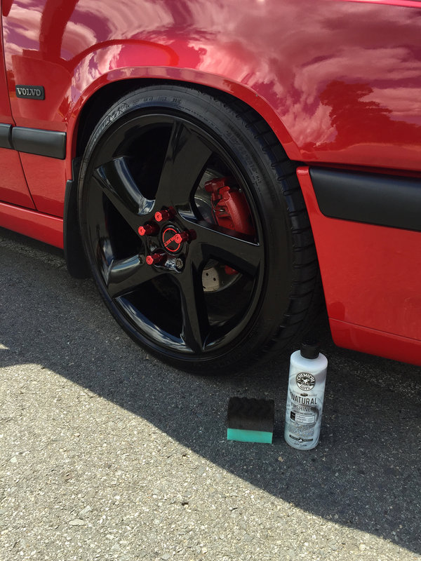

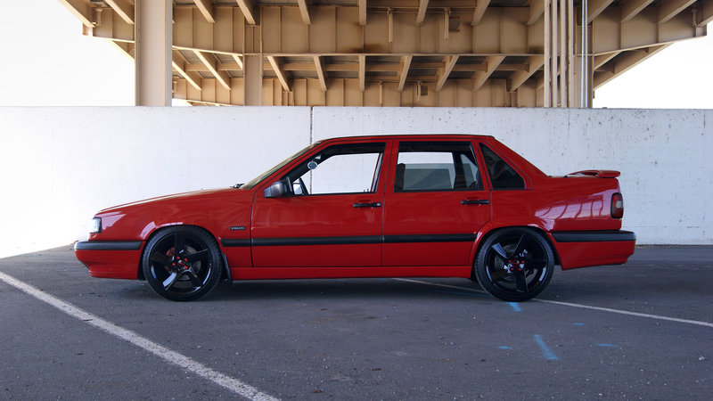

I've searched so many threads trying to find people that have had experience with different suspension setups. My 850 is currently on D2 Racing Coilovers, and the ride is so stiff I'm seriously considering going back to traditional shocks and struts. I love the handling and looks, but on certain roads, it seriously feels like it's shaking my car apart. I'm not sure which setup would suit me best though. I absolutely love a low car that takes corners like it's on rails, but at the same time it needs to be able to soak up some bumps when needed. I'm considering (in order) Koni Sport Yellows, Koni FSD, and Billstein HD's with the car sitting on IPD's lowering springs (I'll cut them if they sit too high because I like my current ride height). I've already put on IPD sway bars, strut brace, polyurethane subframe inserts, and 18x8 wheels with 215/40/18 Michelin Pilot Sports. What do you think would be the best suspension/spring combo to daily and take across the country on road trips? Any advice/experience would be greatly appreciated!

Ride looks nice. I really like Bilstein HD's.

Just came here to say
Nice ride!
