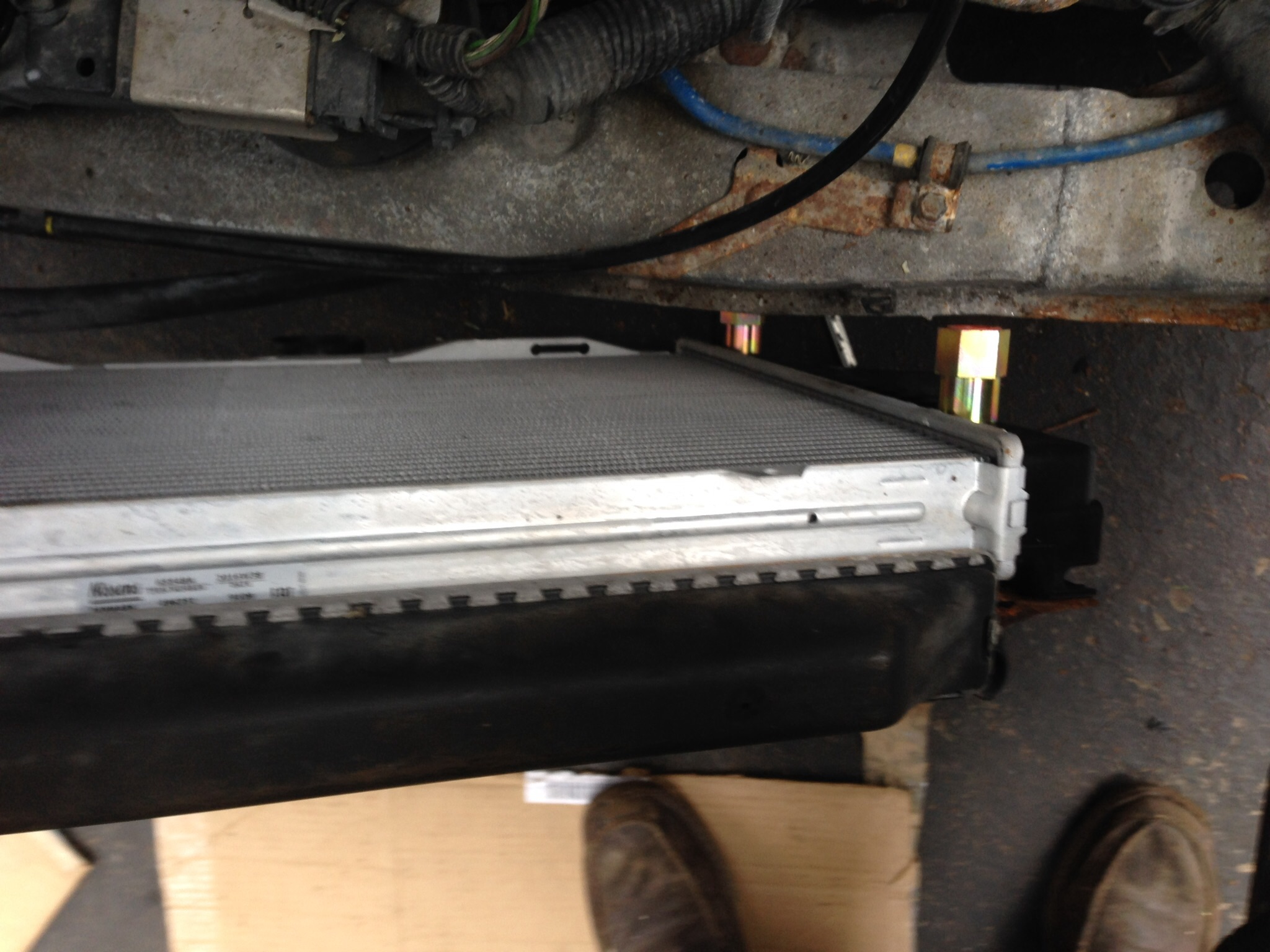

Tricks to this job. I'll write up more on plane
There is a metal sand which of 5 pieces...AC condenser, intercooler, radiator, and two metal plates which position the intercooler. They are different and go in one way.
The VIDA procedure is to evacuate the AC and bench assemble the sandwich. It's possible to skip this and do it on the car.
On my T5, removing the fan and shroud means releasing the two upper screws on the fan, loosening the lowers, the slipping the fan up and out. The fan shroud unbolted but you need to remove battery and tray to move it left and out to clear the ETB.
With the fan and shroud out, you are ready to deal with sandwich.
The condenser will come down on the driver side, and stay up on the pass side , so you have to reassemble the five pieces cocked at an angle working under the car. I pinned the top corner, pass side with a zip tie, leaving off the plate at first , this made it easy to get the bottom driver side 10mm bolt nut washer in. Once you have one bolt in loosely, the sandwich is much easier to manipulate and get bolts in. I replaced the clip,nuts with SS M6 hardware from Lowes. I loaded the washer with a pick, and held the nut inside with needle nose pliers..access is tight. I'll document the length, you don't want the M6 too long or you will crack the radiator!
The bottoms are easy to access, the tops are a bit harder.
I replaced the captive M8 radiator bolts, notorious for freezing up, with SS M6 and heavy washers. You could probably triple zip tie these.j

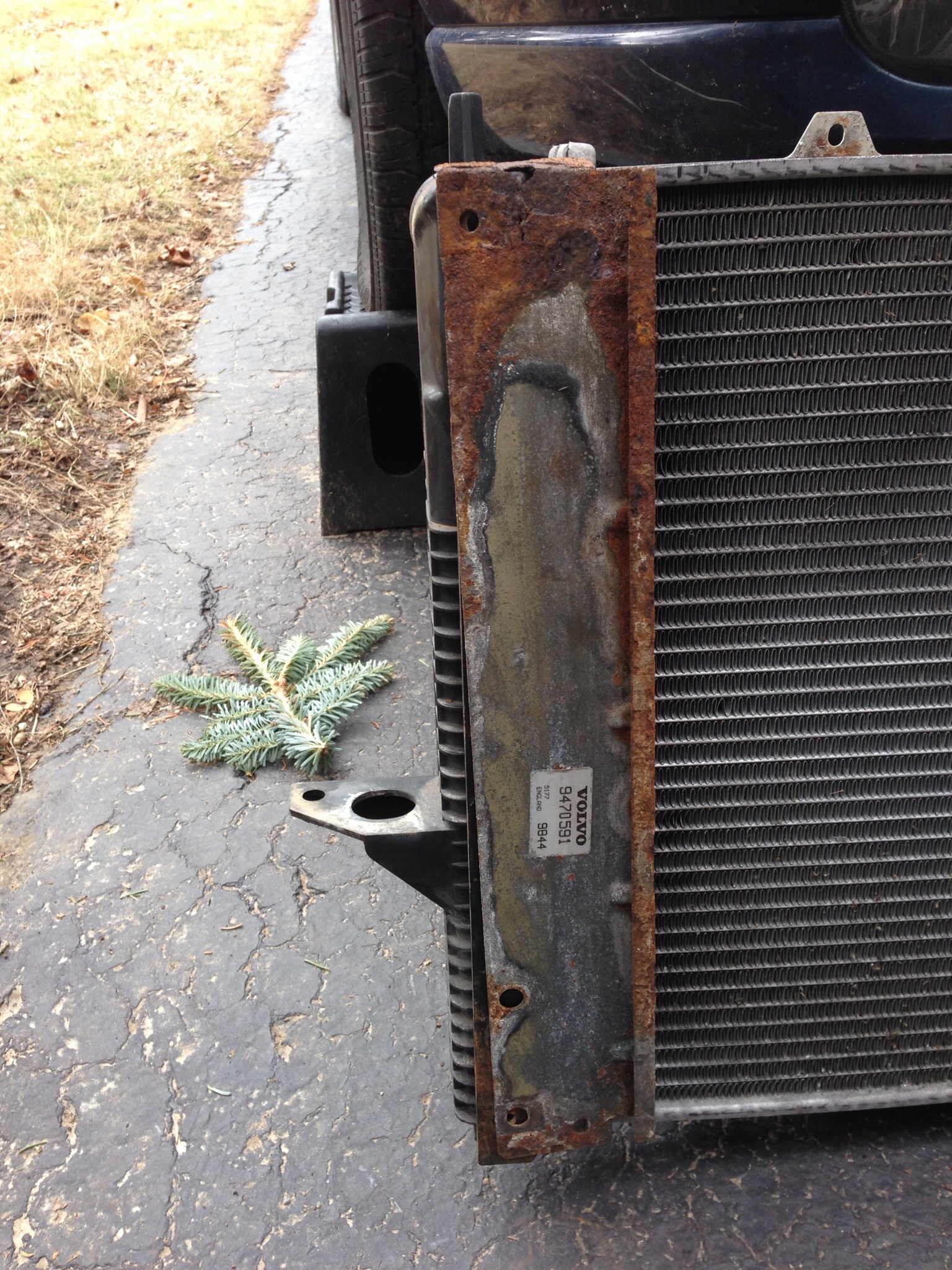

Thanks for posting this stuff, Steve. I love when folks give bolt/screw/washer options! All that rust... Wow...

:D You have to accept your muckups with grace. I can't believe how fast I could whip this apart and remake the sandwich the third time! Hardest part is lifting the complete sandwich from underneath to get the two M6 bolt-nut combos started. You probably should block this up into place. I dropped the long M6 bolts down, lifted the radiator ears up through the bolts, then applied side pressure to the rad to freeze the bolts so I could start the washers and nut. That's juggling pieces with one hand.... quite a talent... :D

I know techs that swear by using Nylock nuts on the bolts holding rad/cond/intercooler together but leaving them a bit loose so the rad can expand/contract w/o stressing tanks. This is primarily P2 but some say the same for P80. This same feeling is becoming popular on other models and brands too. I have done the same for a couple of years but the results won't be known for a while with the passage of enough time to see if the replacement aftermarket rad goes the same or longer as the OE one.

I use a floor jack and a piece of wood to balance the 'sandwich' and it makes re-assembling the whole thing a lot easier. With a bit of persuasion and loosening the intake pipe from the intercooler at the ETM, I am able to persuade the whole fan assembly to come out in one piece without needing to remove the battery or the tray.

This “ early failure “ was self induced. My SS bolts on the passenger side mount got loose and left my radiator bouncing on one mount which surely stressed the side tanks and caused the leak.
User fail.
