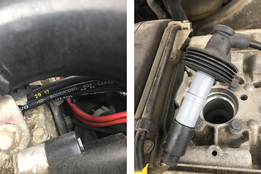

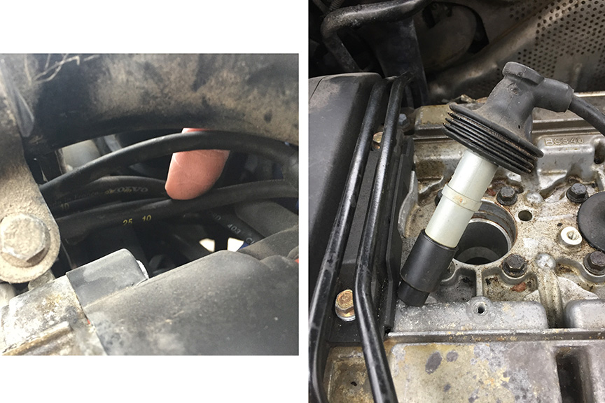

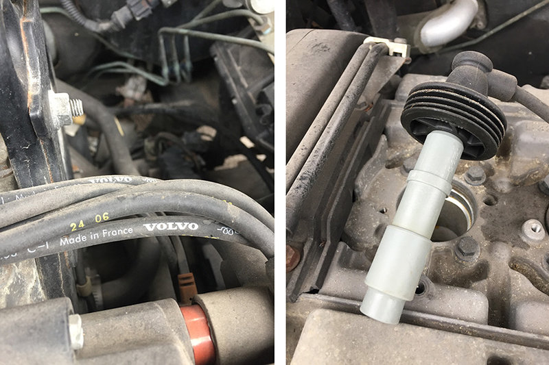

OK so I guess Bougicord changed the date code, and for at least 10 years it has been week-year. So OP Robert was right. But the old way was year-week, my guess they changed it in 2000? I didn't shoot any pics of the old wires, short lunch break, wish I had now ...
2006 date code
2006 date code
2010 date code
2010 date code
2012 date code
2012 date code

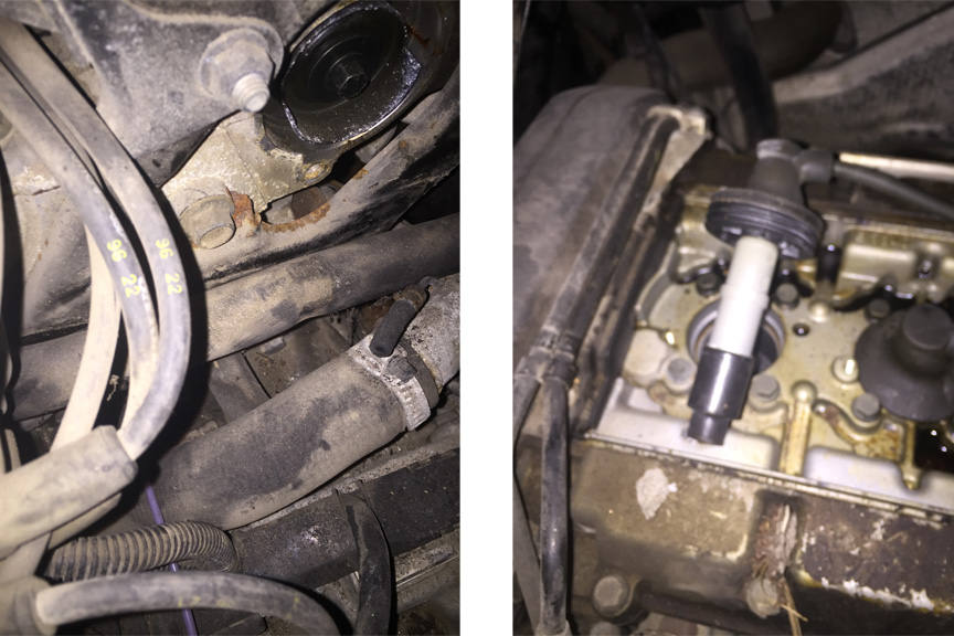

Just to complete the story, here's a pic showing how the cars came from the factory, with reversed date pattern year/week:
1996 date code - pattern is reversed
96 22.jpg (191.7 KiB) Viewed 1459 times
Does anyone know when Bougicord changed the date pattern?

I believe I have seen wires dated 42 02. I do recall seeing the original wires with 93 xx dates.
