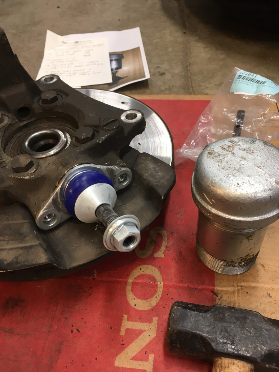

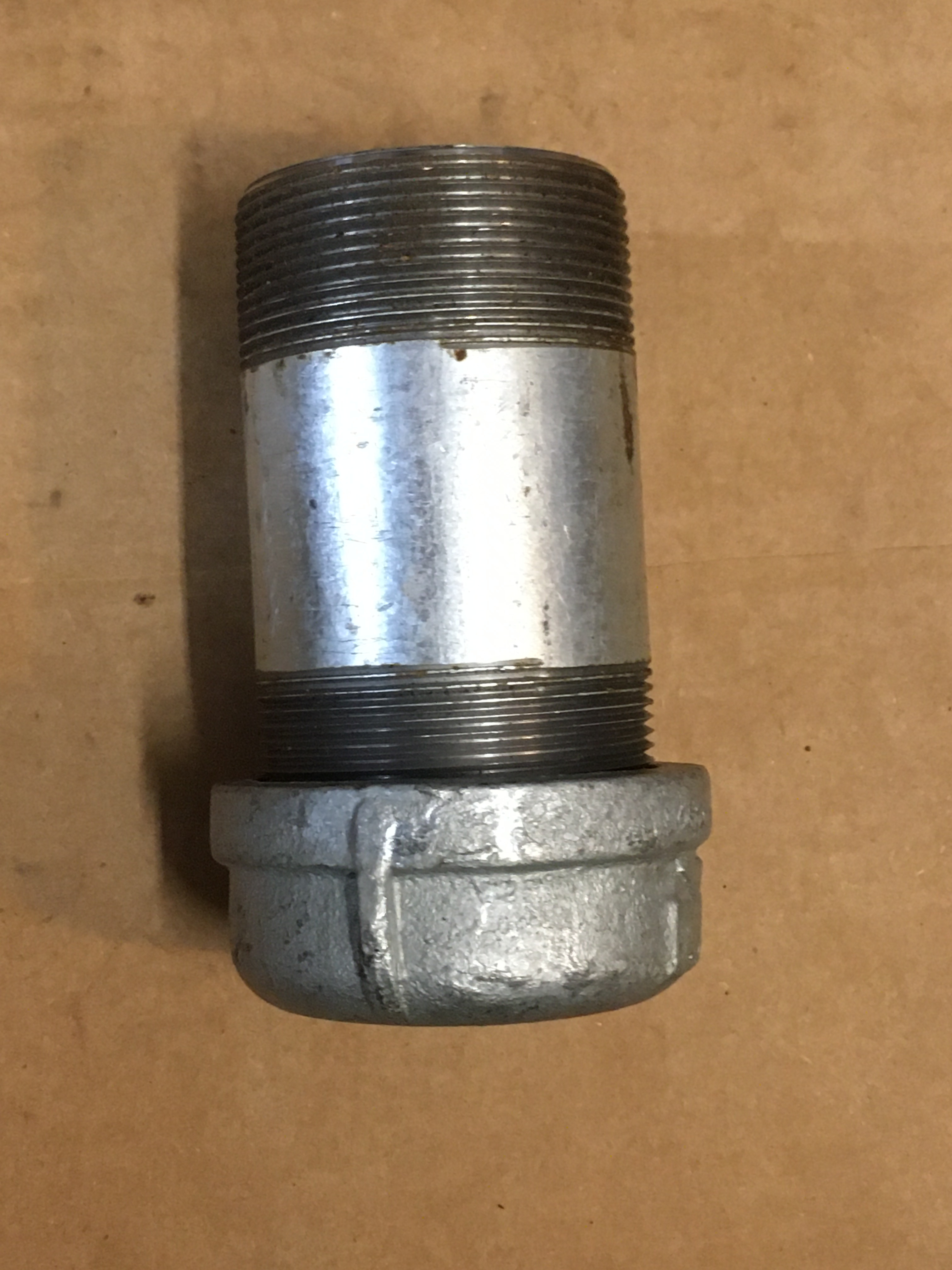

I used a short length of galvanized steel pipe that fits around the ball joint boot, plus a screw-on cap to pound on. It worked quite well, you just need to go gradually and keep things straight. The pipe end got pretty beat up, not sure how plastic could hold up to that.
I put the ball joint in the freezer overnight, and it tapped right in (with some effort).
