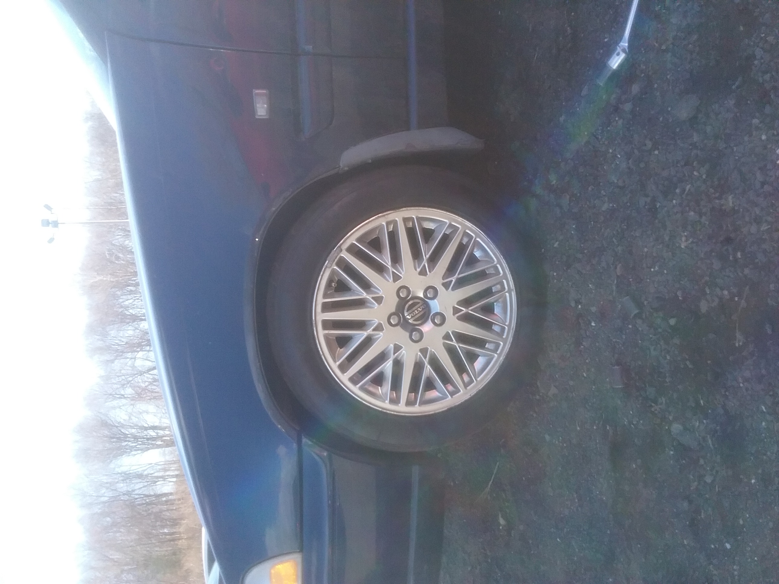

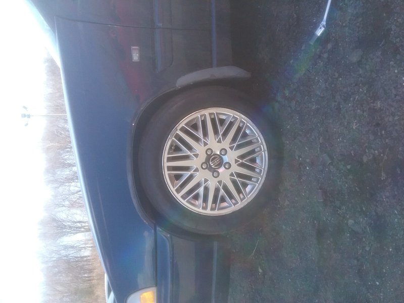

I went ahead and mounted one of the 215/55/17 tires and put it on the car to check it out myself...Didn't rub or anything...If these were new tires with new tread I would of had rubbing on the strut/bottom spring support however since they are worn they fit fine..Haven't driven it yet but here is a picture

They will bend your fenders in real world when shock apsorber will need to do it's job....to compress.
That setup would be fine with custom controlled shock movement.
Good luck.
