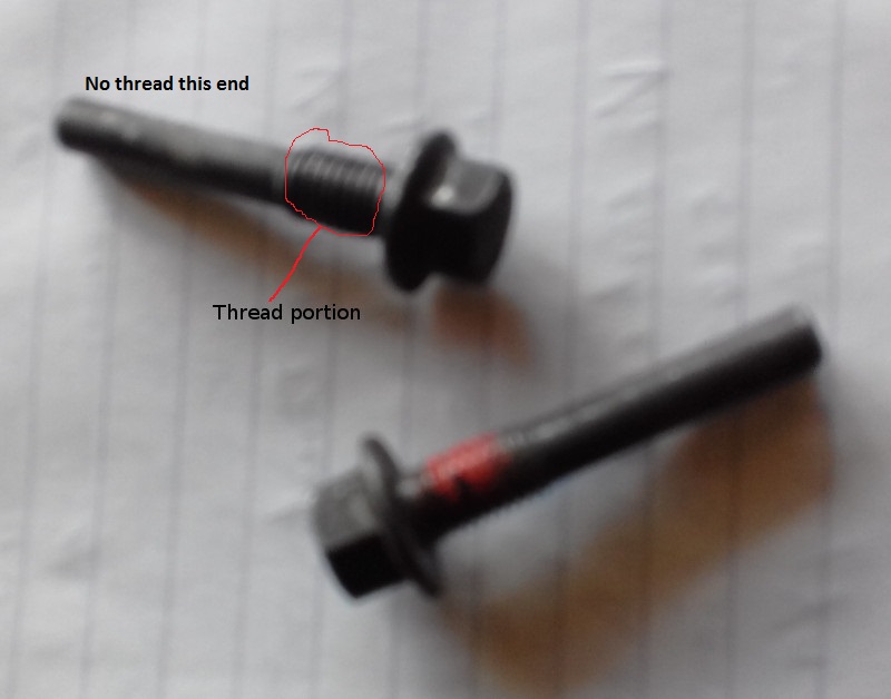

After replacing the camshaft seals, upper cylinder block to lower cylinder block seal, timing belt, water pump, tensioner wheel and idler wheel I am left with two unusual bolts.
They are M7 hex heads 43 mm long. There is 10mm of thread at the head end of the bolt and the rest is a slightly tapered shaft. They have obviously been used somewhere as they have old thread lock on them. I have looked at dozens of images on Google and searched over the engine sever times looking for two matching holes. The only item I have yet to reinstall is the auxiliary belt tensioner, but I have those bolts.
I have included a photo. Hope someone can recognise these bolts and tell me where they belong.
P80 lower timing belt cover bolts 974674

Some of the components you replaced come with bolts, maybe you have these old ones as spares now?

The only replacement part that came with new bolts was the water pump. They are different bolts and shorter. I did place all other bolts and parts in containers that were labelled. Also I took photos on my camera but somehow these two bolts slipped through.abscate wrote:Some of the components you replaced come with bolts, maybe you have these old ones as spares now?

I'll confess I've made the same mistake a few times. Give people a few days, I'm sure someone will recognize them, they are quite distinctive.johnhb wrote:The only replacement part that came with new bolts was the water pump. They are different bolts and shorter. I did place all other bolts and parts in containers that were labelled. Also I took photos on my camera but somehow these two bolts slipped through.abscate wrote:Some of the components you replaced come with bolts, maybe you have these old ones as spares now?

Reminds me of brake sliders...

I agree that these look like Brake Slider Bolts, but the 850, V70 series does not use this type of bolt.
These look like a Volvo S40 slide bolts, or the Mazda Miata type.

Those bolts look vaguely familiar..... By any chance, do you still need to install the belt guard that goes around the bottom of the crankshaft pulley? It seems to me that those bolts are similar. IIRC the long nose helps get things lined up and the threads started. (Although I still found it a kinda hard...)

Bingo!MrPc wrote:Those bolts look vaguely familiar..... By any chance, do you still need to install the belt guard that goes around the bottom of the crankshaft pulley? It seems to me that those bolts are similar. IIRC the long nose helps get things lined up and the threads started. (Although I still found it a kinda hard...)
