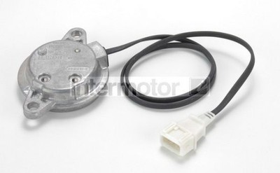

Pic from the web. Looks like it is the wires that connect to the Crank Sensor.

I think you are taking about the cam sensor, the part with the big red arrow in https://data.motor-talk.de/data/galleri ... 865679.jpg.
I would indeed splice a new connector into the wiring harness. Maybe even a junkyard one but if you can get a new one, great. Your parts geek link doesn't work.

Either the crank sensor or cam sensor heavy wire has to be away from ignition wires when they are to close, the signal gets corrupted. That's why they are shielded. I've seen many no-start or no-run issues due to that wire about touching one of the ignition wires. Just a thought, but I agree- replace the connector, don't just splice and tape. Still, even with the pictures available, I'm at a loss to understand the exact wire. Any better pictures of the bad connector and wires protruding from each side?

On second look of the original picture you posted, I'm thinking it is the cam sensor. I have had to "repair" the connectors (epoxy was my friend!) on these before- they get yellow (and even turn orange) and brittle. Some were made with a black connector rather than white which seemed to hold up better. This is unless the female connector- the one in the car is the one disintegrating- which if it is, this is very rare. When the sensor gets disconnected, there is typically no code set either- the car just doesn't run. The connector plug on the end of the somewhat flat wire is integrated with the wires so there is no just switching the connector out- I do suppose you could cut a decent connector off of another cam sensor but if you're going to do that, why not just switch the whole thing out- it would probably take less time. I do not recommend by-passing the connector completely. This is because some day you will probably have to switch the cam sensor and then you'll have to go through unraveling everything and cutting an end off and splicing again. Do be aware that some cam sensors differ from model to model, so make sure you get the right one. I'm posting a picture of what I think you are describing.

Oh, if its the sensor end of the wire then there should be no question - just follow it to the sensor, is it cam or crank. If the sensor end of the wire is bad I agree with crlande: replace the sensor, don't mess with the wire. If budget is an issue then grab one from the junkyard, 99.9% of them are just fine.
Splicing in connectors is all I need, and I can do that myself for cheap. Having the entire sensor replaced still involves replacing the connector on the other side of the connection, and is not going to be affordable, so splicing on connectors, is the way I will go. Thanks to all, for input. Much appreciated.

Try the splice but be ready to replace it. It's a shielded connector in the presence of lots of high voltage electrical noise so it might not work well with untwisted pair wiring
