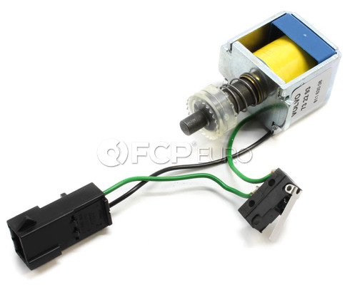

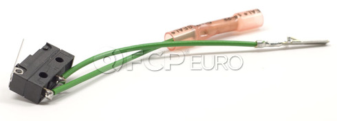

Two things that I would really give a good looking to under the shifter selector are the
Volvo Auto Trans Shifter Assembly - Genuine Volvo 9466031
https://www.eeuroparts.com/Parts/51297/ ... DQody0gPsg
the Volvo Shift Interlock Solenoid (S70 C70 V70 850) Genuine Volvo - 9466049
https://www.fcpeuro.com/products/volvo- ... vo-9466049
and the Volvo Gear Selector Switch (850 S70 C70 V70) Genuine Volvo 9466028
https://www.fcpeuro.com/products/volvo- ... 70-9466028
Maybe there's something loose around there, something getting stuck, something shorting, or something broken in there....
Sounds like you're getting closer to solving this issue! I can't wait to hear that your car is good as new!
