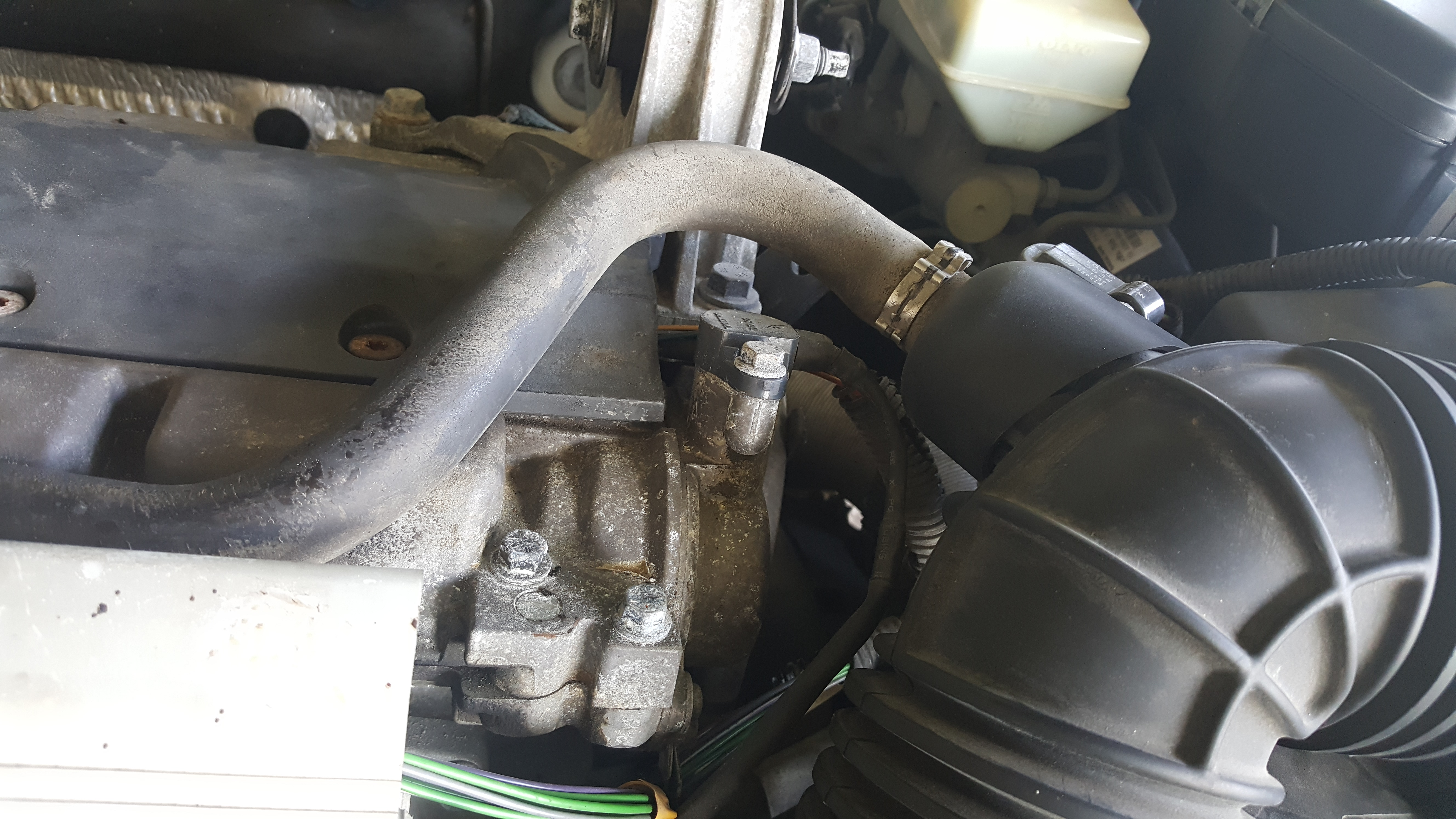

I appreciate it. I was confused because I kept hearing that these models didn't have an aic. Do you know if I can attempt to clean it with MAF or throttle body cleaner before replacing it?

If you have ETS, electronic throttle System, you don't have an IAC.
Is there an ETS light on your dash when you turn the key on, without starting ?

Yes Ive removed the etm to clean it the other day. I googled the sensor on the intake hose which led me to the iac. The iac connects to the intake hose with iac hose connecting to the intake manifold. I ordered the hose yesterday. I will attempt to clean the valve once I have the replacement. The one currently installed is very old. Thanks for the input. I will give an update once i pull off the valve and sensor.

I don't think that is an IAC. Once you electronically control the throttle,there is no reason for IAC.
Ill look at my 1999 NA parts car and see if I can learn what this is.
Perplexed....
Perplexed....

http://www.volvopartswebstore.com/showA ... tring=idle air control
I pick n' pulled one of these a couple weeks ago for a friend w/ a 99 N/A.

http://parts.volvocarsofhuntington.com/ ... 70245.html
I finally found the hose that connects for anyone that's had problems.
