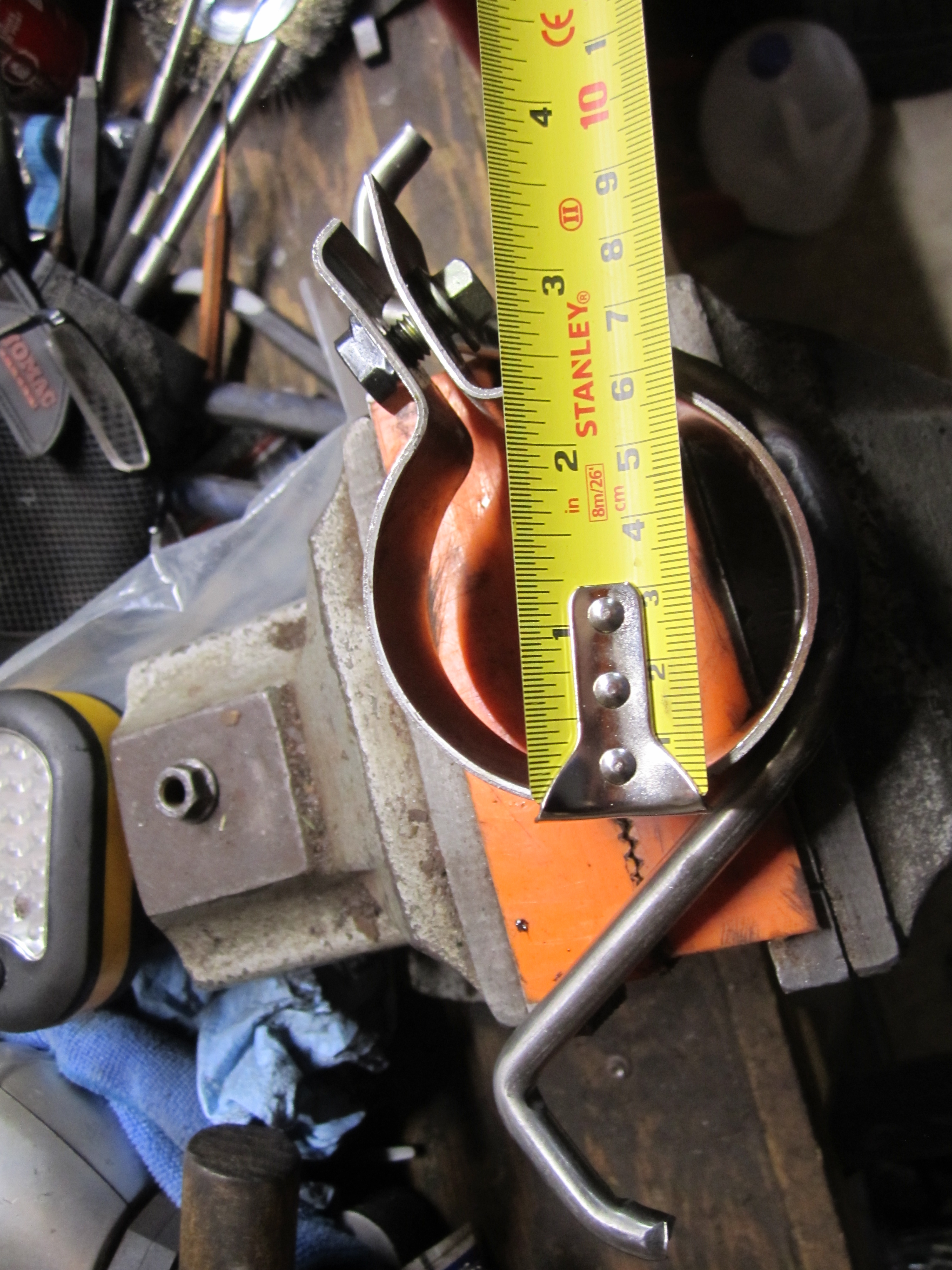

Went to fit the hose to find the end at the carbon filter would not fit with the smaller oetiker clamp as it was too small. No problem , get the 'R' one instead. Then I remembered I used all my spare clamps on the last 850 project for the PCV system that had no clamps on it!
Phoned the dealer and surprisingly they had it in stock. Next morning headed off in a snow blizzard to 20km to the dealer. Get there and find they are offering a screw type clamp. That would be fine, but the end at the carbon filter is countersunk preventing getting anything on it to tighten it up! Bugger again!
I go back home depressed!!
I find a clamp and have to remove the carbon filter from under the car again to see if/how I can get something onto the pipe to hold it on. Eureka! There is a small slot in the carbon filter casing at the top side, and with careful positioning and a long flat bladed screw driver I was able to get the clamp on and tightened!! Yay!!
Note it can't be seen easily be seen but the slot is in-line with the screw head at the top of the filter! what looks like a slot on the bottom is in the filter bracket and not the carbon can itself.
