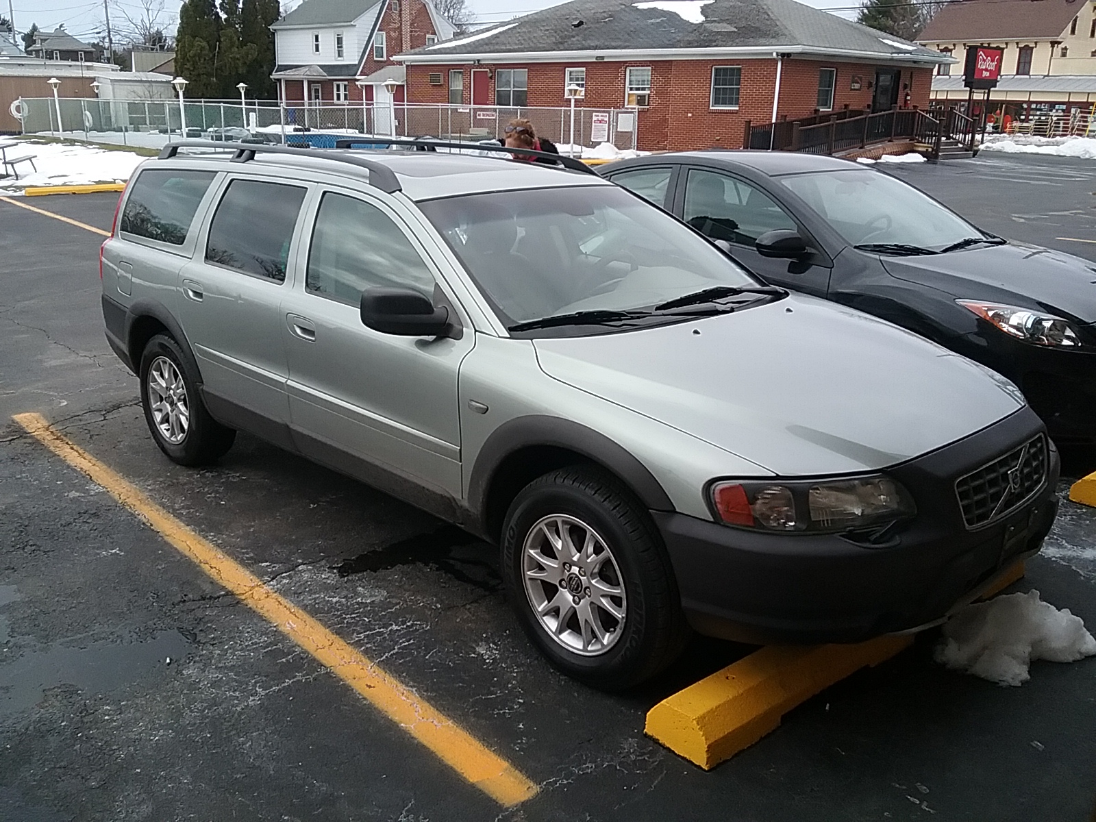

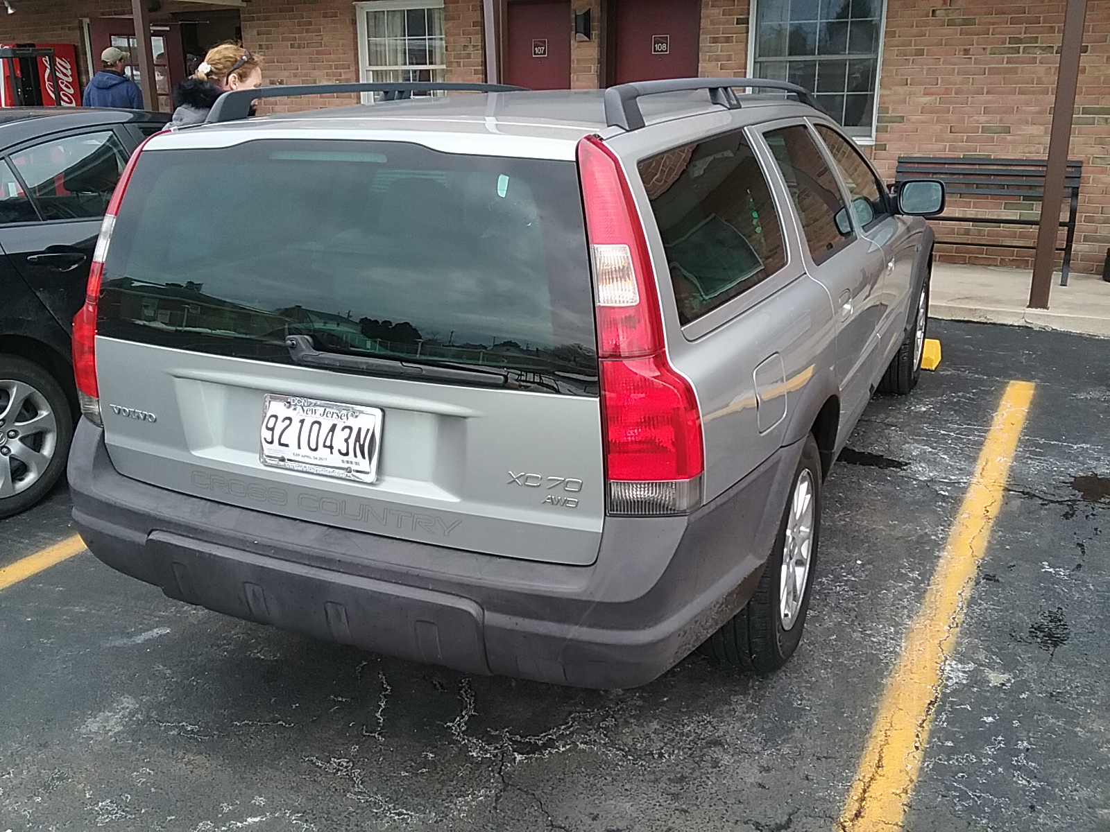

Figured I should add a few photos... She is a high mileage girl, about 227k, but really in good shape. Dealer was looking for offers, window sticker was $6,500. LOL, I offered $1,300 and they took it as their lot was jammed with used cars...

Closed the deal at 20% of the price anchor - I might have some products you could sell for me...
