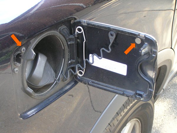

I put wide cable tie with hole around the spring and short screw with big head. Just push screw a little bit
more in plastic and done.

This is exactly what I did to solve the problem and it works better then the original set up imo. Very satisfying action, clean and tidy to boot.mnsherk wrote: 24 Apr 2012, 19:50 Buy a small rare earth magnet and apply it to the inside of the fuel door so it will be opposite the head of the upper left screw when the fuel door is closed (see pic). This works like a charm (I have not had my door flapping in the breeze since I did this) and has minimal cost.
