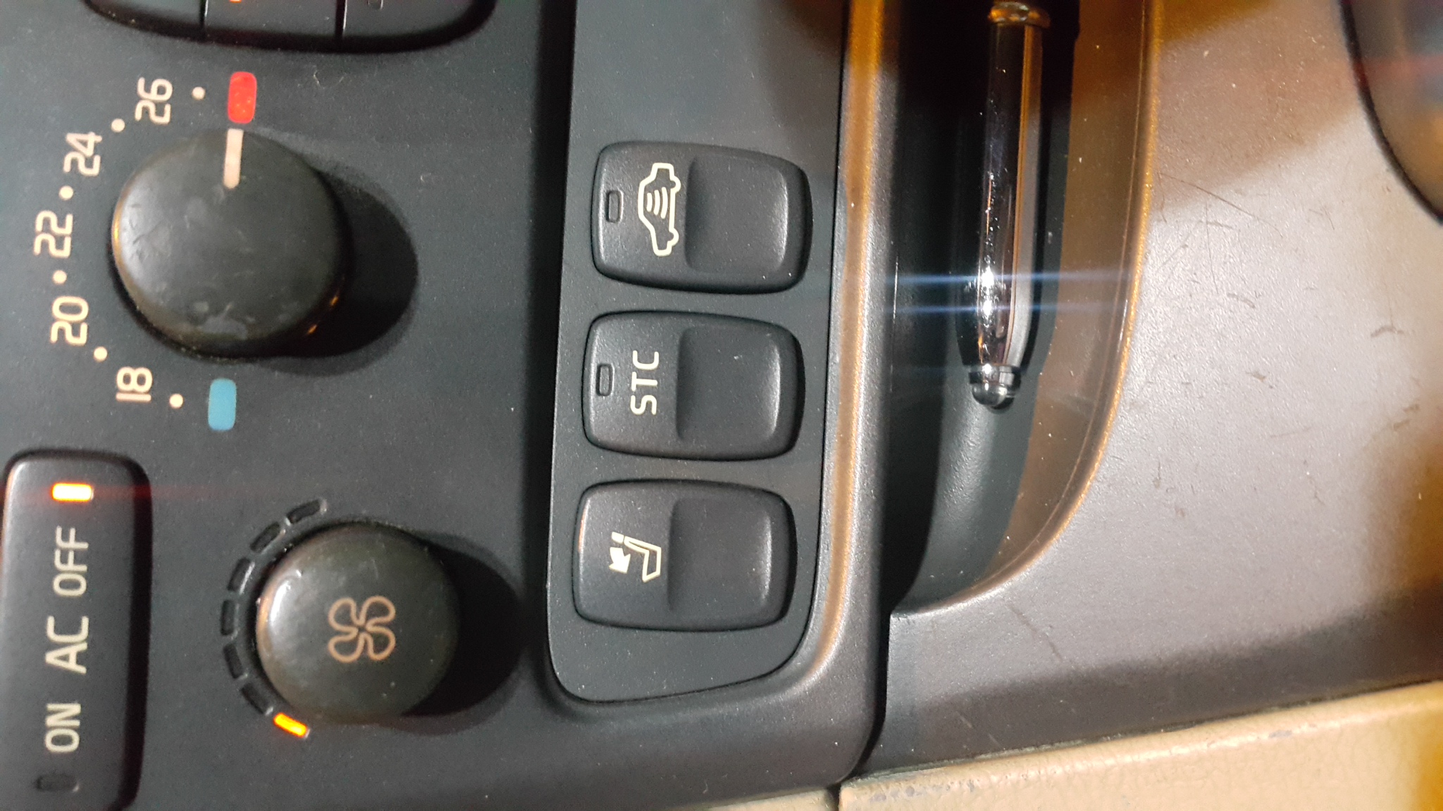

Other issue is the STC button light. It is generally no light on the button. Sometimes it is on when I start the car, but generally off. When it is off, Stc is functioning, ABS is functioning. Few days ago I removed each button and the background light is ok, but the small led on button not functioning. While STC button light not functioning, the other 2 buttons do work properly.
Any idea what consumption is so high and how to fix Stc issue?
