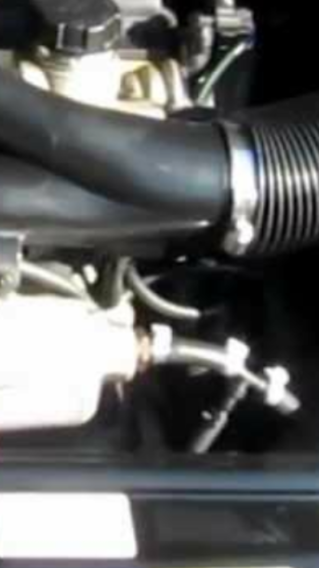

Blue goes into the intake right after the flex from the filter box.
The purge solenoid is located on the fan shroud driver side.
1999 S80 T6 engine stalling, rough idle, power loss
Huge thanks to you Legofan! You pointed me in the right direction! My hoses were crossed, I had my blue line tcv hose connected to the lower intercooler hose rather than the air intake. I let it idle for half hour and then drove it around for another half hour and it seems to be okay, no more stalling, plenty of power now, only issue i'm still seeing is the engine rpm's are still a "little" rough especially at idle and I can still feel some slight engine surging when driving on the freeway, but not as bad as before...
