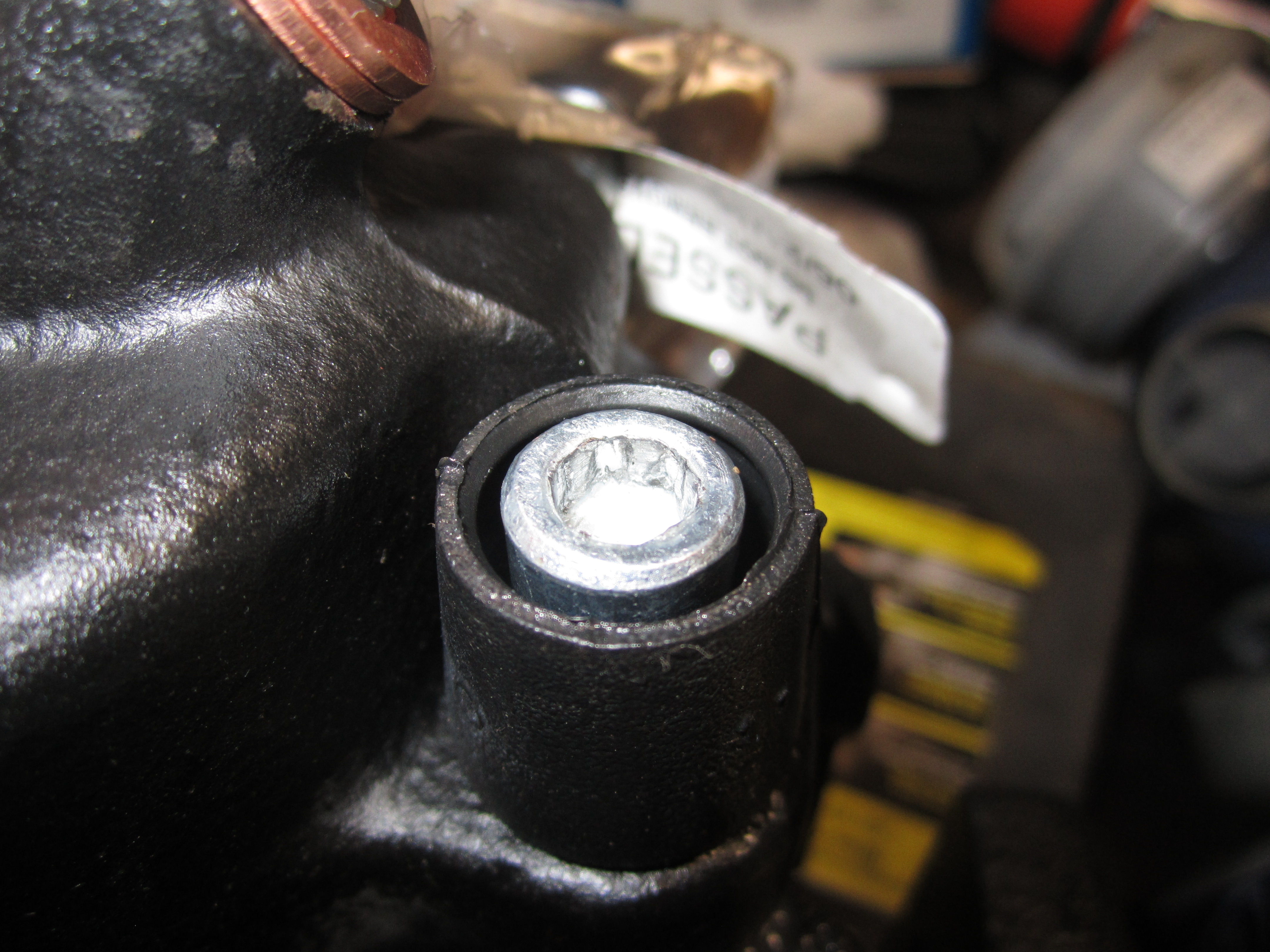

Well all I can say is it is the worst piece of junk I have seen sold as a re-manufactured brake caliper. The piston is a rusty old piston that has been crudely buffed on the top and the interior of the piston is full of deep rust. They have used the cheapest of slider pins to hold the bracket to the caliper. They have been driven in so hard that they have rounded the internal hex heads. I'm guessing it was maybe a 1/4" rather than a 6 or 7mm hex as neither of the metric ones fitted. The 7mm was too large and the 6mm just turned. I tried jamming a 1/4" Allen key in to the pin but could not get it to loosen no matter how hard I tried and it felt like it was about to round. Finally they have painted it in a fashion with a cheap black paint which has come off in many places or has been scraped off in manufacture.

Might be picture but that looks like a pot metal caliper slide screw - seriously??
- Posts: 15493
- Has thanked: 2202 times
No it is not the picture! That is just what it looks like a cheap piece of useless crap! Now off to return it and pick up a Nu-geon unit from Napa.
