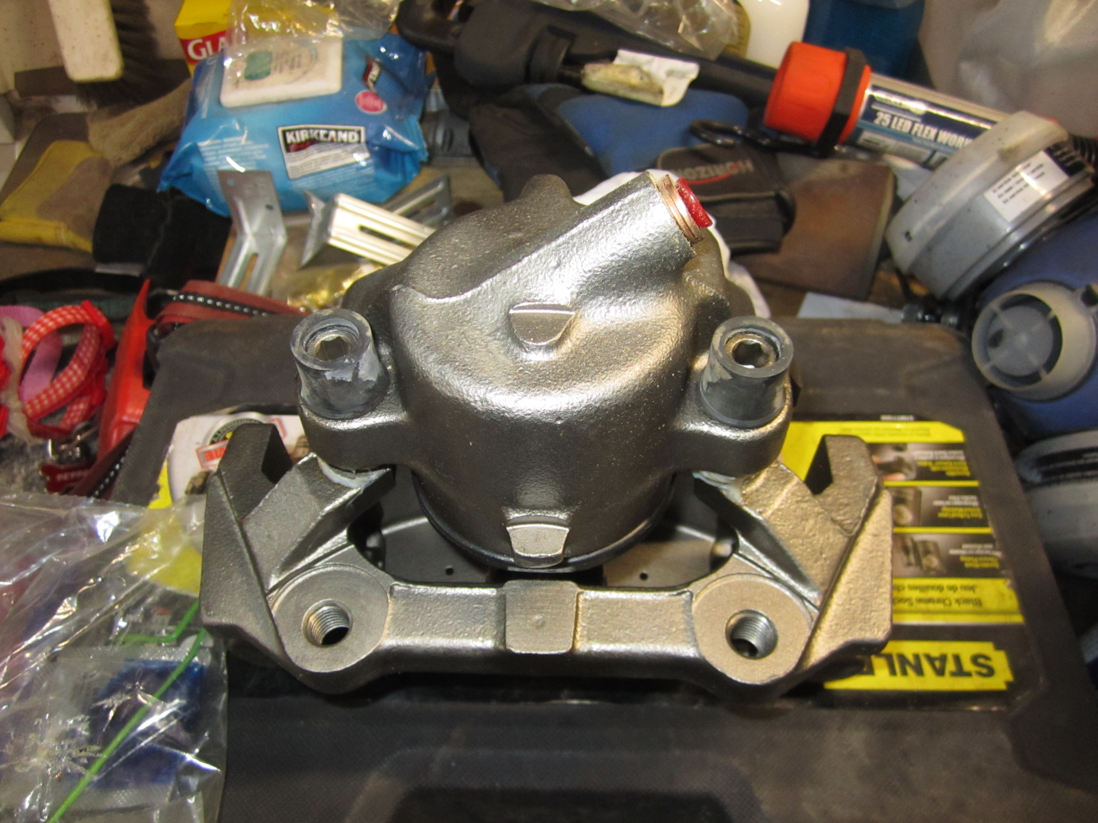

I buy my calipers normally from a local parts supplier called Auto Value in Calgary. They are a chain in Calgary and area and not sure if they are national. Anyway, they only offered me one option which was their 'house-brand' called Perfect Stop - Exact fit. Cost was $90 CDN (about $65 US). Comes in a nice box and proudly states re-manufactured in the US. Surely had to be ok as made in the US?
Well all I can say is it is the worst piece of junk I have seen sold as a re-manufactured brake caliper. The piston is a rusty old piston that has been crudely buffed on the top and the interior of the piston is full of deep rust. They have used the cheapest of slider pins to hold the bracket to the caliper. They have been driven in so hard that they have rounded the internal hex heads. I'm guessing it was maybe a 1/4" rather than a 6 or 7mm hex as neither of the metric ones fitted. The 7mm was too large and the 6mm just turned. I tried jamming a 1/4" Allen key in to the pin but could not get it to loosen no matter how hard I tried and it felt like it was about to round. Finally they have painted it in a fashion with a cheap black paint which has come off in many places or has been scraped off in manufacture.
Bottom line, do not buy this junk! I now have a Nu-geon unit on order with Napa for tomorrow morning. It will be about $5-6 more but it has a rust prevention coating, and if it is as good as the 2 on the rear of my 'R' then the were well finished with new pistons. I guess I will find out tomorrow!

Problem is the piston is rusted due to the seal dust seal being 50% out of it's seating. So piston will need replaced too. I had considered this initially.

Might be picture but that looks like a pot metal caliper slide screw - seriously??
- Posts: 15487
- Has thanked: 2199 times
No it is not the picture! That is just what it looks like a cheap piece of useless crap! Now off to return it and pick up a Nu-geon unit from Napa.

Ah, that is much better! Returned the piece of crap, and went to Napa to collect the Nu-geon remanufactured unit. Took it out of the box at Napa to confirm it is a Volvo core rebuilt base unit.
Comes in a much less fancy box:
Unit looks so much better than the previous one and reminds me of the ones I hunted out for the back of the 'R'. They have an nice anti-rust coating which I've been told not to paint for a year as it would void warranty. No big deal there I suppose!
Pin quality is so much better and not cheap pot metal type!
Note nice shiny piston.
Just can't get over the improvement over the other one. The only issue I had was to swap the guide pin rubber boots over with the original as the supplied ones, while soft and feel a reasonable quality are the wrong shape and the caps wouldn't fit.
Caliper is already fitted waiting for the replacement axle to be fitted and then the brakes can be fitted up and bled.
