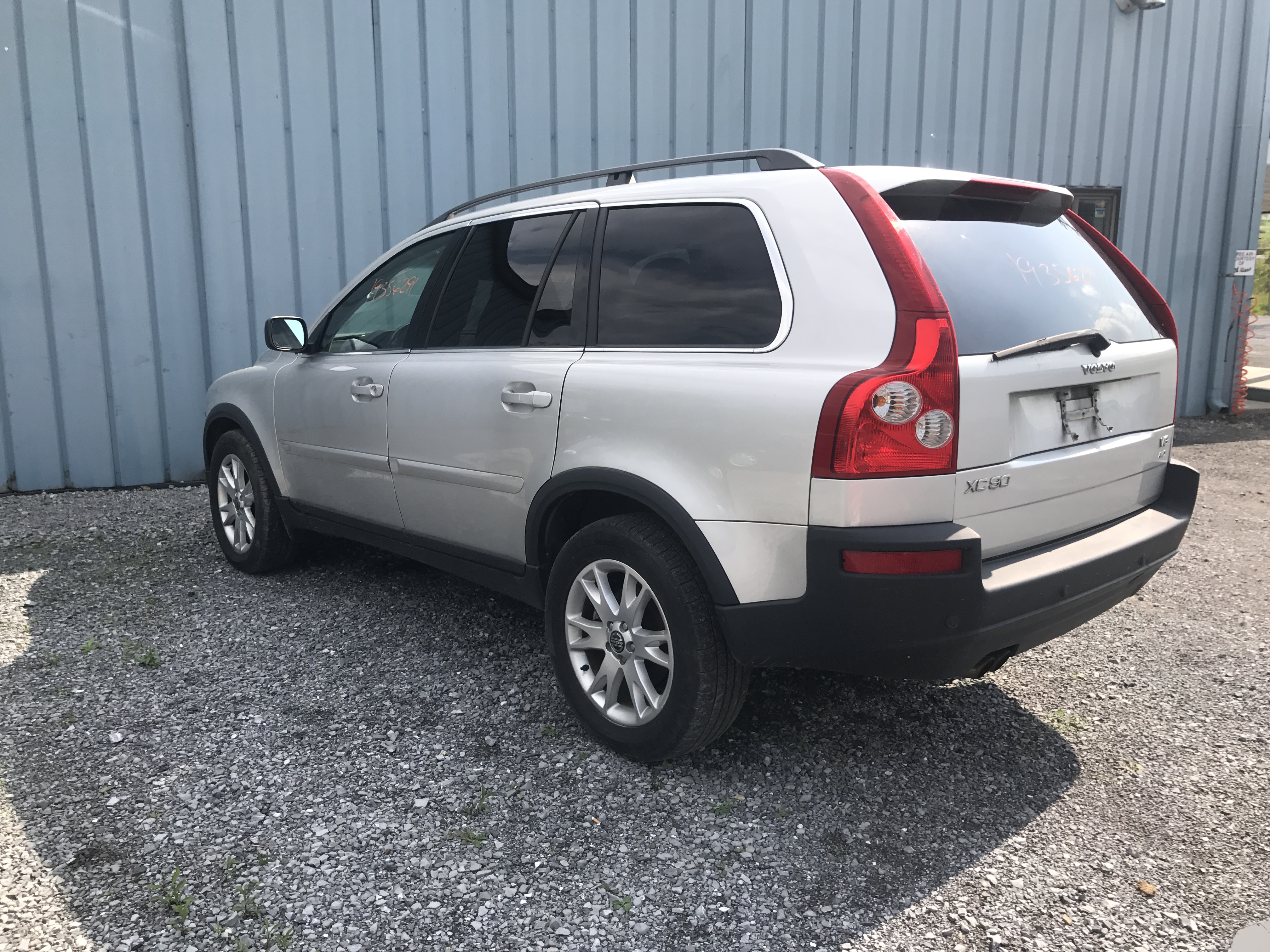

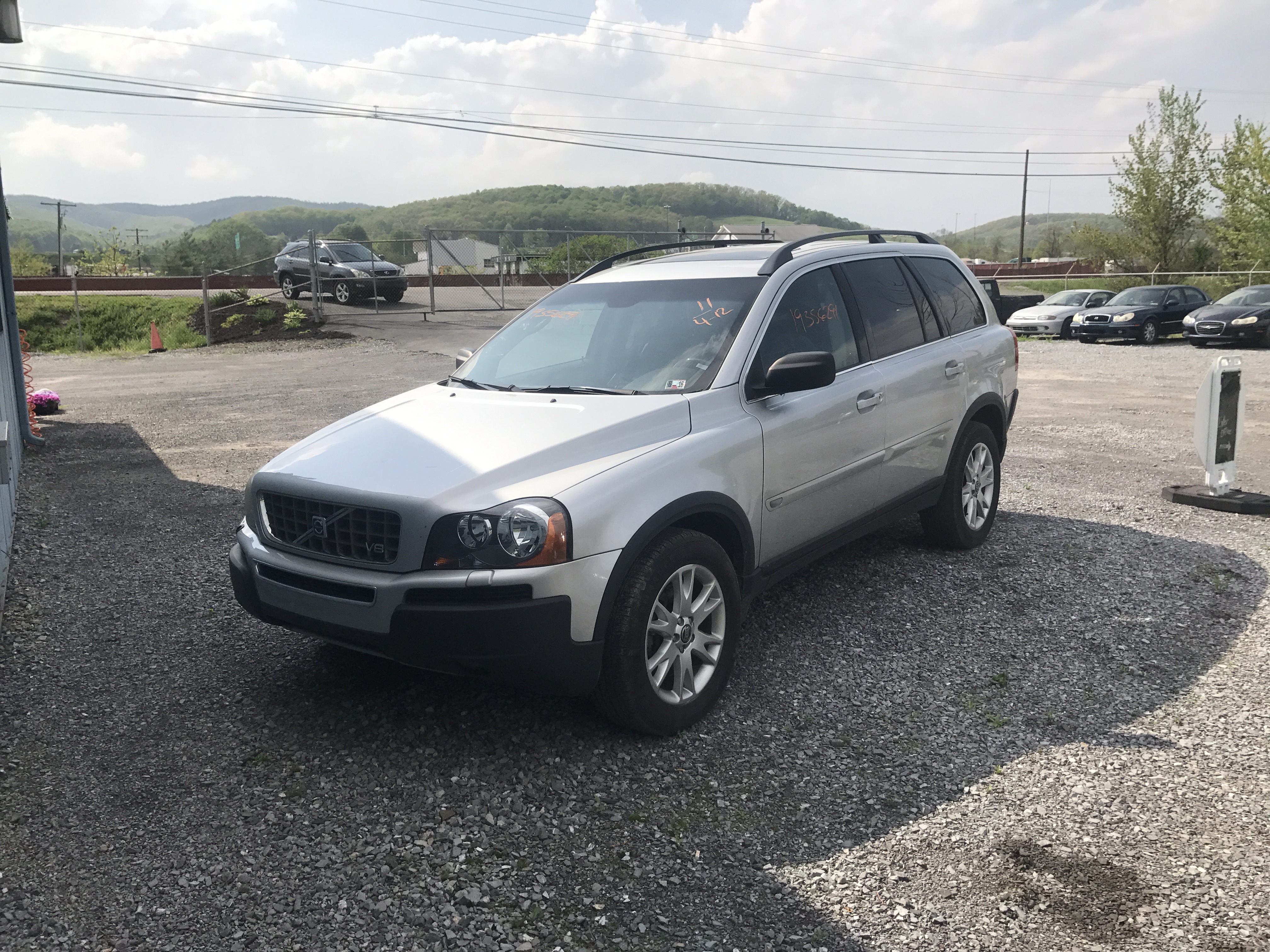

Hi all! First time posting in years. I had an '04 XC90 2.5 AWD about 4 years ago, so I'm familiar with some issues.
I've started looking at an '06 V8 a buddy of mine will have for sale (he buys and sells wholesale). It has about 160k miles on it, but it appears to have been very well kept. The only mark on the body/paint is a small spot at the passenger side headlight washer, and the cover is broken off. Tires look about half tread, and seemed to be wearing evenly. Interior is in excellent shape, with no excessive wear or split seams. He's waiting for a new pulley and serpentine belt.

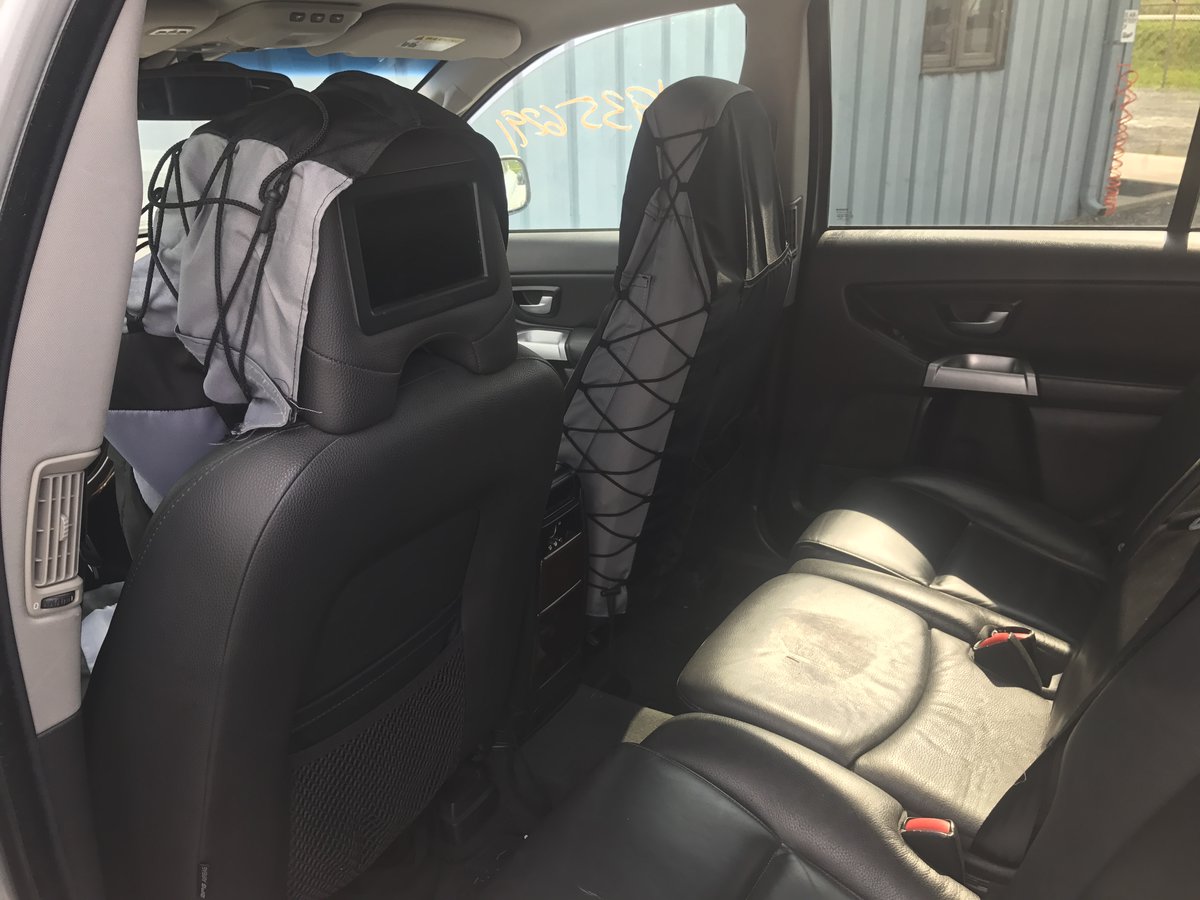

It looks to be pretty well equipped. From what I can see in the brochure for '06, it looks to have the Versatility, Touring, Convenience and RSE packages. The previous owner had seat covers on the front seats, and they're very well preserved. It does have halogen headlights, which is a plus to me, as the HIDs my '04 had were rather terrible. It was made in 4/06, and engine serial number is 0019517. It might need brakes and rotors, unless he's going to have his guy clean up the rotors. I believe it sat for a while, as the rotors have an unusual amount of rust on them, and the state inspection ran out in June of last year.

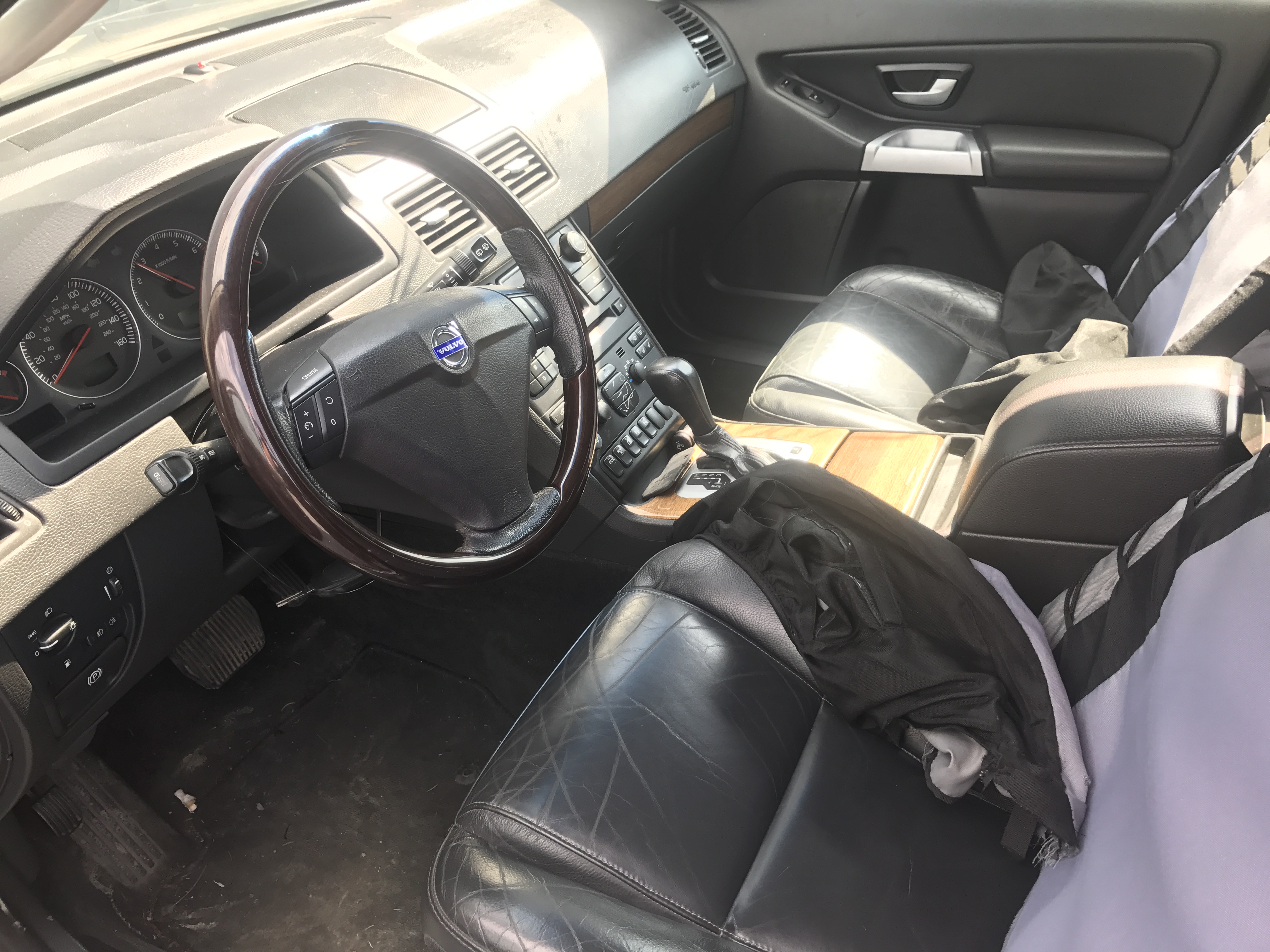

When looking at a picture I took of the interior, I noticed the tachometer is sitting just past the 2,500 RPM mark. Battery is disconnected or dead. I looked at it yesterday, but nobody was around, so I wasn't able to really go over it or start it up. It's sitting at a garage to be checked over better, so it should be ready to go when I buy it within the next couple weeks.
He said he can sell it to me for around $2,700, so I want to jump on it.

I'd be concerned as to why the rev counter is sitting off zero. It may have a speedo unit problem needing repair. Can't really answer that sa I have never seen the issue before, but know some Volvos after 1999 with the electronic dashes (like S80's) had issues with failures and heard of it on P2's but to a much lesser extent. Maybe someone else will jump in.
I think I have listed all the potential problems previously so I guess have them checked out as the 3 most expensive issues are, rear main oil seal leaks, timing chain pulley and guide failures and transmissions. Lesser but expensive are front suspension, AWD system including wheel bearings and starter motors.
At the price that does seem good to start at but the first 3 jobs can cost $3000 each up here to rectify unless you can do the work yourself.
