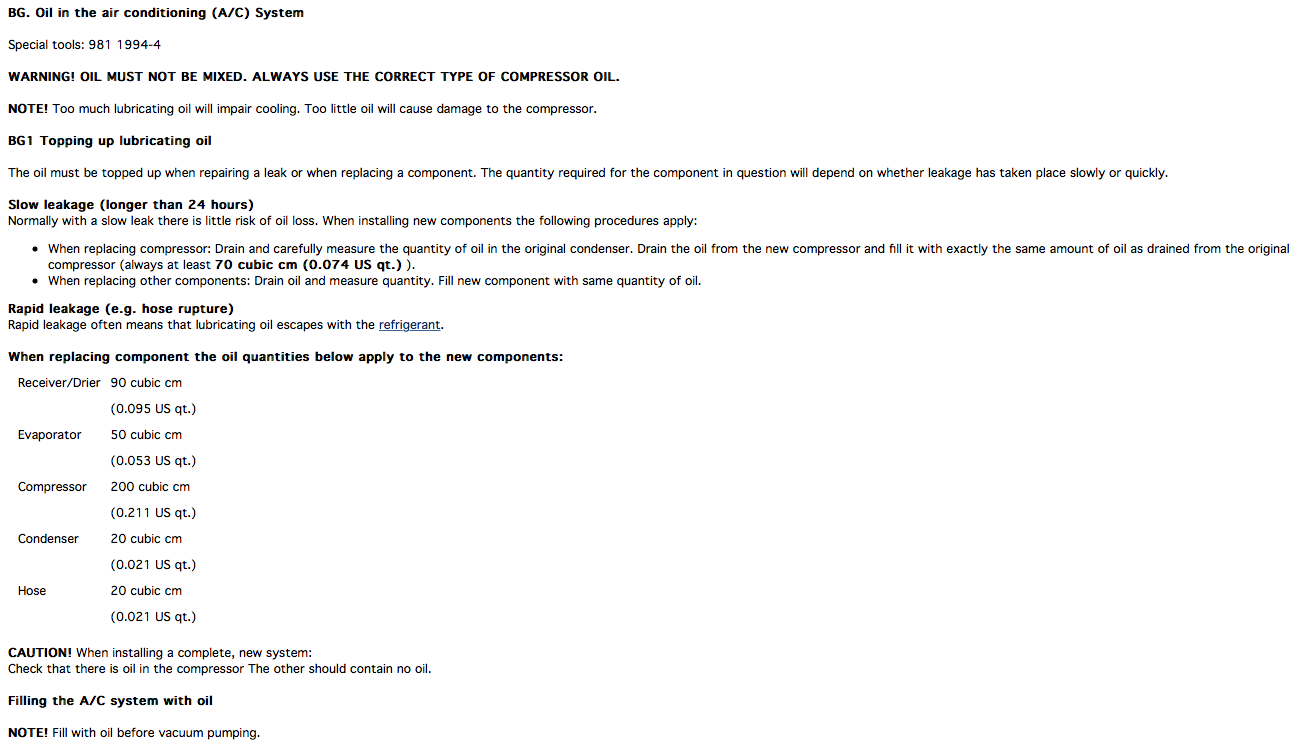

I think these specs apply to the 1999 and earlier cars, per Alldata
Total PAG capacity listed as 200cc, so it looks like the compressor gets it all. Note the compressor should always get 70cc min per this document.

- PAG oil is need only at the compressor for lubrication, anywhere else (evap, dryer, hose etc.), it is just a nuisance (not needed).
- At factory, during a dry fill, they put in a total of: 90 + 50 + 200 + 20 + 20 = 380 cc (or 12.6 oz) of PAG oil.
- Then during the life of the car, when you turn the AC on, oil is distributed throughout the system as shown by abscate above.
- In some cases, PAG oil leaks out with time via the front seal or leaky O-rings, when you remove the old compressor, you may not see much oil coming out even if you drain it. But when installing new compressor, you should put in about 200cc (around 6-7 oz or so) in the new compressor.
PS: the compressor you buy is old and may be contaminated, so flush it twice before installing: add some PAG oil, spin the shaft around, drain it. Repeat the process etc. During the last fill, add 200 cc. Add oil via the "LOW" side, then spin the shaft.

Thanks, gentlemen of the wrench, this is helpful.
Just to confirm, so i don't need to portion some oil into the new dryer, just pour the whole 200 cc's into one of the ports? Won't some spill out during installation, connecting up the lines?
If I drain and refill, which seems like a good idea, I'll want to be careful to measure the amount that drains and refill only the difference between that and 200?

Flush it? Why not. This is the replacement and while looking into the open ports it looks clean, I didn't take it apart to examine it further, so running some fresh oil through it won't hurt. Then I will want to hold it vertically like the guy in the video shows, turn the clutch plate, then empty out all the oil (that will come out) into something that shows the volume so I can be sure of how much, if any is left inside—then fill with amount needed to 200. Don't worry about putting any in other components, which probably still have a little in them (I'm installing a new dryer that won't have any in it). The local guy said that's how they begin when installing a new compressor. Then when the machine installs fresh refrigerant a little more oil is usually added.
One question referring to the video: The demonstrator puts in the oil then holds the compressor vertically with the open ports up and turns it over with the clutch appearing to burp it. But if I do that, there will be oil in the cylinders which is likely to leak out when the compressor is held horizontal for installation before the pipes are connected. So is the burping step necessary or even wise? Because if some oil does leak out during installation it won't be caught to be measured, then I'm back to needing to do it over. Maybe that's the flush step; it gets some lube on the cylinder walls and probably the wobble plate and internal bearings hopefully; then empty it out, measuring what comes out and fill accordingly to 200. Then install the compressor.
The other concern I have about the machine they use in shops is oil compatibility. In the info sheet abscate copied above, there is a stern warning not to mix oil types. So what happens when the machine in the repair shop doesn't have pag 46, but who knows what in it and that gets mixed with the right stuff?
