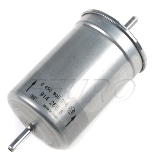

Ok so I went out there and pulled the vacuum side of the fuel pressure regulator and it immediately started dripping gas. I'm so happy I finnaly figured it out. Thank you so much. O and one more thing I removed the fuel filter and it's so rusty I can't tell the correct flow direction will it matter if it's put on backwards?

do not put it on backwards. all the junk you've filtered out over the years will be pushed into the fuel system, as it'll now be on the wrong side of the filter element. go get a generic fuel filter or even a hose barb - basically nothing you could do would be worse than installing a used filter backwards.
- Posts: 11913
- Joined: 25 Jul 2009, 14:03
- Has thanked: 312 times
- Been thanked: 818 times
Courtesy of Eeuroparts:

Ok thank you so much. So basically the round end towards the rear of the car and the seamed end facing the engine. Yea that would suck if I installed it back words. I wouldn't even bother putting it back on buy need car to go get new one. I was trying to find some thing to ok just connect both hoses.well I have it the way I stated. I hope that's the waft ha ha
