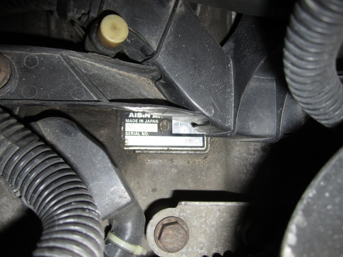

You should have the 5 speed auto (I have a 2000 'R'). It was a final year of that model and they fitted the Aisin Warner (AW50/51 AWD).
I had a look at the pictures of my 'spare' trans that also came from a 2000 'R' and it for some reason had no ID plate on it for help.

Thats what i got initially, but here on this site in the transmission database it is listed as the AW55/50sn. And the same from IPD volvo.

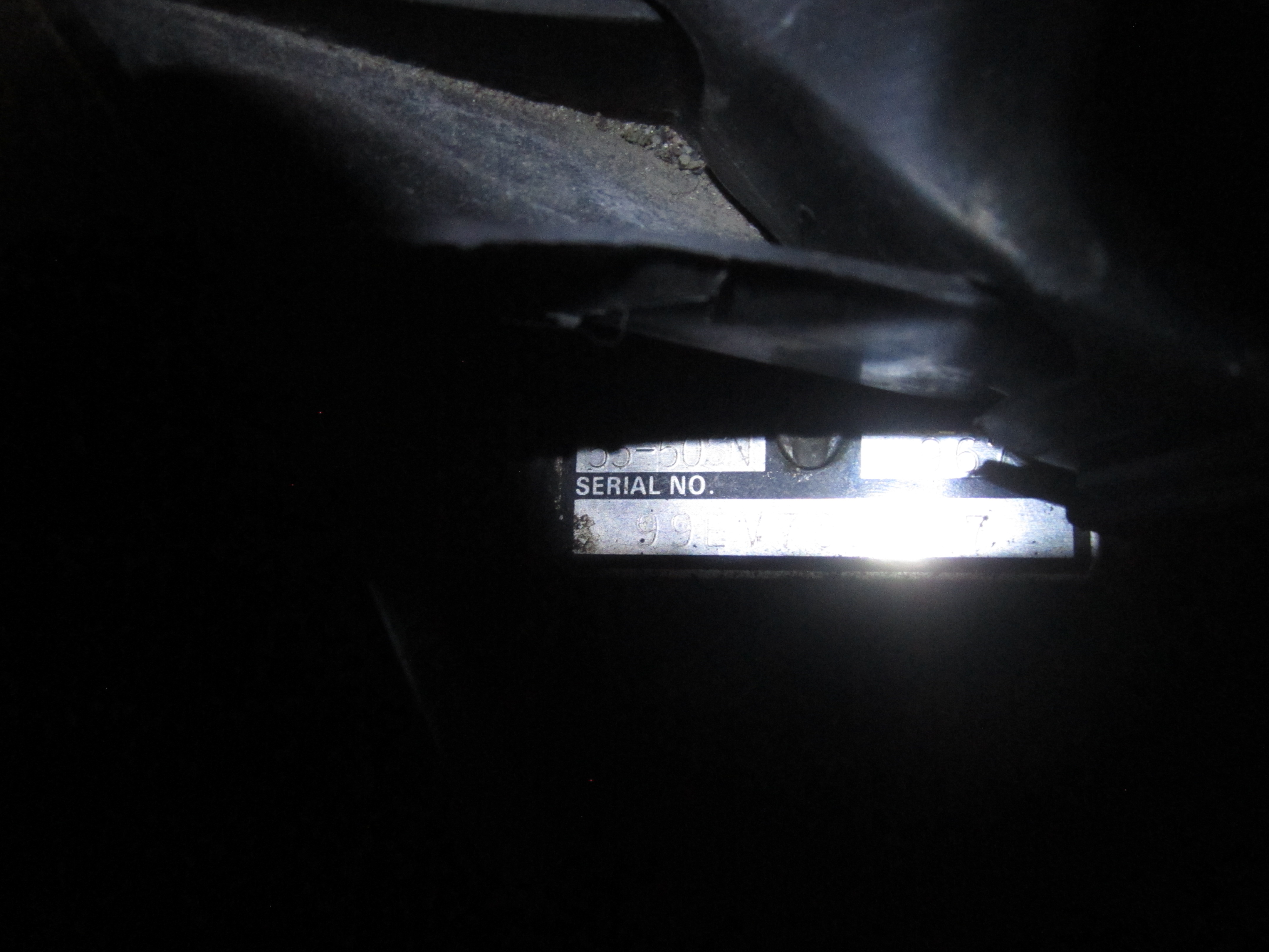

I tried to take a picture of the label on the trans in my car. It was nearly impossible as it is just a stamped number on a silver back-ground so any lighting whites it out.
What is says is 55-50SN.
Hope this helps.
Hope this helps.
