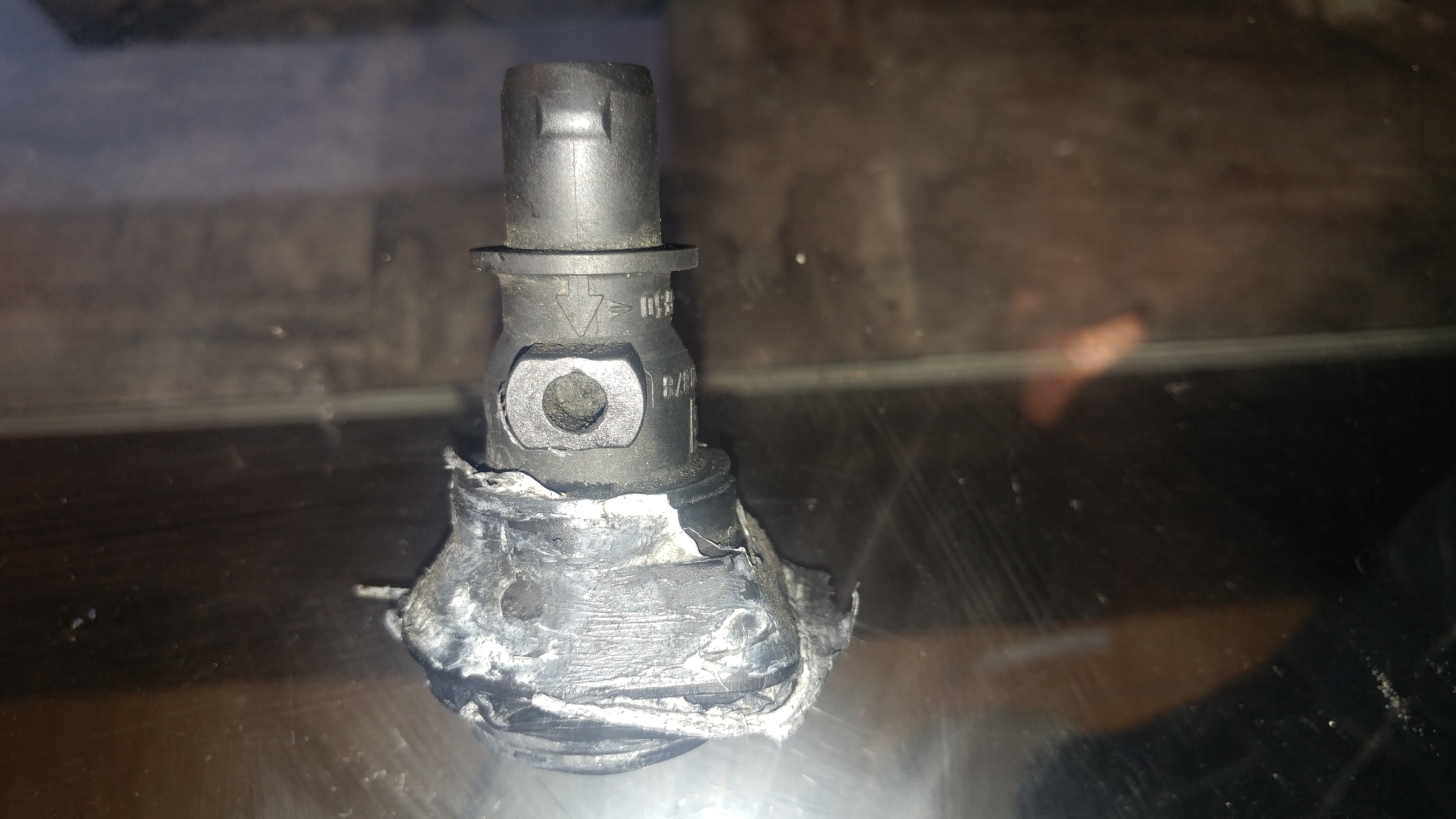

I'm having trouble finding where the hose that used to be in this hole routes to?
After removing the pcv nipple I broke the plastic hose and forgot where it went. I have a 2000 v70r so it's a little different then everything I've found so far.
Thanks in advance!

Don't worry: no hose connects into this hole at the side of the PTC valve.
Take a look here:
viewtopic.php?f=9&t=69305#p438480
