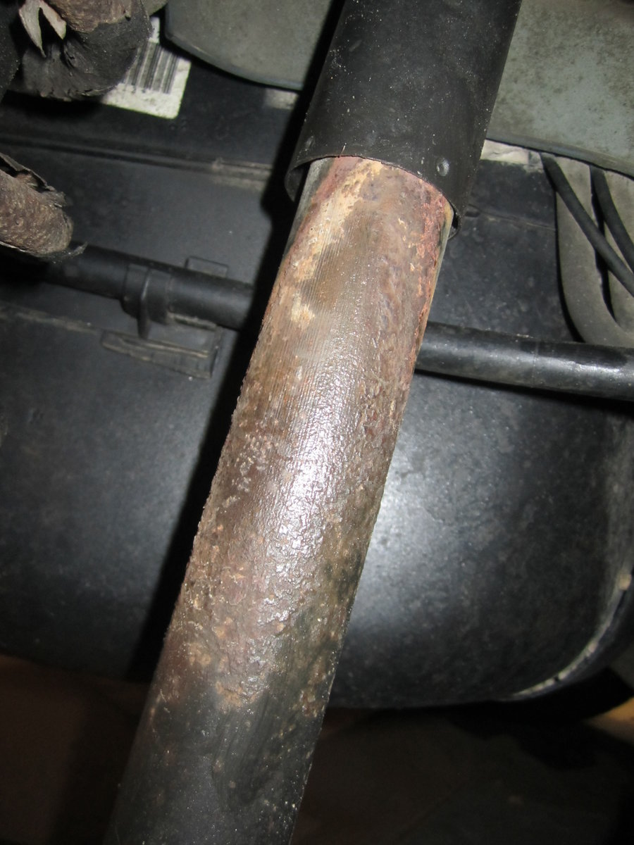

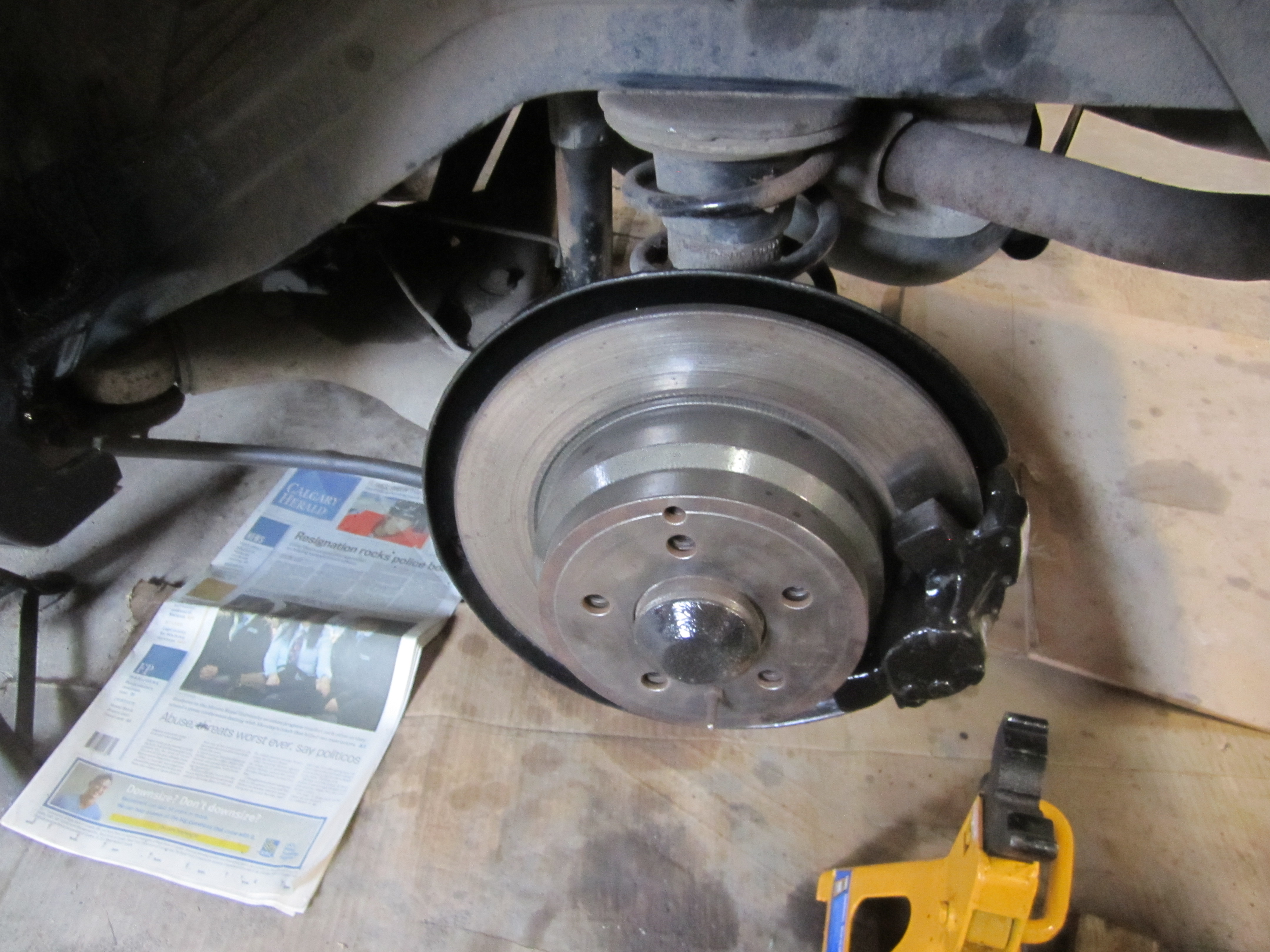

Different markets have different costs spent on them. I could spend ages with examples, but one is that the North American and Japanese Volvos (P80) had a more complex emissions system then the European vehicles. That is why I had so much difficult finding parts for my 2000 'R' when repairing the emissions as parts are limited to here for availability and stocks.
My 2000 V70 NA has the basic shocks:
I find the European cars often are higher spec'd than over here. I know cars sold in Britain were often higher spec'd even on base models than in the rest of Europe.
Back to OP question. Have you spoken to the Eibach suppliers or Eibach themselves? Could just be a badly made coil spring.
