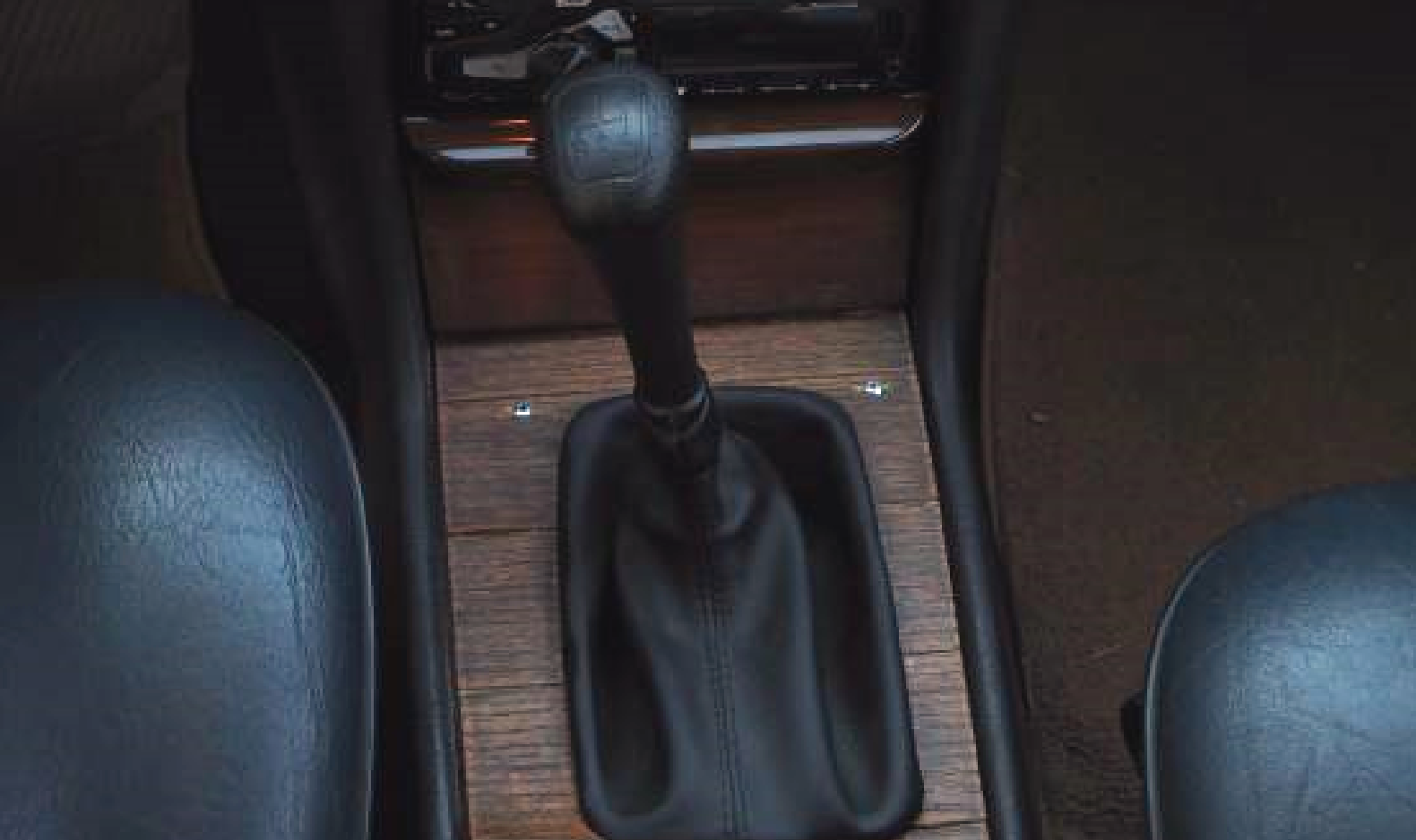

Something similar happened to my Mercedes, in which an eBay seller sold me a shift boot for a W123 Mercedes that was not for a W123 Mercedes, and I had broken the clip for the factory shifter.
I riveted in two strips of aluminum to hold the old clip in place from underneath (see picture below). It did the job, and the rivets don't look too bad on the tattered old wooden console trim, but it might not be such a charmingly quaint look on a newer car like a Volvo. Maybe one could do a better job disguising the rivet heads with some sort of trim piece, paint, or tape.
