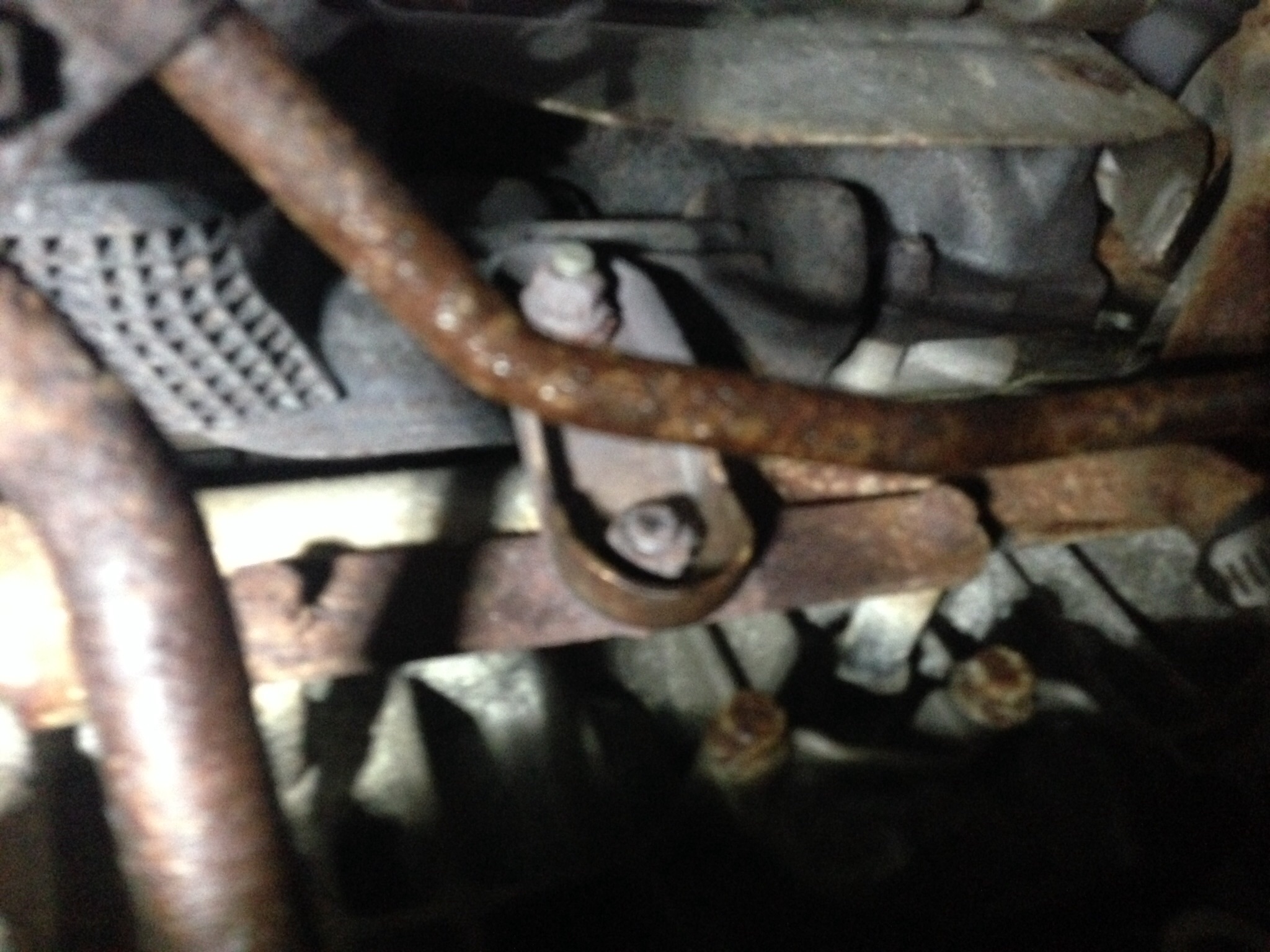

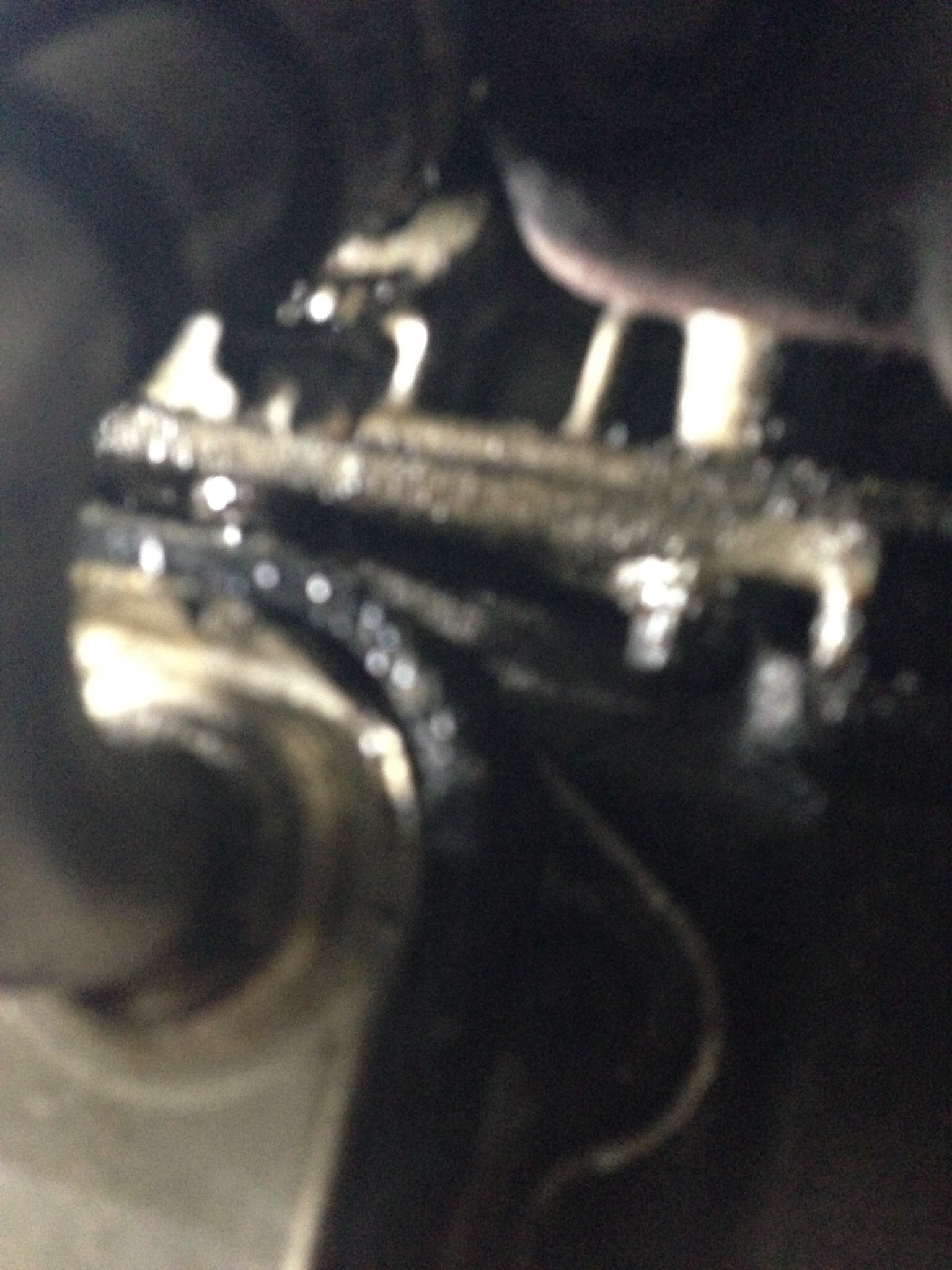

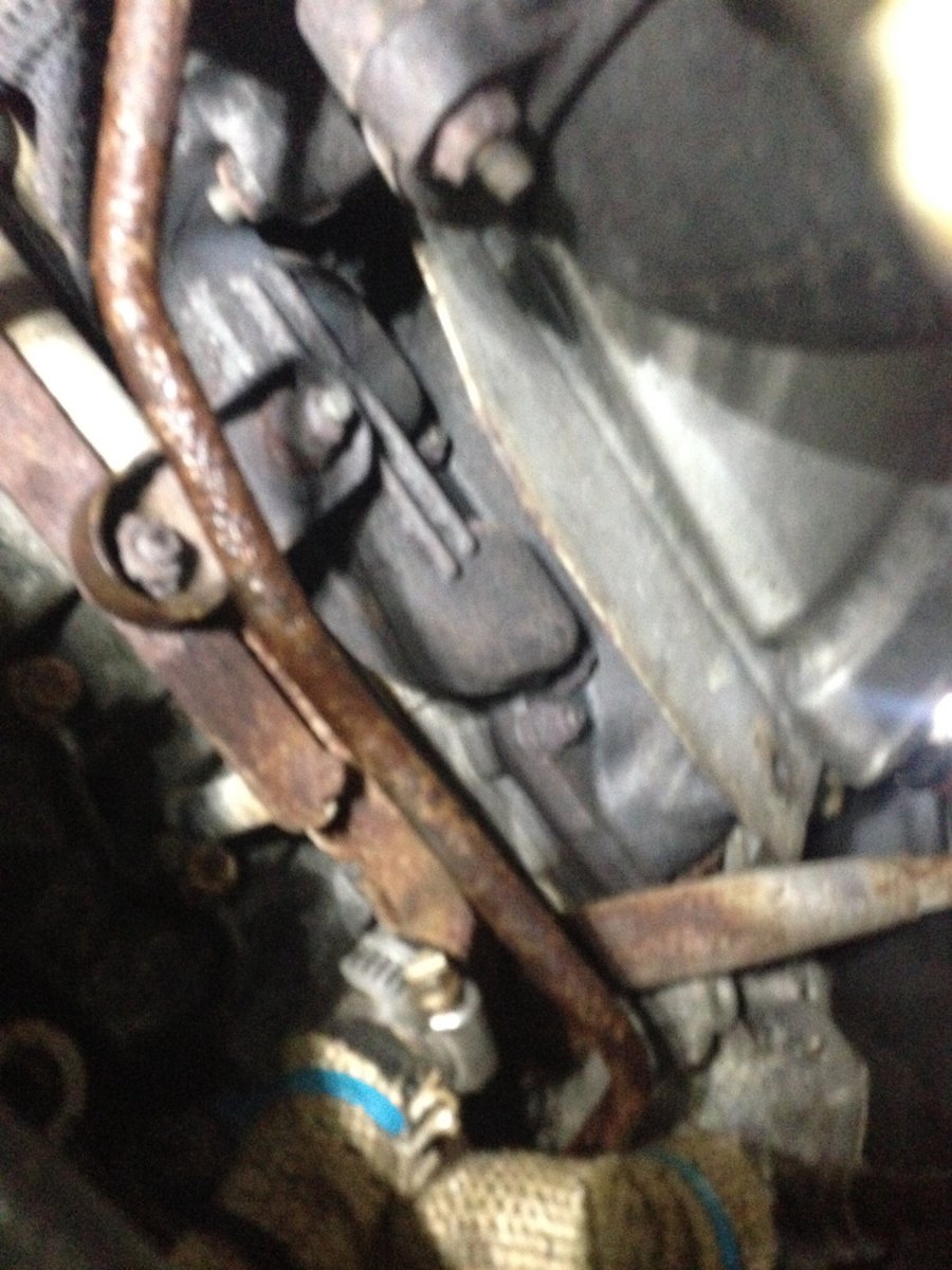

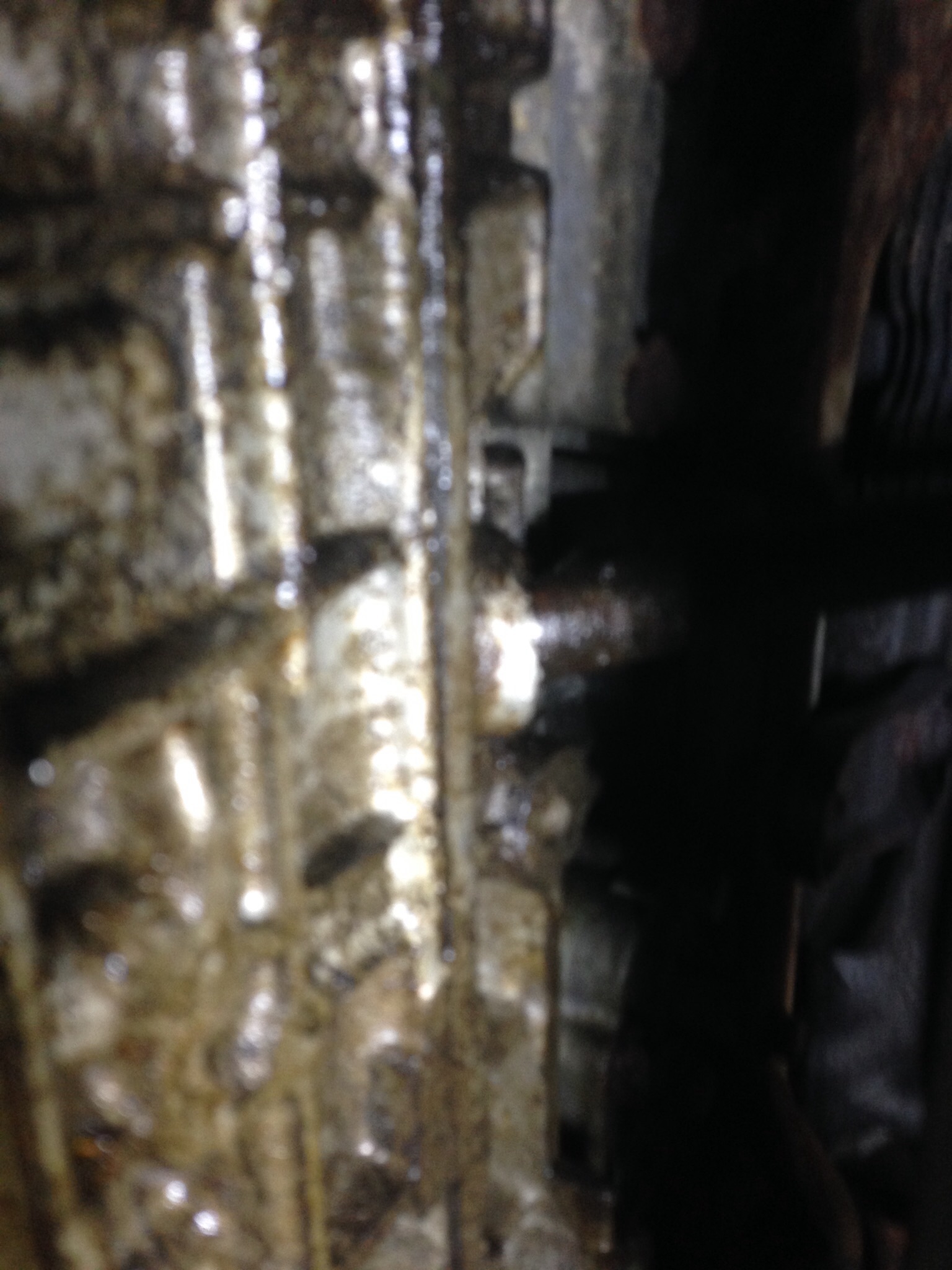

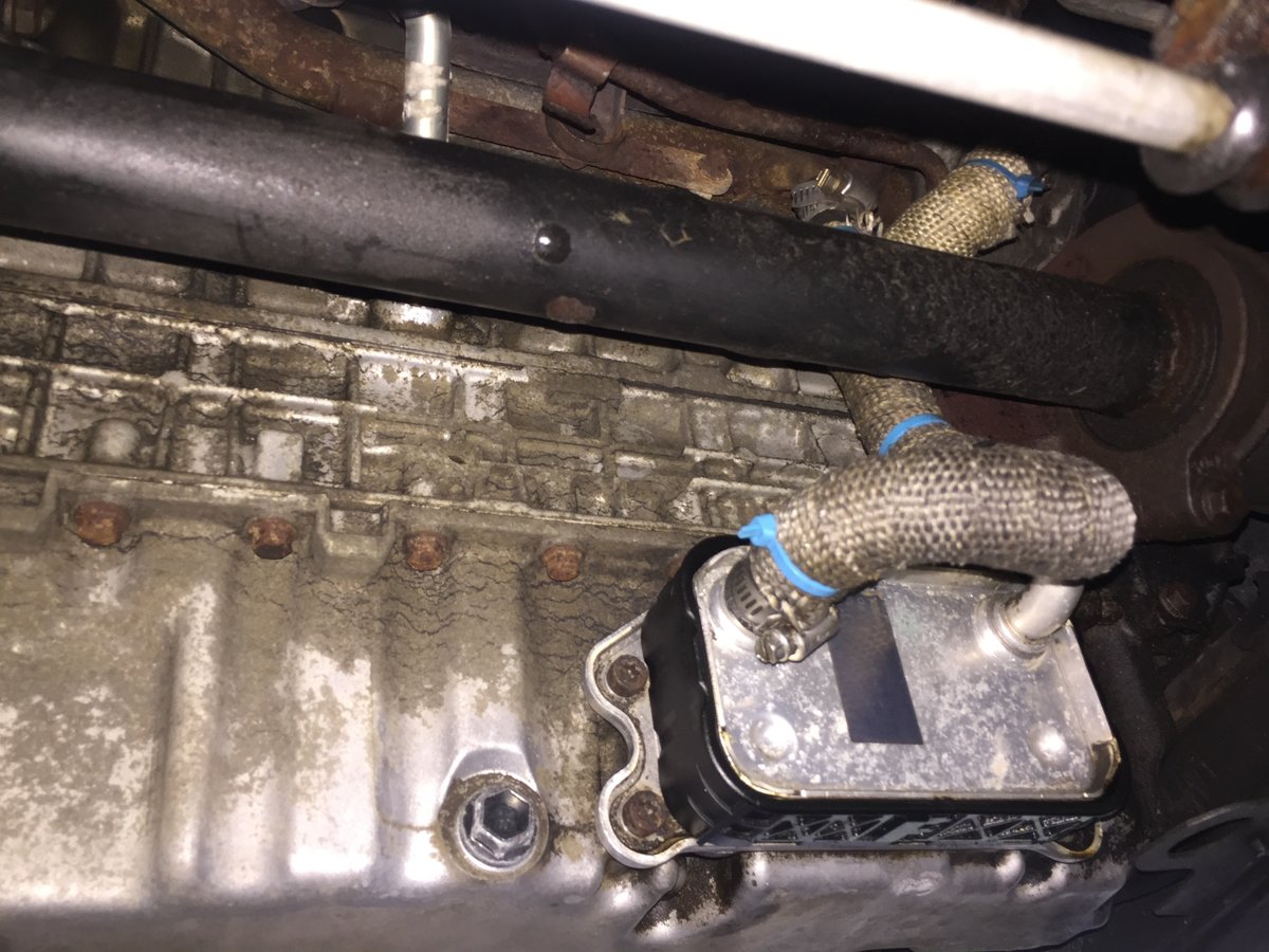

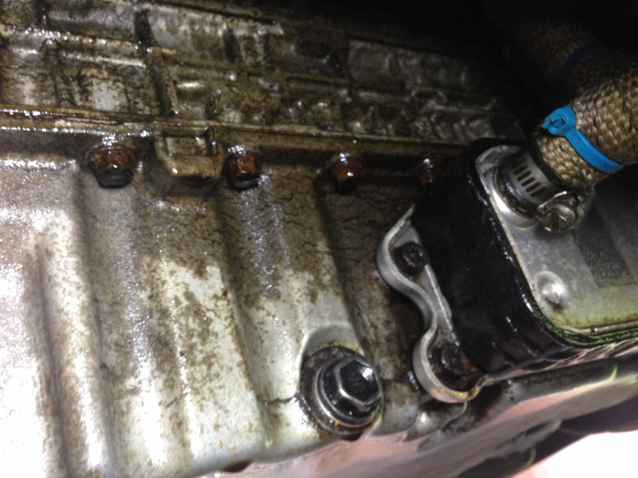

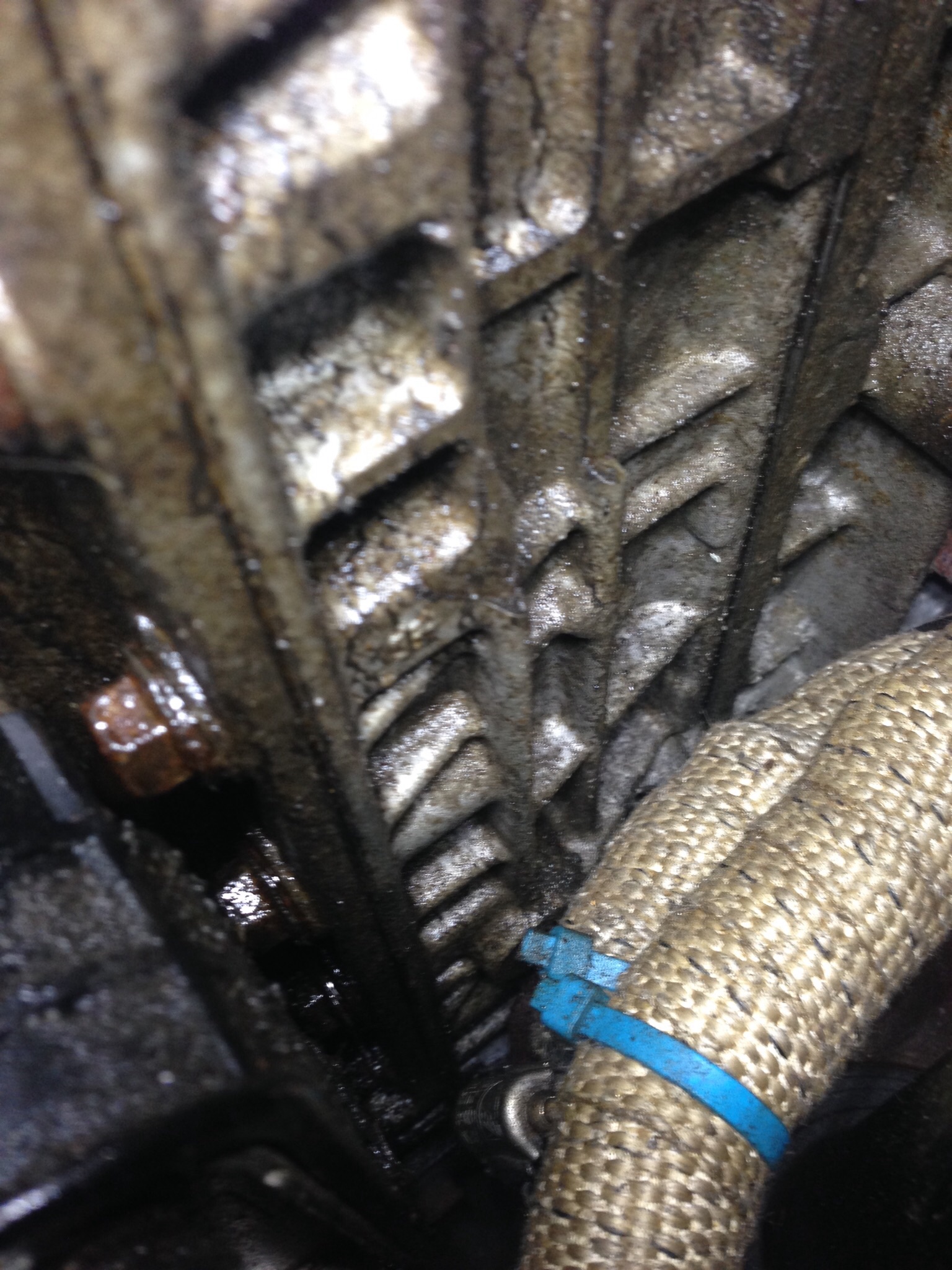

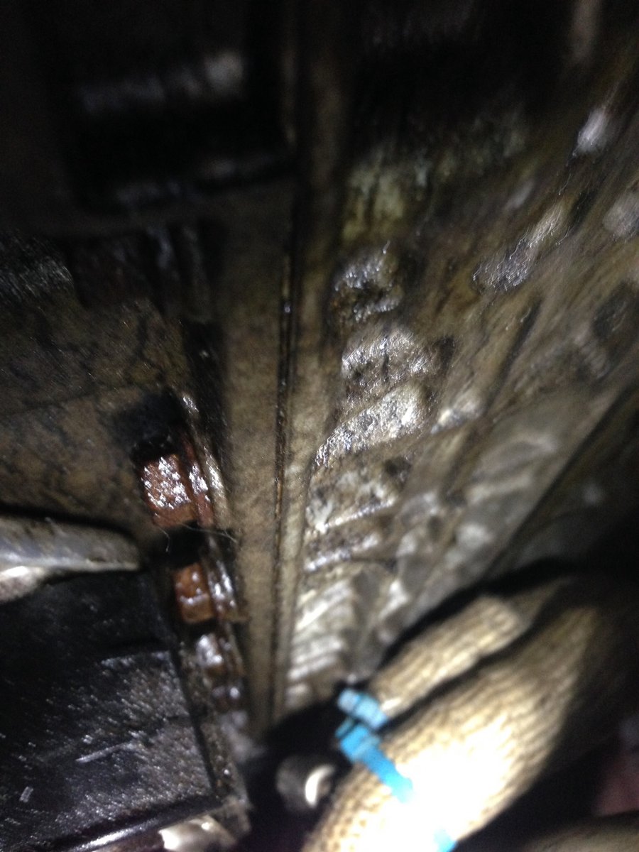

I'll post some pics but I'm working on a light oil seep on my 1999.
It looks like it comes from the joint on the block , the oil. Pan, the oil cooler ( biscuit type) based on the upper cut off, but this one does have me stumped a bit.
1999 v70T5M oil seep at rear (right side) of engine 3514546 30637866 (turbo return line) Topic is solved

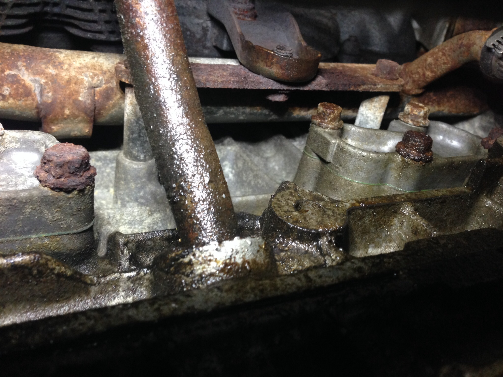

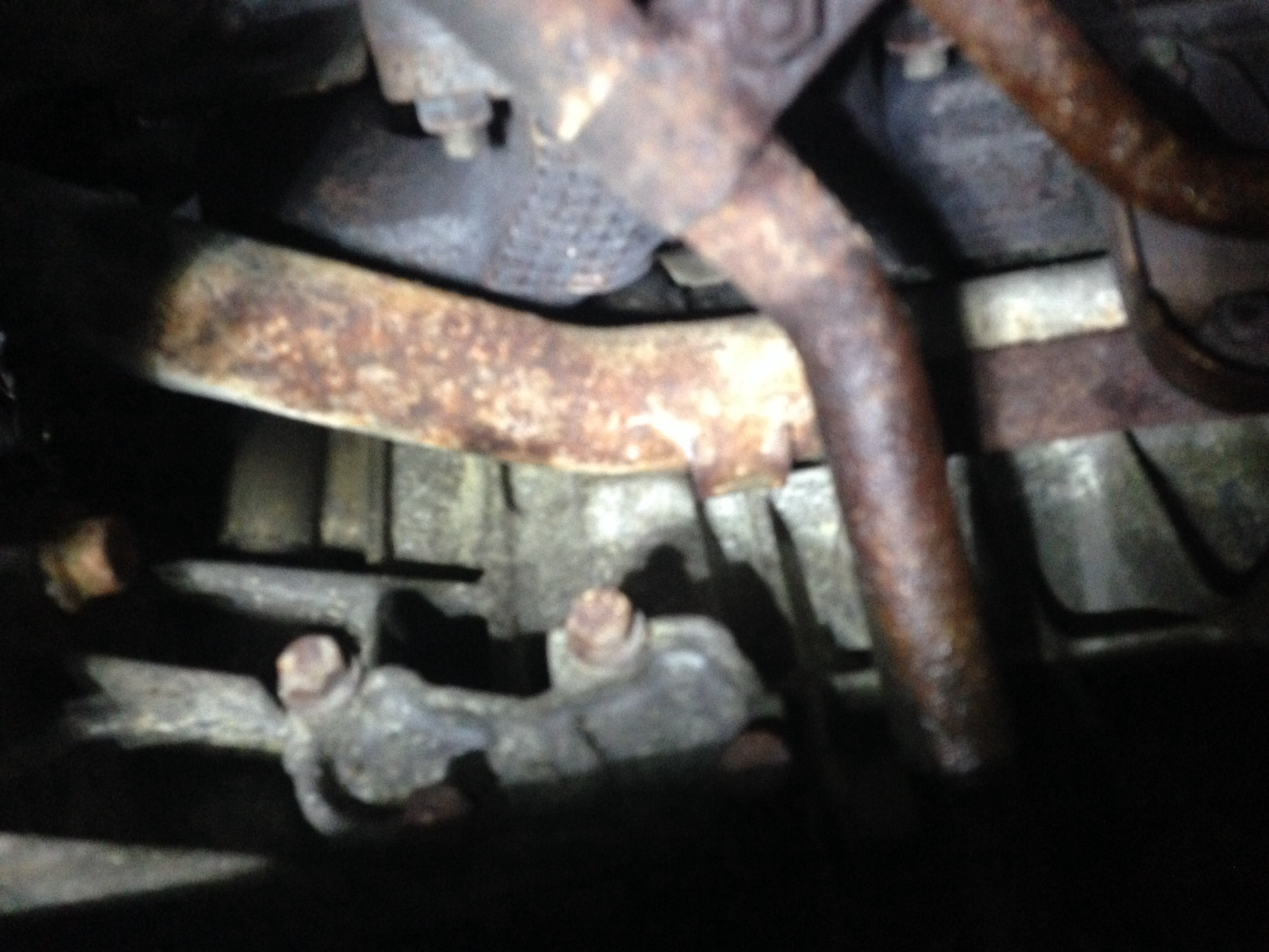

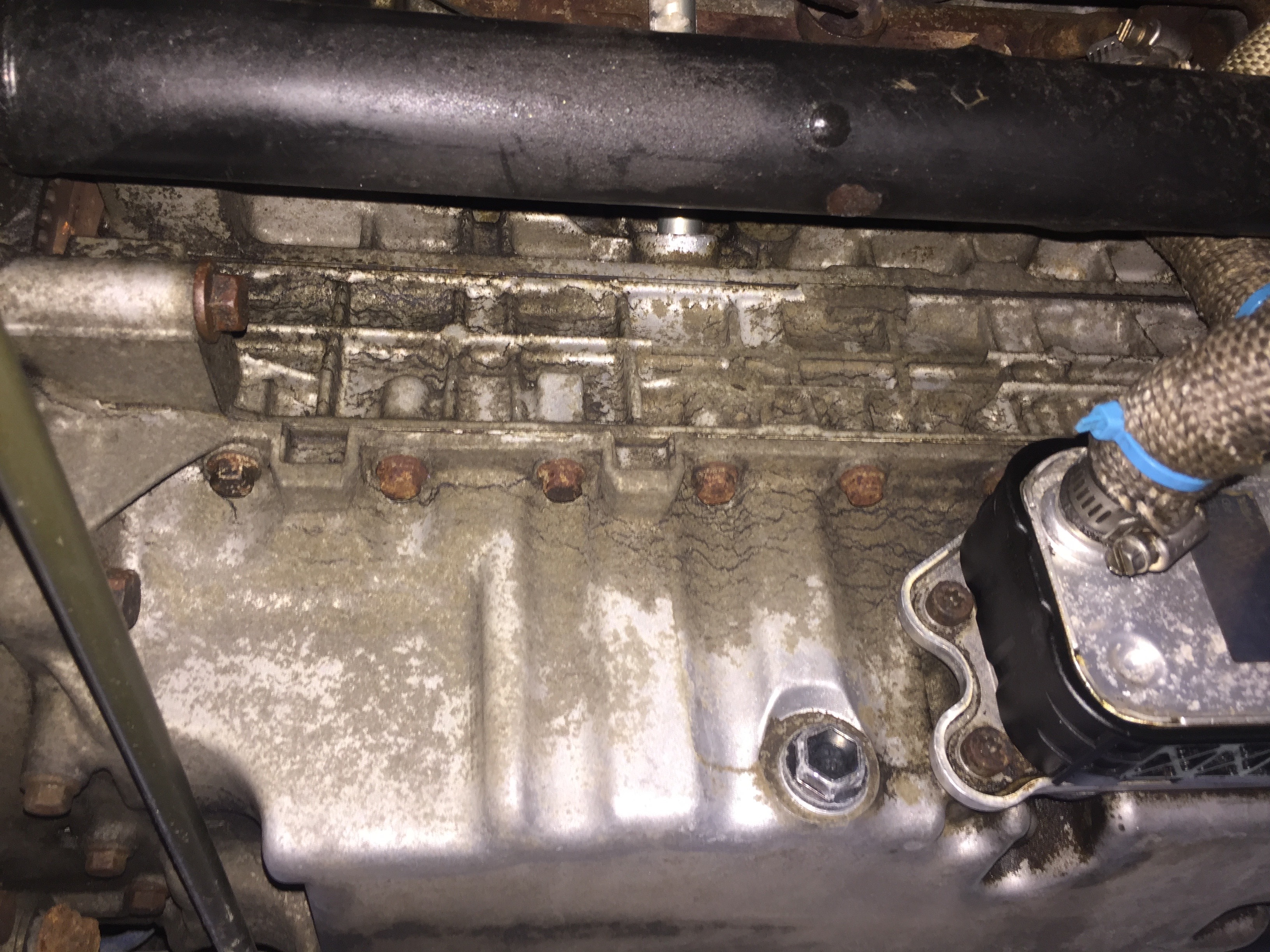

I wondered about that. Could that tube spray oil up though? There is some oil above that area, but not that much.
I wonder where the oil level is on the full sump. If I am over filling slightly , could that be causing the seep?
I idled the car for 20 minutes on Ramps, engine tipped back slightly, and didn't get a single drop.
Consumption is something like 1 liter per 1500-2000 miles
- Posts: 35267
- Has thanked: 1497 times
- Been thanked: 3809 times
Updated. I ran a long Boston trip with the dipstick at star 2 out of 5. This is the new dipstick which reads lower than stock
Not a drop used nor leaked. Looks like this was just overfilling the crankcase.

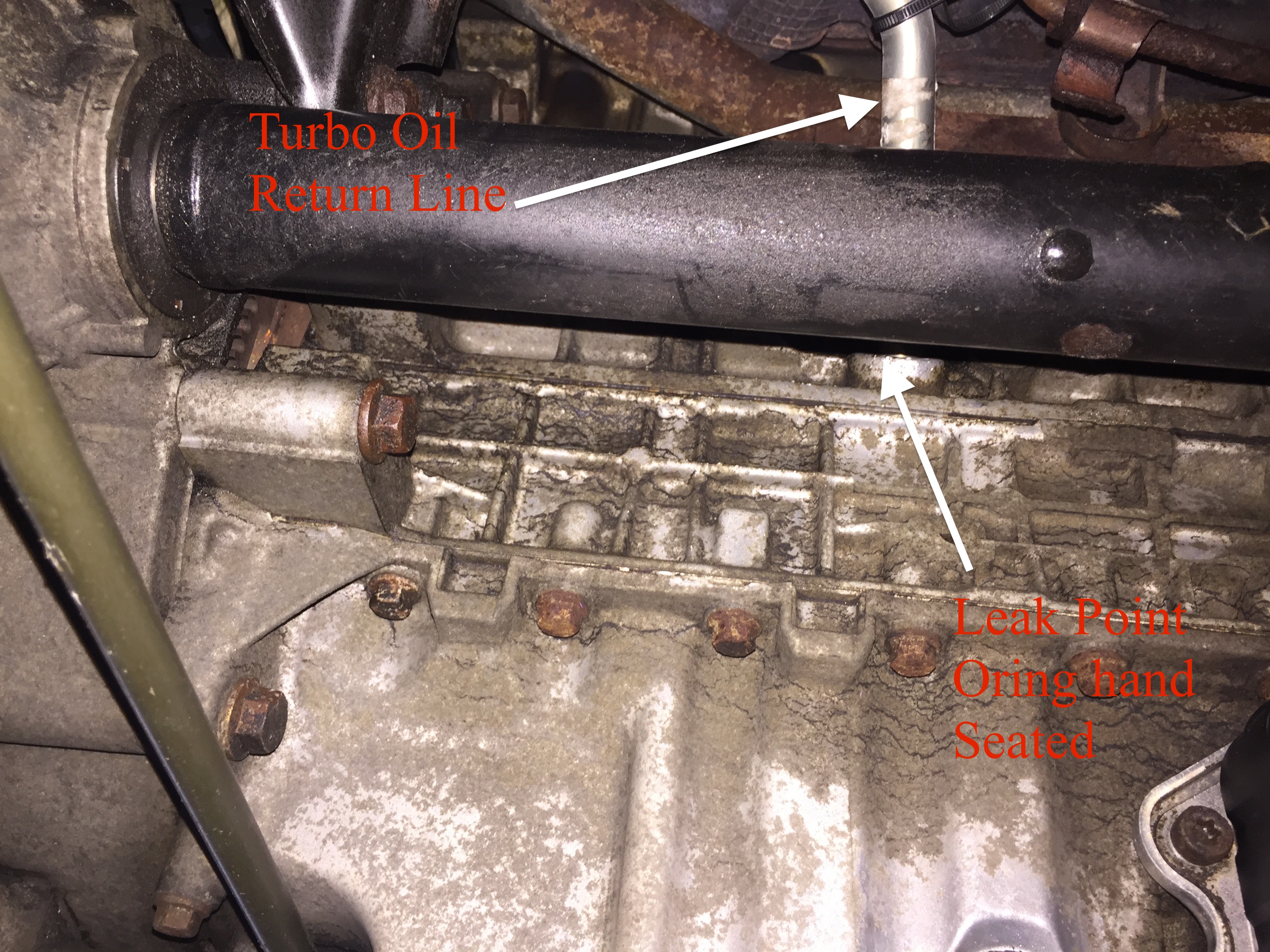

If I had taken this advice two years ago, my driveway would be a lot cleaner.
I did the turbo line job about two years after getting this advice.
Roling underneath today after a 30 minute run it looks dry. Tough highway run to definitely test next week
Turbo line procedure here
viewtopic.php?f=1&t=89166&p=503296#p503296

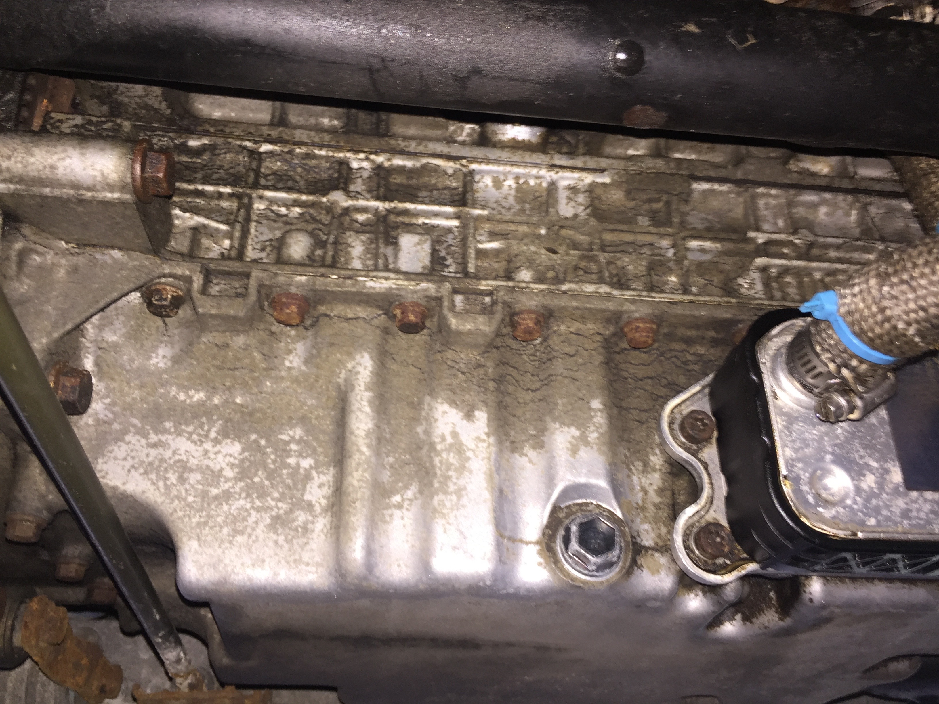

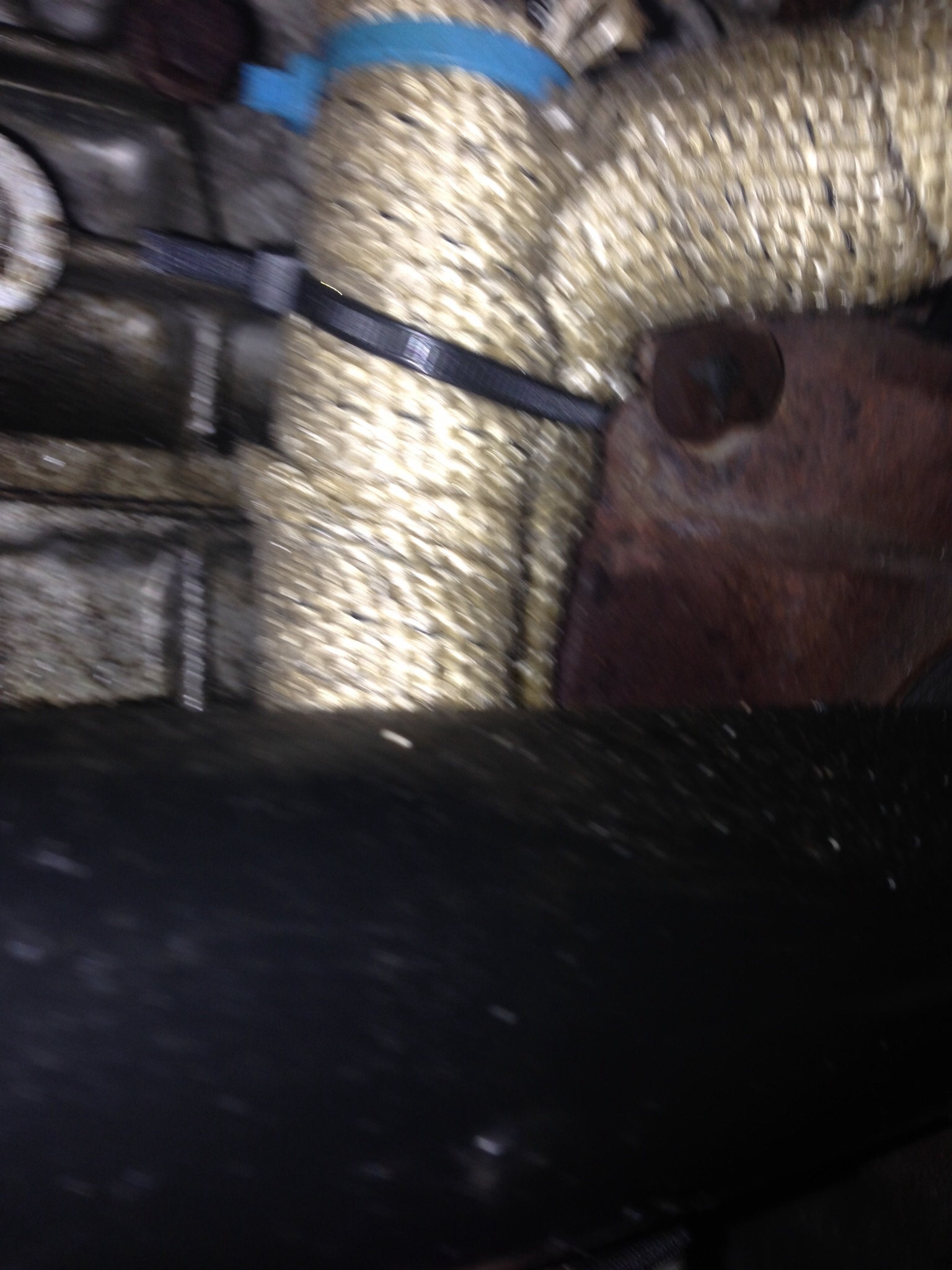

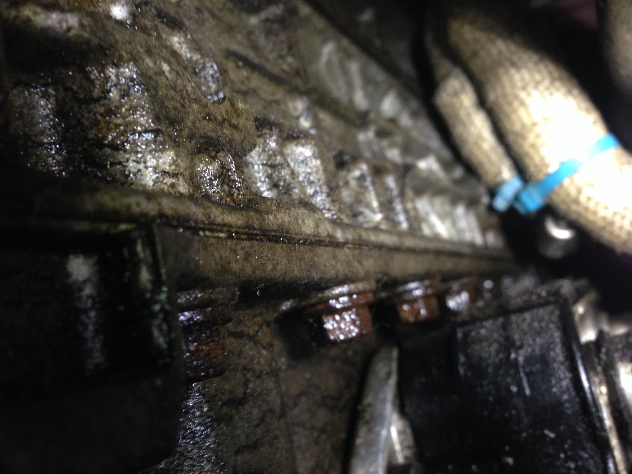

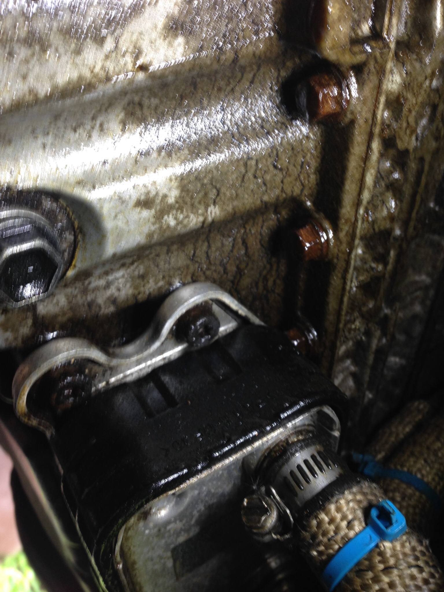

Well after a single 1000 mile hot run, this definitely cleaned this up.
That turbo oil return line can leak in funny ways and send oil everywhere - duh - probably by hitting the spinning driveshaft.
I cleaned with Citrus, ran 1000 miles, and here is the after pictures
+1000 points to tryingbe POST CRED for suggesting this 2 years ago.
