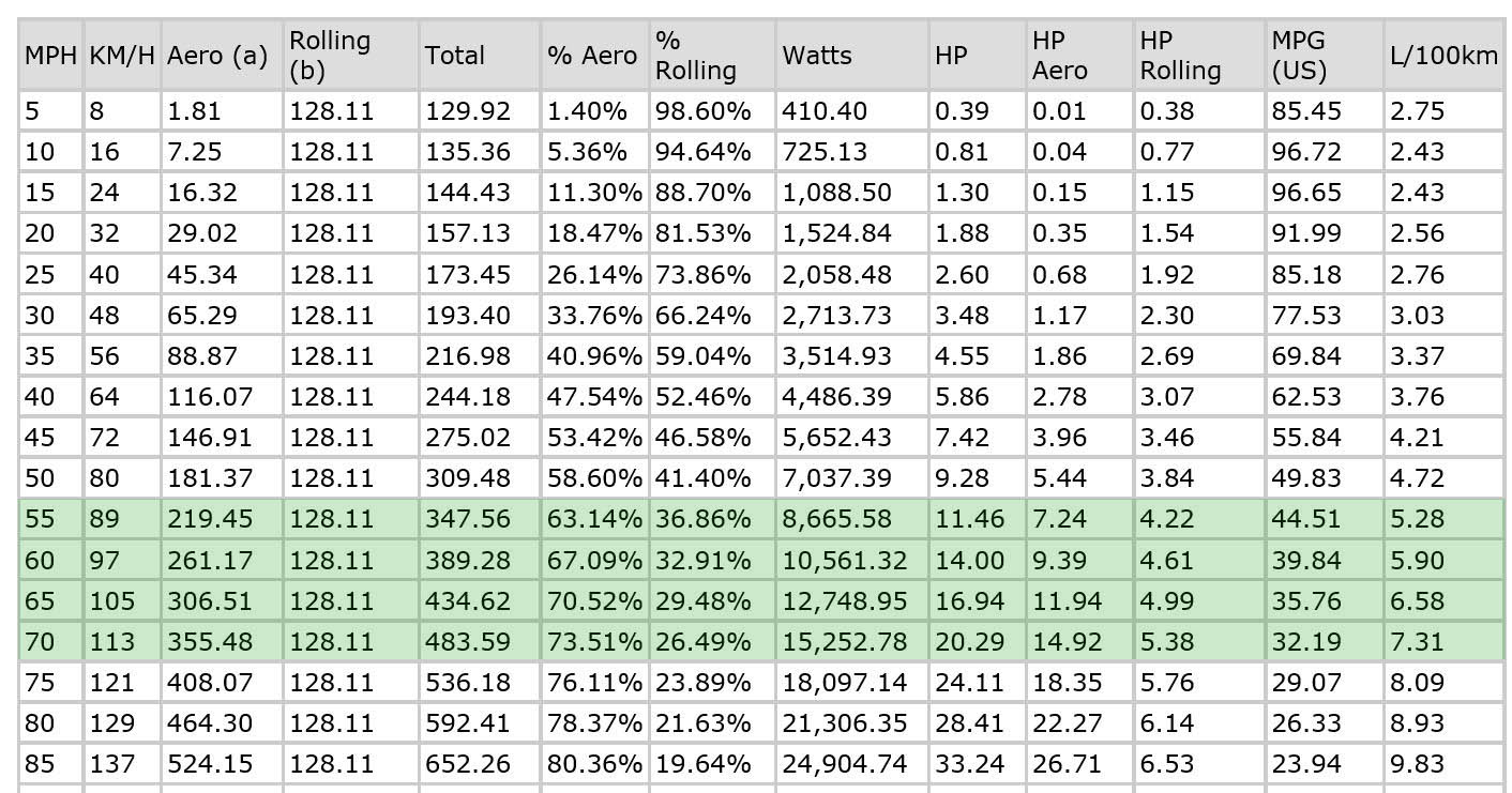

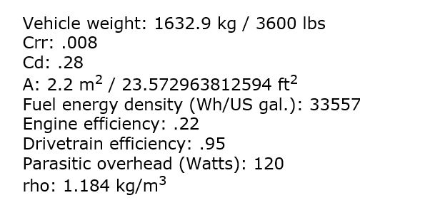

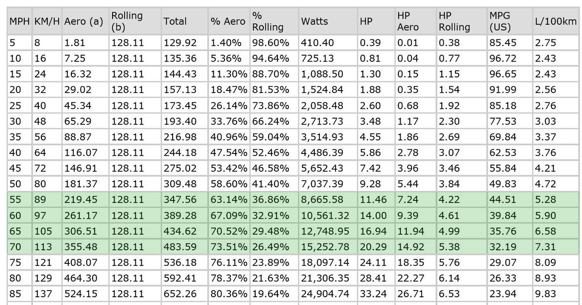

Not necessarily. I just did that (map below) on 2.8 gallons of premium just hours ago--112 miles/40MPG. MY06 FWD S60 2.5T 104k mi on the ticker. Some stoplights/stop and go on both ends and through downtown South Bend: not strictly highway.
Hints: on the FWDs @60mph if you're not coasting the downside of highway overpasses with your foot off the gas and instant econ at least in the 70s, often pegged at 99, you've got parasitic drag--either dragging brakes, alignment, or ridiculously high rolling resistance tires. In heavy inner city rush hour 'creep along' you should be touching the gas pedal with a feather momentarily and coasting most of the time unless you're pointed uphill.
Alignment is 80% of the battle on these if you're looking for great econ. I've learned you can't rely on 'shop machines'. You have to play with it with some trial and error involved. Some shops will road test and fine tune after a basic machine aided setting. This can take hours. For $59.95? Not gonna happen.
Or you have problems. NO CEL does not mean it's running perfect.
No ICE car on the planet with a powerplant over 100hp will get good econ in stop and go if you're a leadfoot. I can burn up 1/8 tank on gas just on a 10 mile round trip just to fetch Starbucks. These cars feel wonderful when you stomp on it. Even just half way down.. I love it too. But I've learned to back off: that same 1/8 tank can get me more than half way to Chicago (100+ miles away) if I just take it easy. NO, nobody's yelling at me for going slow. Feather plus a little is still as fast/faster than most people in average non turbo cars accelerate from a stop. Anything past about 1/3 throttle on these is the equivalent to a Honda Civic being driven really hard. We lose this awareness because we're acclimated to so much more... when the Civic would be straining at the redline and sounding like it might blow up (most people would back off unless they're genuinely in a hurry), these Volvos don't act like they're even trying. 'VOLVO driver' and the LEADFOOT are interchangeable terms to non-VOLVO owners, just as a reminder. Other people don't realize we're barely touching the pedal. From their perspective we must be flooring it. Power=fuel consumption, even though the car doesn't act/sound like you're driving it hard/agressive, you just might be.
Anyway--
The S60 has a drag coefficient of 0.28. Yes they CAN do it or at least the FWDs can. Everything has to be purrrrfect. And exchange the 2 pound lead weight for something more of the 8 ounce variety.

The more you tweak tires/suspension etc. for higher mileage, the further the average mileage number on the onboard computer is off.chrism wrote: 08 Jun 2017, 15:54 If you're judging your mileage by the onboard computer, please know that those things aren't perfectly accurate. On our cars the computer reports about 1-2 less MPG than if I do the math using miles traveled divided by gallons purchased at the pump.
The average-o-meter is 8-12 MPG low on mine from actual observed econ (tracking fuel purchases and miles traveled), even if I reset it before a long drive I've never seen it more than 32 mpg.
The average appears to be a complex calculation which seems to 'under-weight' stretches of coasting downhill with the pedal fully released, and/or in heavy traffic when the wake from the vehicle directly in front pushes cruising econ well into the mid/high 40s. It's like the computer decides 'impossible!' and factors some lower number deemed more realistic into the average.
However, the instant econ does appear to be pretty accurate. If I watch the instant and guestimate what the average might be, the number I come up with clicks with what I'm actually getting.
Be aware if your car is AWD you will never see these numbers. The AWD system (angle gear, driveshaft, rear diff and extra set of halfshafts) adds a crap ton of rotating mass into the drivetrain and substantial parasitic losses. AWD I believe the best case you can hope for is somewhere around 30-32 at moderate speeds. High speed interstate travel at 75+ mph you might not even get 20.
