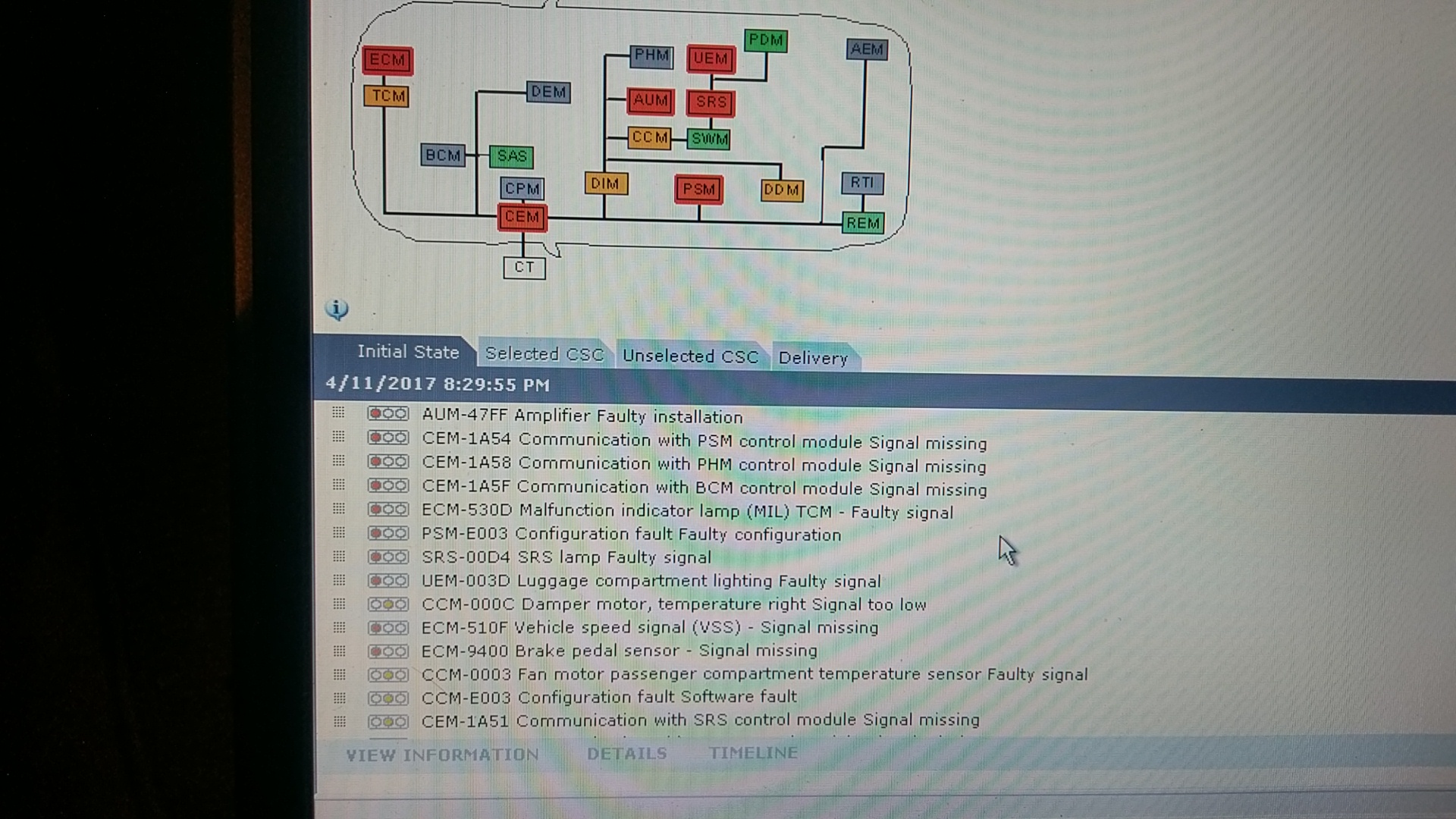

02=VIDA, right?
But I'm with Jones.... You'll need to read out the codes with VIDA/DICE to start to decipher the issues your experiencing.
The SRS and other errors can be caused by a DIM (Cluster) going bad. Mine is currently doing the same thing. DIM errors, text scrolling, SRS won't reset... its annoying
Then yours failed completely, so we can presume those were the lead up to the eventual failure. You may even have other issues with modules on the other side of the DIM, like the SRS, AUM (Radio), DDM & PDM (Doors) and the UEM (in the mirror which controls things like remotes, sunroof and immobilizer bits!!) until you get the DIM functioning properly.
Here you can see what is behind what in the lines... The cluster is the DIM...
I remember you mention that you don't have a lot of tools. Do you have a VIDA/DICE to read codes? Did the shop you had your gearbox worked on have it?
DIMs can be expensive to replace, but reworks are possible ($99 on eBay ... $499 with XeModeX both with lifetime) if you don't have local options and cloning can be done in your garage with the assistance of fellow forum guru Yagger... if you have a DICE unit and a laptop.
There are options for your situation, but without the ability to see what's going on we have limited ability to advise.

I just bought a laptop w/ Vadis loaded and ordered a DICE interface from Amazon, you really need this tool to make sense of the volvo.
