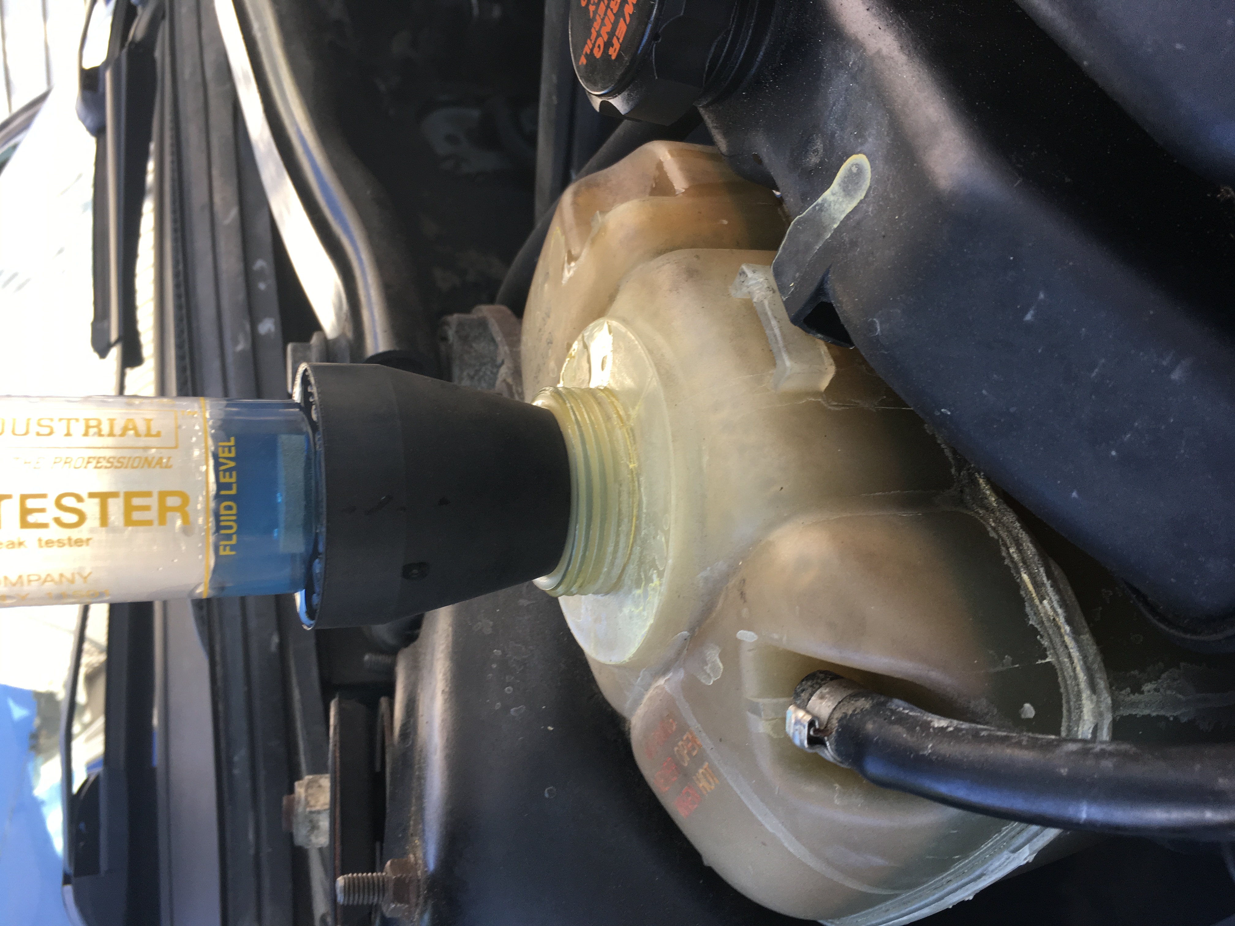

I'm trying to diagnose a low coolant level on my 2001 Volvo V70 2.4T where there are no (obvious) external signs of a coolant leak. I'm hoping to rule out a head gasket leak early on by running a block test. So, I borrowed a block test kit from AutoZone ( http://www.autozone.com/loan-a-tools/bl ... 391378_0_0 ) and ran the test today. However, I wanted to be sure that my test results were valid, since this car does not have a radiator cap, as described in the testing instructions. Rather, I used the coolant expansion tank to do my test.
After having warmed my engine up for 10 minutes and allowing it to idle, I filled the tube with test fluid to the indicated line, inserted it into the opening on the coolant expansion tank, and used the provided bulb to draw gases up into the test tube. I did this for two minutes as suggested in the instructions, and while I did see bubbles forming indicating that gas was being pulled into the fluid, I did not see the fluid change colors.
To confirm that the apparatus and fluid were working correctly, I ran another test with fresh fluid on the output of my exhaust pipe, and the fluid turned yellow immediately as expected.
Does it seem like this was a valid test, given that I was working with an expansion tank, and not directly on a radiator cap?
If this test was valid, then it's time to move on to other causes. I have read that there are some external leaks that don't show any visible evidence due to the coolant being boiled off, or pooling into hidden areas, so my next step will be to start pulling things apart to find the source of the leak...
-- update -- added photo of setup - sorry, not sure why it's not rotated correctly --

Your test procedure was perfect ( nice blank test on the exhaust!) but unfortunately these tests are definitive positive but indeterminate negative)

How much coolant have you added total? A leak at heater core inlet/outlet pipe o ring can lose maybe 2 gallons and not show unless you pull carpet back and look. Unlike heater core itself leaking, this doesn't usually steam windows.
The block test checks for combustion gas in coolant. The crack at top of cylinder that can affect these engines doesn't always show with combustion gas in coolant until it is a more rapid loss with misfires on start.

So the only thing we can say for sure is that we still don't know for sure if it's the head gasket.abscate wrote: 27 Jun 2017, 01:16 Your test procedure was perfect ( nice blank test on the exhaust!) but unfortunately these tests are definitive positive but indeterminate negative)
Are there any other tests I could perform, or symptoms to look for, that would more positively rule the head gasket in our out?

I have added almost two gallons of coolant at this point. I can take a peek behind the carpet at lunchtime... I'm assuming that tools aren't required to move the carpet?jimmy57 wrote: 27 Jun 2017, 07:16 How much coolant have you added total? A leak at heater core inlet/outlet pipe o ring can lose maybe 2 gallons and not show unless you pull carpet back and look. Unlike heater core itself leaking, this doesn't usually steam windows.
I also borrowed a compression test kit. Would a compression test show a cracked cylinder?jimmy57 wrote: 27 Jun 2017, 07:16 The block test checks for combustion gas in coolant. The crack at top of cylinder that can affect these engines doesn't always show with combustion gas in coolant until it is a more rapid loss with misfires on start.
