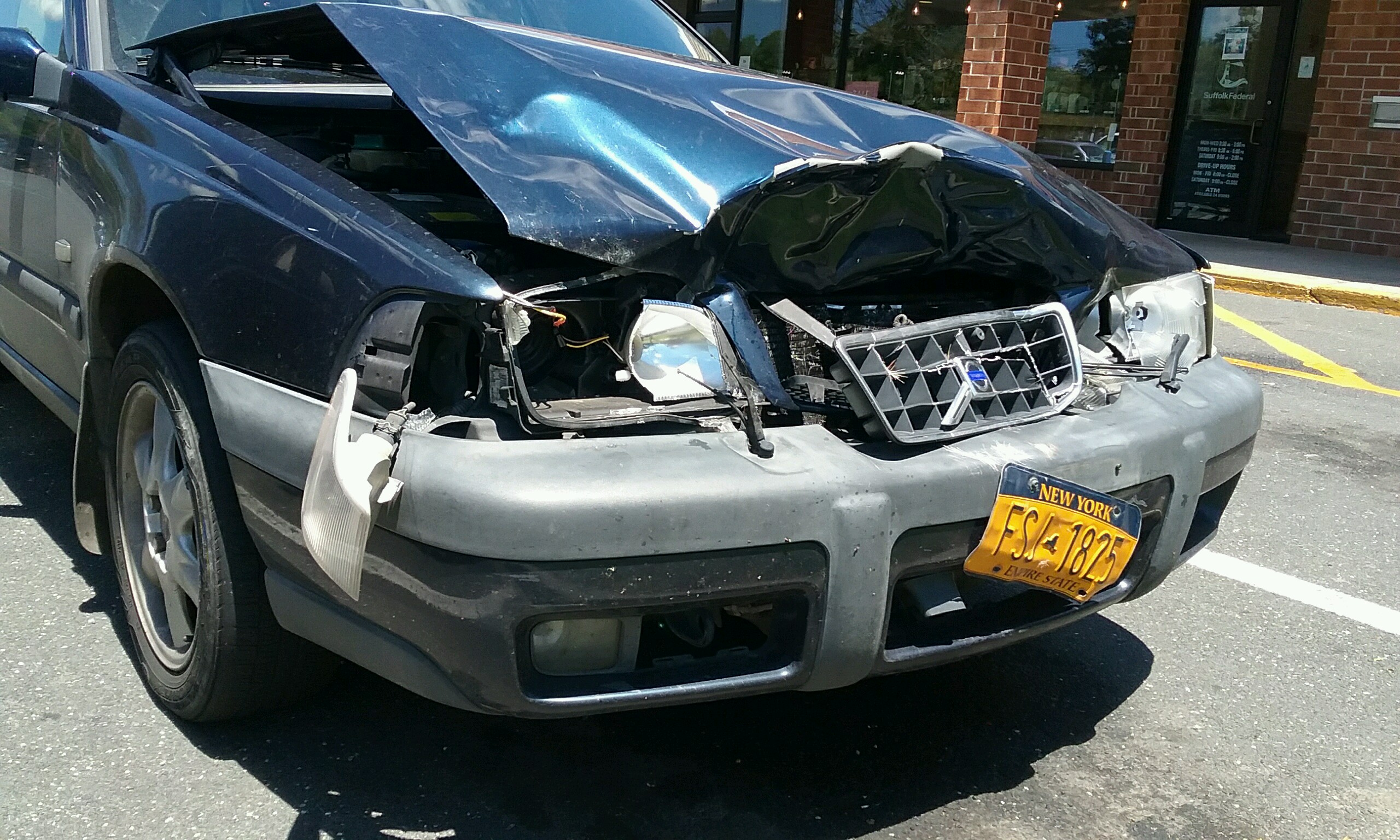

Killed?
That just looks like minor surgery from this end of the net.
There's probably a donor car out there with a blown engine
that would turn this into a simple weekend body parts swap.

Just need a hot iron and it'll smoothen out the wrinkles nicely :D
Sad to see it though.

If that frame isn't bent, I think I would call Erie for matching color parts and put it back together
Hopefully for not too many bucks..

This is a job of an hour or two to replace all damaged parts.

The front end is shot, wouldn't drive straight, the radiator /intercooler/condenser sandwich is crushed, broke oil cooler lines and trans cooker lines, radiator fan, turbo plumbing up front, tore up R/F half shaft boots.
My AWD has bad Angle Gear so I rear rear drive shaft. This '98 literally on has 100, 021 miles on odometer, the AWD is solid, the interior is perfect, paint is perfect and motor is good

It not just body parts, everything up front is crushed and I found a V70XC w/100k on odometer w/good AWD, even the leather drivers seat is in perfect condition. Most of all I'm too busy for ths t shit. I love the V70XCSE, I searched for month's to find a good one,
