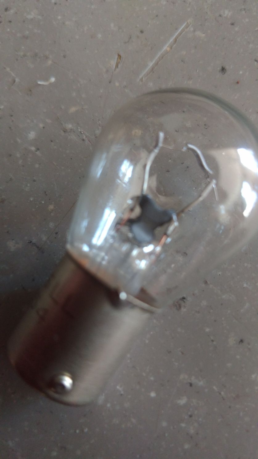

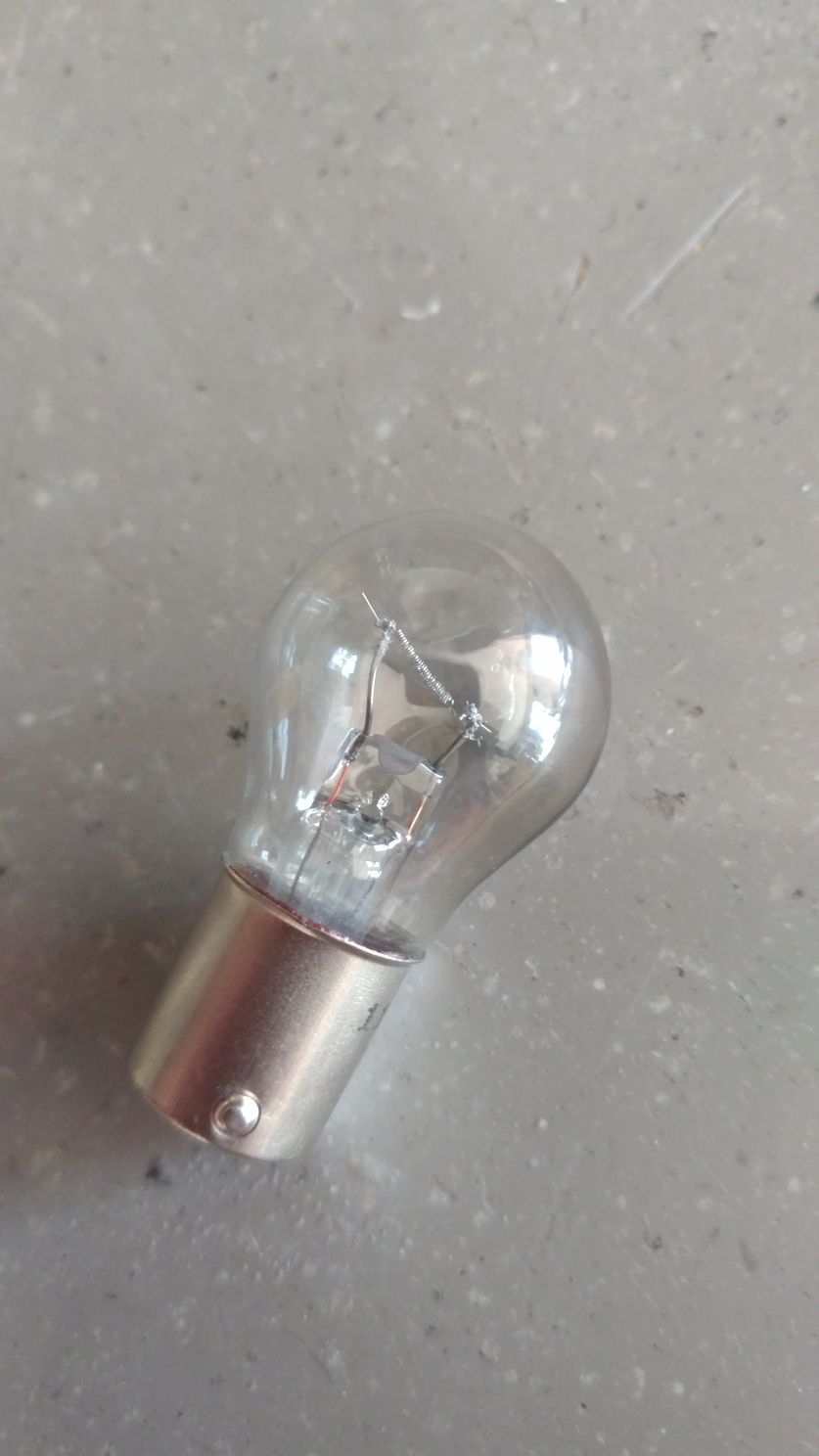

just want to share that I found the issue.
all those anomalies were happening because of brake light bulbs. While back, the dash were showing brake light issue, and at that time I moved back/forward the bulb (left) and it started to work. Later warning came back, this time it was the right one. However after i fiddle with it started to work fine.
This weekend, decided to check them and their internal shaped was changed, replaced them and everything is working fine. here are the photos of the light bulbs.
