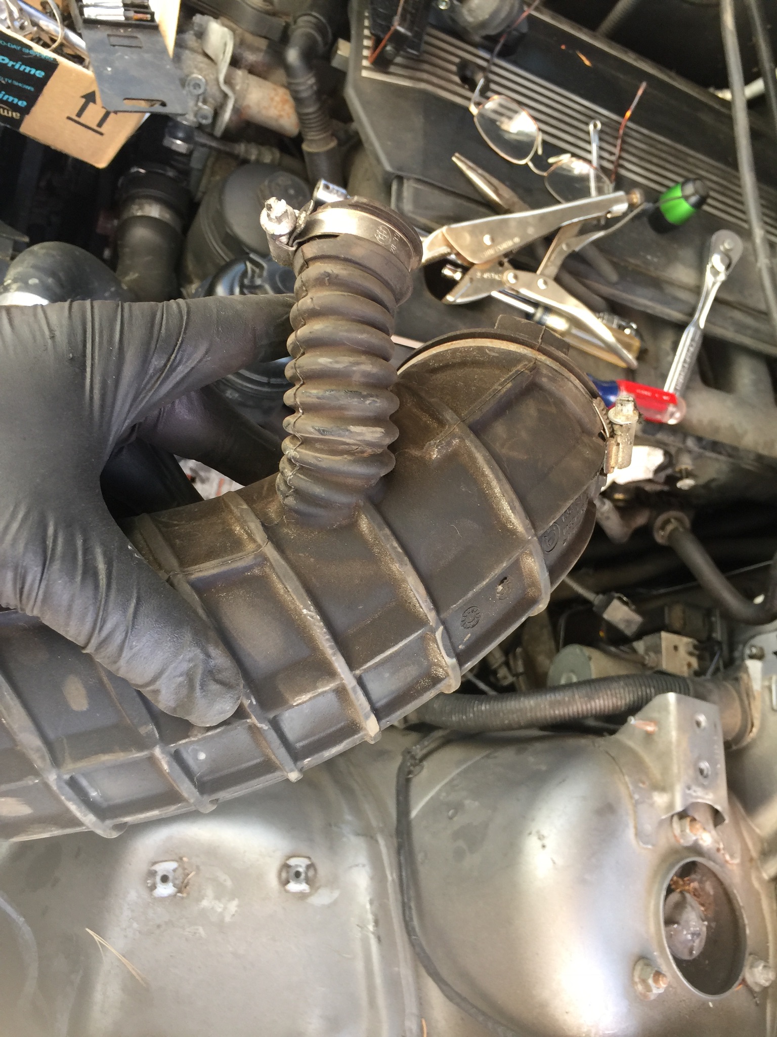

When we encounter poor running or starting, a common cause is corruption in the vacuum hoses in these cars.
Commonly, these throw codes for oxygen sensor, MAF, misfire, or fuel trim out of range.
You can't just look at your hoses to rule them out, I've found again and again that you need all your senses to make sure you don't have leaks.
I had $1300 of work proposed by BMW to cure P0171 and P0174. It was clear no one was diagnosing, they were just Mossberg Mechanicing....shotgunning a ton of expensive parts.
I knocked off the induction in about one hour..it's a pain on this car
Here's is the intake bellows in installed position
Slight pressure on the idle valve bypass
P2/P80 Visual Audible Tactile Inspection of vacuum hoses VATHI

Nice catch! Did they even bother to smoke it? As complicated as modern cars are, a smoke tester is necessary these days for saving time. I should have built mine 10yrs ago.

I built a crude one but decided I would strip it down before I bothered to smoke it. This car, the E83, is known for bad bellows so I knew to really give it the evil eye.
