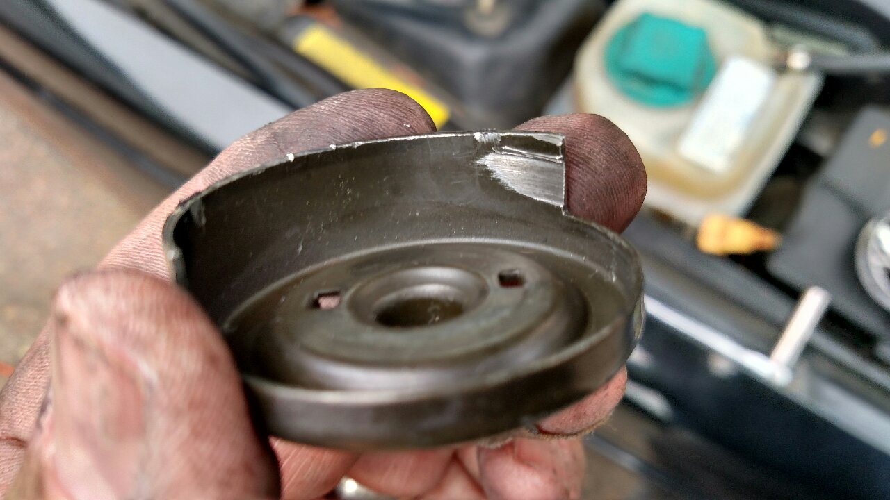

I found a non-running 1998 S70 T5M a few hours from us, picked it up for $500. 154K miles, black/tan. The seller explained the symptoms; sounded like a dead ringer for cam seals. Got it home, found they had throw all the stuff at it you could to solve a random misfire. We opened it up to find new plugs, wires, cap, rotor, cam seals.
The one thing that jumped out at me was how after removing the CPS, the reluctor wheel didn't look square bolted onto the cam. Sure enough, there was fine metal shavings in the CPS housing and one side of the reluctor wheel was ground fresh. We put it back together with the reluctor looking more square or even and tried to start it. The motor cranked and then would stop, like compression lock, like the timing was off, but it would try to start.
Back to MVS to look for the next step. After 20 minutes of searching we went out to start it again, and to our surprise it sarted and ran. Not well mind you, it would not idle but it ran smooth around 3-4K RPMs. No smoke or bad engine noise. We shut it off and tried to start it again. No go. Same un-smooth cranking, and not firing.
I'm sure it will need a new PCV kit, we'll check the timing to see if it is correct.
Would it run at all if the CPS or reluctor wheel was shagged?

Bought a used reluctor and CPS from VoluParts. There are no more misfires, but it still won't run right. When the engine is cranked, it will crank-struggle-crank then start after 25-30 seconds. It will run between 1500 and 2000 RPMs but dies instantly if you don't feather the accelerator. At higher RPMs (3500-4000) it will run smooth, then buck.
I pulled the timing belt cover to find the cam pulleys aligned with the notches in the cover. Don't really know where to go next.
Here's the condition of the reluctor wheel as I found it upon first inspection:
