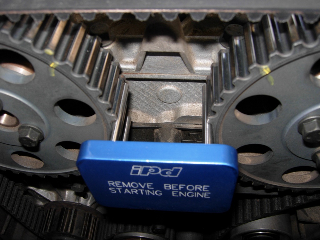

Can I use my ipd cam lock tool that I have from the 850 if it's not the cam seals? I see videos of people using a factory cam lock tool at the back of the engine - looks involved and expensive. But how do you keep them from turning?
If it is a failed cam seal, do the toothed wheels only go on in one position so you can realign your marks?

If the cam seals leak you have to lock the shafts from the back end with the other locking tool.
You can get it a LOT cheaper on amazon $50.
https://www.amazon.com/EWK-Locking-Cran ... T374HCPPGS
If its the crank seal you could use the sprocket lock.
I never bothered, as long as the sprockets are not loosened they are very simple to set up, if you have CVVT hubs its probably better to use the lock on the sprockets , it will save 5 minutes if nothing else.

Ahh, ok, now I see your confusion...
No, the sprockets are not "keyed" to the camshaft, they can spin freely if the sprocket bolt is not tightened to approx 83 ftlbs.
Thats why you'd need the camshaft lock.
If the leak is at the crank pulley you need a method to lock the crank when torquing the nut, there is a crank lock for that.
On the older volvos they used the rope trick in a cylinder, I just used an impact wrench but these 5 cyl's are prone to that nut working loose and blowing up the valves. Its highly recommended to use a new nut too.
So either use the crank lock tool or rope....no impact.

The post 2003 CVVTs usually develop so much axial slop that they pull away from the cam seal. This causes MASSIVE leaks. Your cam belt will be absolutely soaked with oil if this is the case. Never seen a leaking crank seal on a Volvo white block.
You'll need the rear locking tool, some new Corteco seals and both CVVTs (it's almost possible to tell which one is leaking though statistically speaking the exhaust fails more often).
