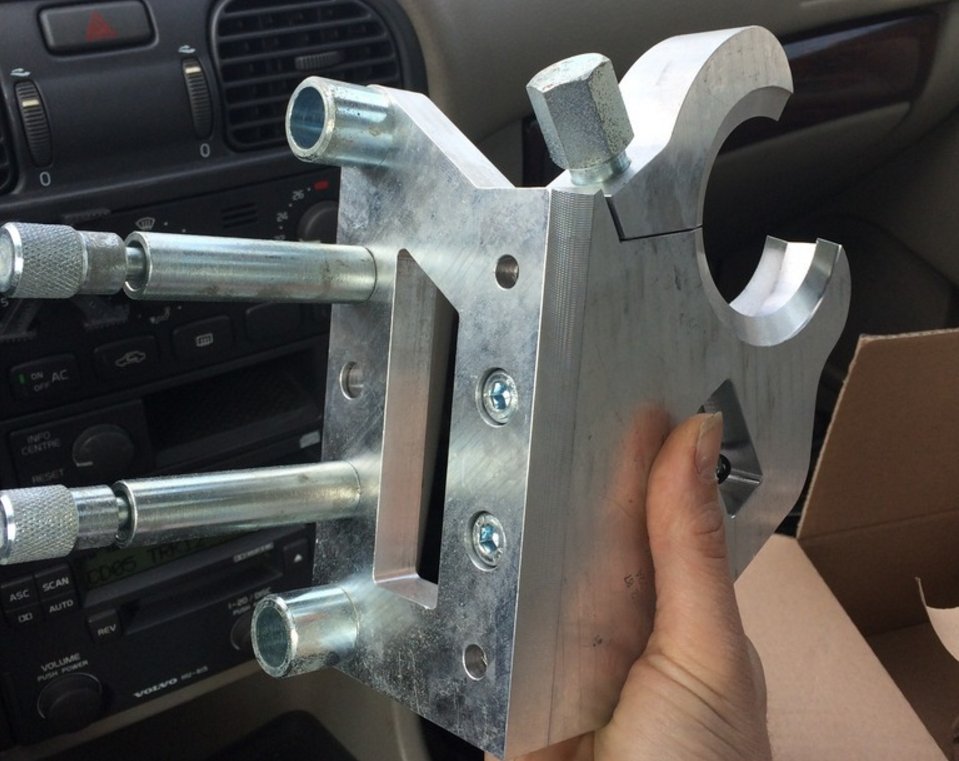

I'm currently researching a process to change the decoupler pulley and the crankshaft seal . It was engineered so you cannot access it without having to remove the bracket where the compressor is bolted on. Im having a hard time trying to find the tool to align the bracket. They call it "position sensor"
I have 109,000 miles on my 2008 XC90. I was told that if you have that many miles, you normally change the belt, tensioner, idler puller and most importantly the decoupler pulley.
Currently I see oil dripping on one of the water hoses just below the pulley. Looking at the diagram, there is a seal where the decoupler pulley is bolted on.
I now have the belt, tensioner, idler pulley and guide pin for the steering pump. As soon as I find who or where can I buy or rent the alignment tool, I will purchase the decoupler pulley as well as the tool to undo and install the decoupler.
This gentleman did it. His engine is less crowded than a XC90 as he can easily access the steering pump.
viewtopic.php?f=31&t=81578&p=447625#p447625
- Crank Pulley.jpg (79.57 KiB) Viewed 7274 times
- Alignment Tool.jpg (102.67 KiB) Viewed 7274 times
Auxiliary brackets.pdf- (254.46 KiB) Downloaded 811 times
