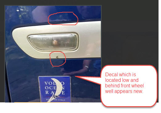

This vehicle does not pass my "sniff test". Something smells. Any proud owner of an ORE would show the placard on the glove box with the # of 800 or at least a sill plate. They were numbered on the glove box placard. Here are the additional facts: The only proof we have that the subject is a real ORE is the paint color and obviously any vehicle can be resprayed (especially one that was in an accident). Also the only marking shown here is just a sticker / decal. My decal was worn off (at about 100,000 miles) and needed to be replaced and I can tell you almost 100% sure that the one shown based on the # of miles is a replacement because 11 year old decal behind the front wheel well... just would not hold up that well. SO the ONLY marking is clearly a new decal. And again, the only marking of an ORE as shown; is the decal. Thinking that even if they opted not for the special ORE interior with blue stitching ... the vehicle also does not have the requisite v-8 engine. The rims do not appear Volvo correct and were probably an aftermarket purchase. Where is the decal on the other side? I'm calling B.S., based on a reasonable amount of circumstantial evidence. Yes interesting.
P.S. Someone inclined to deceive could of course order new ORE sill plate and have a placard made... soooo in my opinion, for the layperson buying an ORE - the engine and interior are very important "tells".
