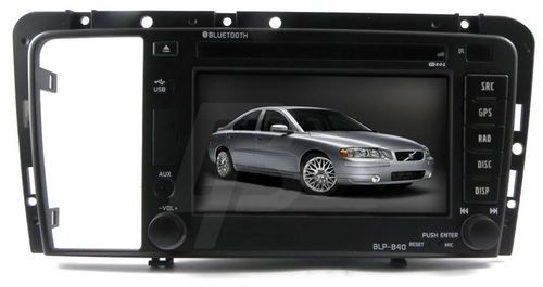

I have a 2007 S60 2.5T and I'm looking to replace the stock radio with and aftermarket one.
I want something like the Bluepower (http://www.vivaperformance.com/bluepowe ... v70-05-09/) that simple can attach to the existing AC module.

Pre facelift (-2004) there are more options. But for MY05 and later the BP-840 is the only thing you'll find that looks like it belongs in that space/OEM-look and less likely to attract thieves. Believe me I've looked. Early versions of the BP-840 radio had massive issues, but that was more than 10 years ago. It's been updated since then both in the hardware and software. It would be nice to see feedback from someone who has taken the plunge on a new one to get some feedback. I probably, eventually, will try one of these myself. If it works good, it's a tremendous bang for the buck and updates these cars (which usually weren't fully loaded) with some modern conveniences which are pretty standard now, such as digital media, GPS, and reverse camera. And you get to keep your cubby or cupholder. I'm not sure I could live without that little cubby-perfect convenient spot for sunglasses and the little green Starbucks cup stoppers.
