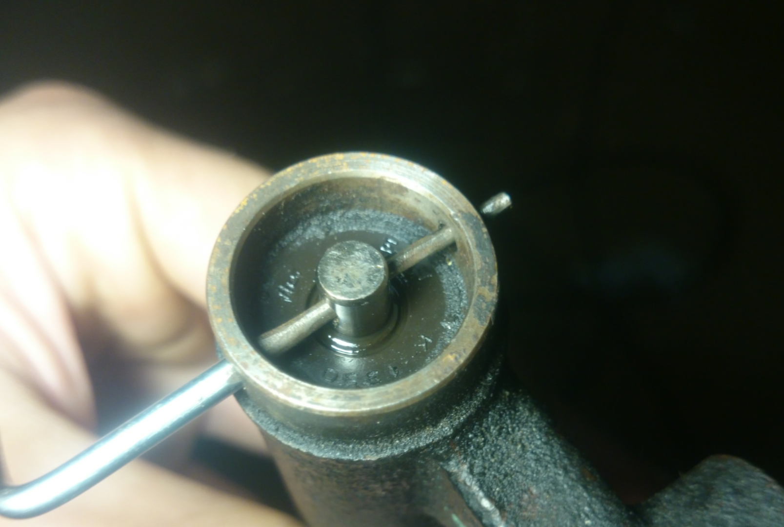

One more thing, when I compressed the hydraulic tensioner, there was little bit of oil coming out, not that much that after tilting it to the side it would leak, so I think it's okay to use? And I don't really know how tight the belt should be, but when I apply some force, I can move it side to side on the cam sprockets by hand, is it normal? Hydraulic tensioner probably has 70 - 90 k kms on it and is 5 years old.

How fast did you compress the tensioner?

Before using any TB pulley bearing, put your ear on it and give it a spin. If it makes ANY NOISE, reject it! Been there, done that. Don't use it. It should be DEAD QUIET. NO exceptions!
Compressing the hydraulic tensioner needs to be done VERY SLOWLY to prevent ruining the inner seals.

I compressed the hydraulic tensioner slowly, as stated in Robert's video, a half or quarter of a turn every few minutes, and took a photo of it. It took me a hour or so to fully compress it.

was there a plastic cap on the end of the tensioner piston? The Volvo timing kit I used last time came with a new one in it. If the tensioner is leaking oil, then it is toast and maybe you are not getting the full tension to keep the belt taught?
