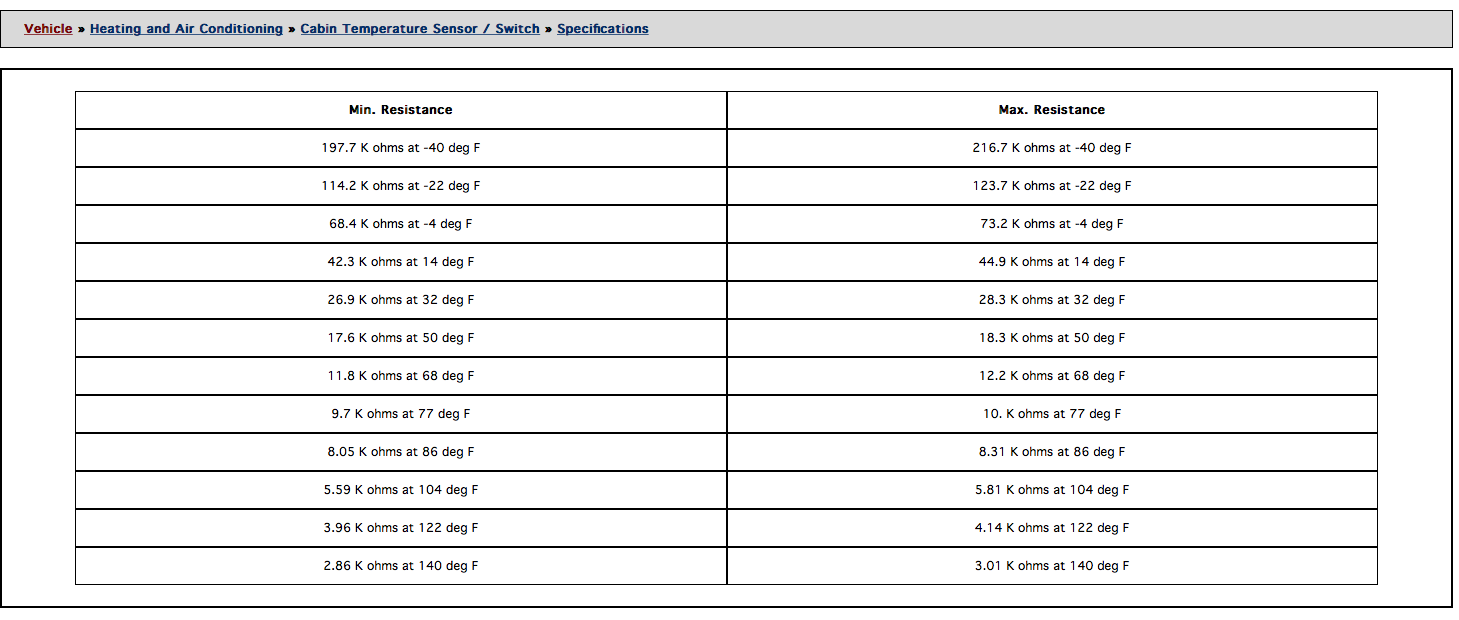

is there any way of checking the sensor? in my world (vw golf mk2 world). we've got the infamous "blue" tempsensor. its possible to readout the resistance at a given tempereture to check if its within the threshold.
don't know what kind of sensor the cabin air temp sensor is (thermistor?). if so it should be doable. if it exist a chart of known good values
Found it for ya.... Jubel!!!
Heres the outside air temp specs, too - this one sits down in the climate system, inside the car, next to the fan.
Screen Shot 2017-09-13 at 6.23.18 PM.png (26.35 KiB) Viewed 1555 times

i tested the cabintemp sensor today. and it seems to check out. unfortunatley its a bit hard to get accurat readings. but they seem to be within the tolerances.

soo. i've finally got to measure the "duct" temp sensor. its the one behind the glovebox? see attachment.
however i cannot get this to corrolate with the chart that abscate posted.
at ~18-20c i get about 12.8k ohm across the the prongs.
i even had it at 14.4ohms at one time..
what gives? could this sensor be bad? the ECC didn't like being powered with the sensor disconnected. started to blink a steady red on the LEDs.
