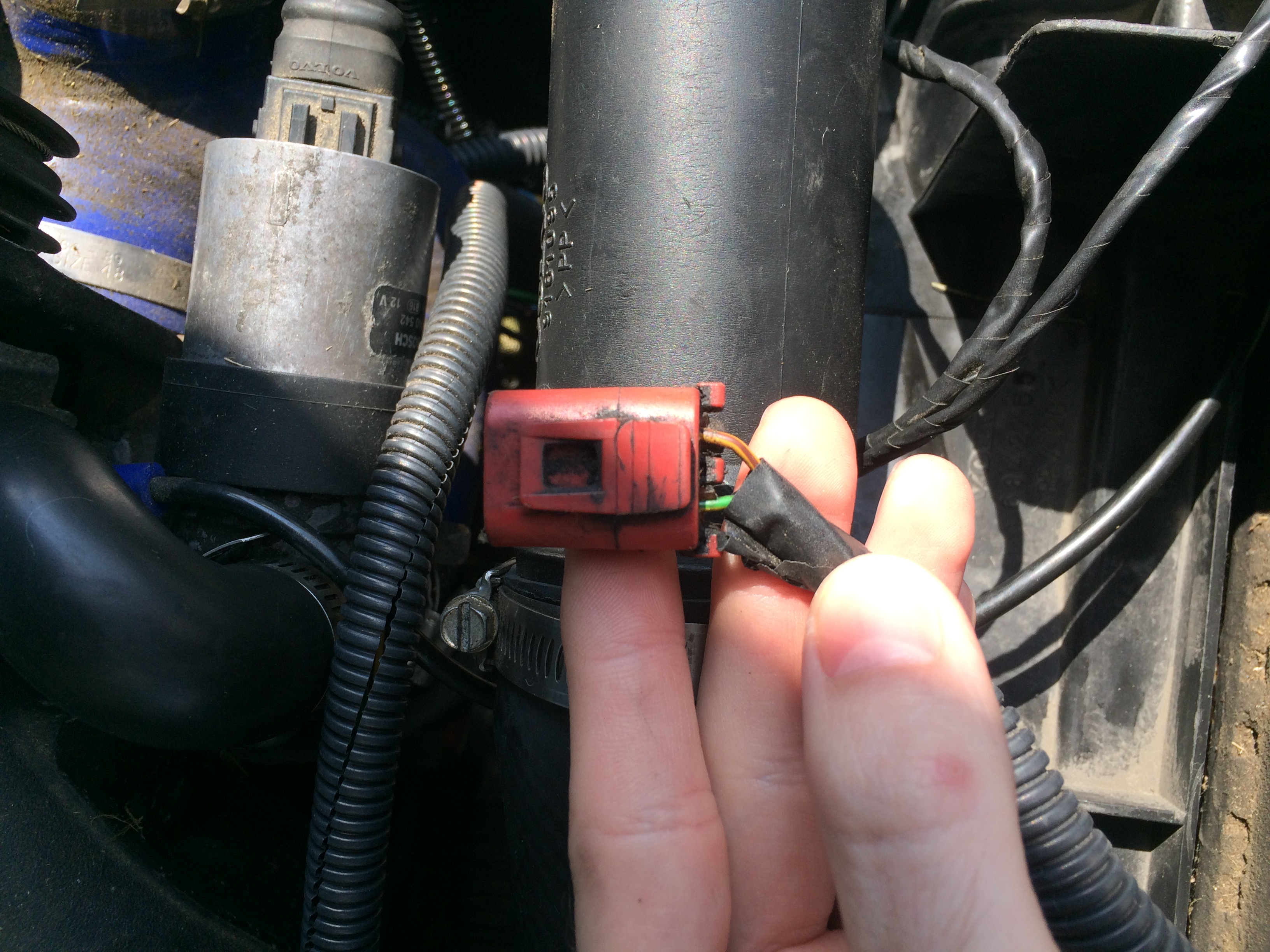

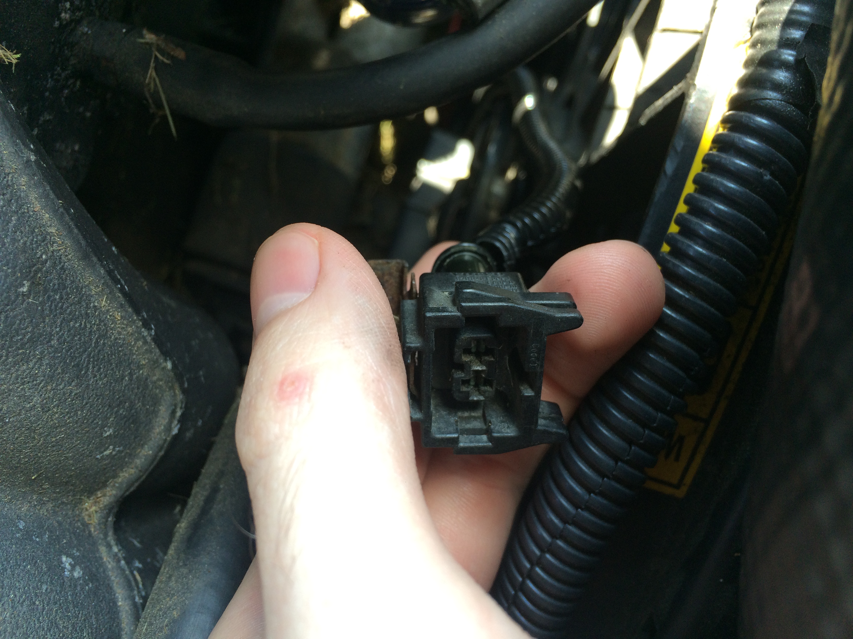

Attached are the 2 connections that I cannot find the male ends for. I don't remember if they were extras when I started, or if they actually go somewhere.
I was able to use the attached diagram to confirm that I have the cam sensor on the correct connection. So I'm assuming I have the crank sensor on the wrong plug, but don't want to just go swapping things around and get myself into more of a mess.

Most Volvo connectors have ridges that prevent you from plugging them into the wrong item. Also, harness is usually tightly positioned to prevent that as well, hard to mess up, unless someone tries very hard.
A few weeks ago I replaced my cylinder head for a burnt valve. After all was back together the car would not start at all. Key wouldn't even crank also would not push start. Had a bad wire in the manual swap harness. If you are cranking and have no spark, must have another issue. Maybe a bad ground somewhere.
Cam sensor plug is a known weak link, the connector falls apart. Do check to make sure 7 things are connected...
1. Cam sensor
2. Crank sensor
3. Throttle position sensor
4. Idle air control valve
5. Turbo BCS
6. MAF
7. Fuel injector relay.
You may also find a connector for the EGR valve if still installed.

erikv11
Posts: 11912
Joined: 25 Jul 2009, 14:03
Location: Iowa
Has thanked: 311 times
Been thanked: 817 times
Post by erikv11 »
Pretty sure the red one is for EGR, which your 94 harness has but your 97 engine probably doesn't have.
