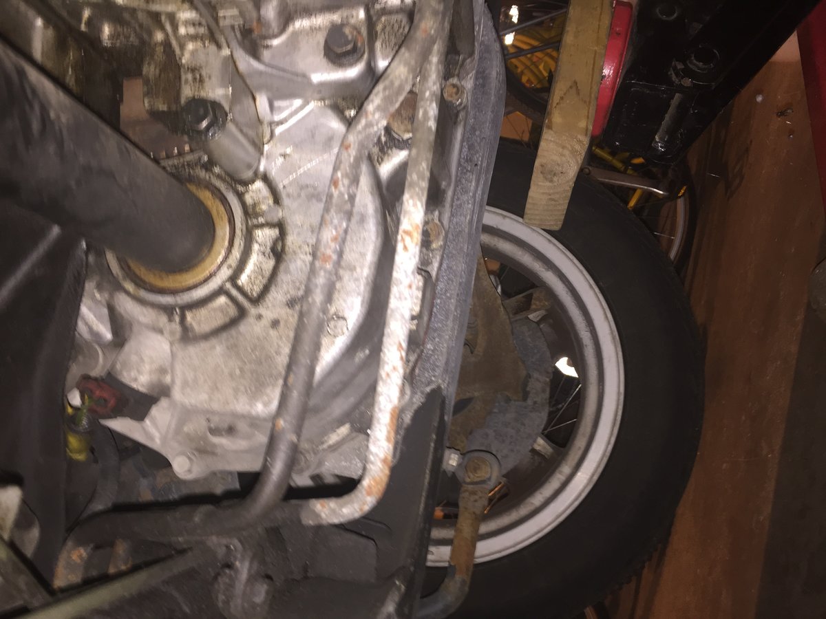

Here are a couple pictures I took this morning. I don't see anything wrong with it.
You can probably see the ATF all over the subframe behind it and on the tranny above it.

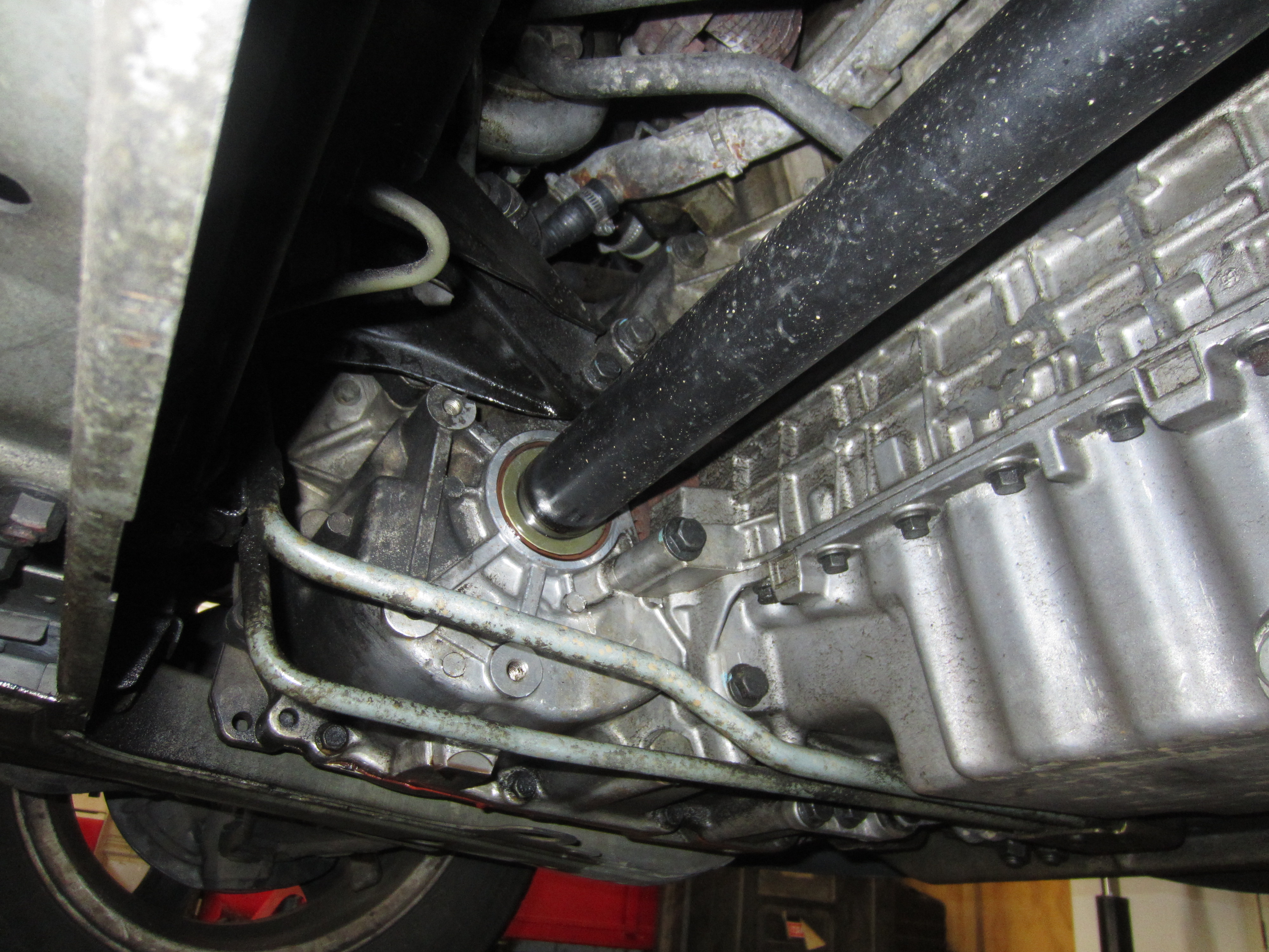

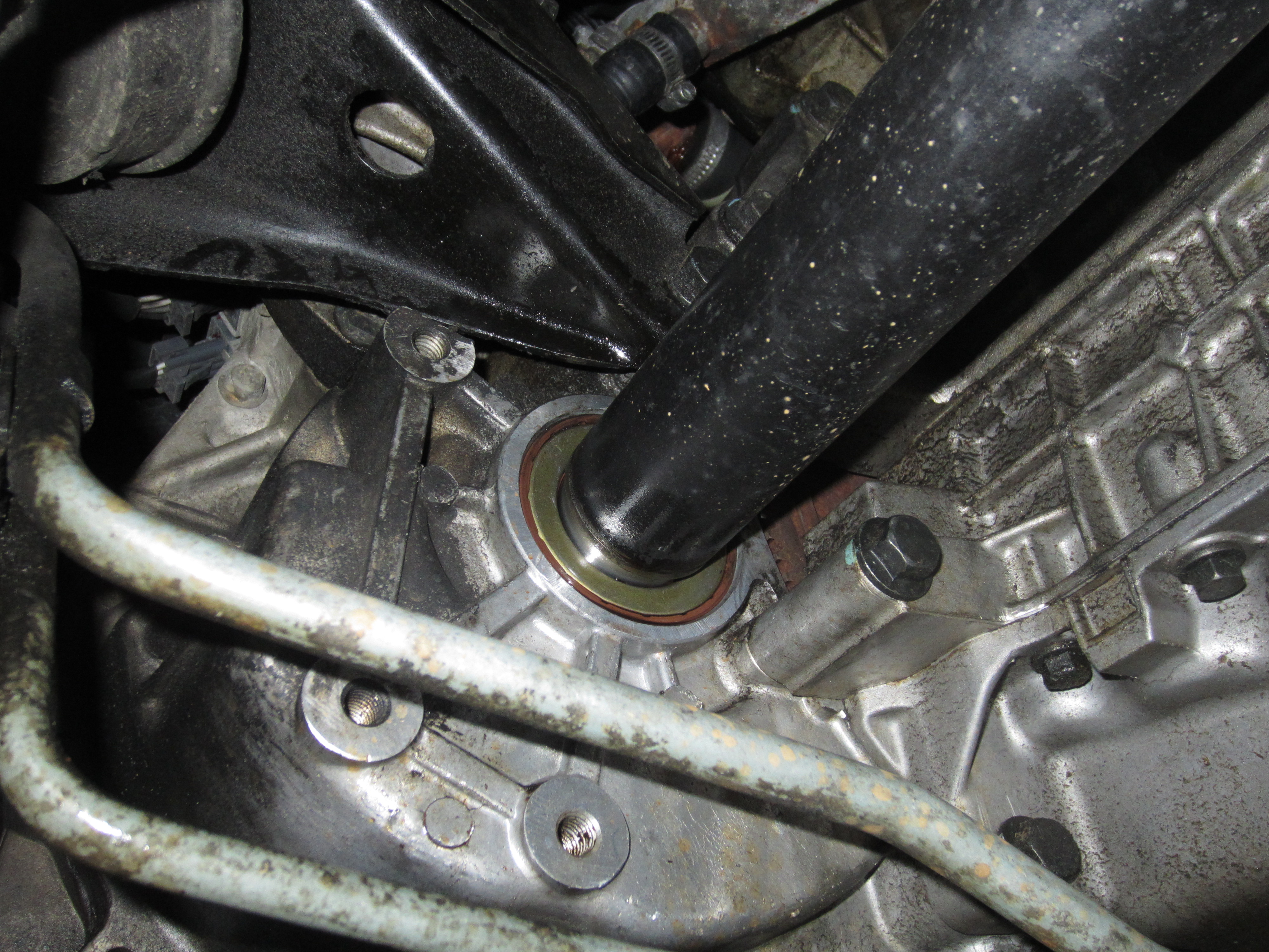

I was curious to see the visible, shiny part on your axle where it meets the trans. I finally looked at my 95 tonight, it is on stands in the garage. My pic is lousy but you get the idea - no shiny part outside the trans case. Longshot but I am wondering if yours is seated all the way. Is the support bearing in place properly?

Those are good tips! Interesting notes on that thread as well. I'll try to pull the seal flush sometime soon and see if that stop the leak. I'm just sick of removing that axle!
Yes, the axle is seated as far as it goes. The support bearing is lined up correctly. I also thought it was strange that you can see the shiny part outside of the transmission, but it looks like it's providing enough of a seal.
