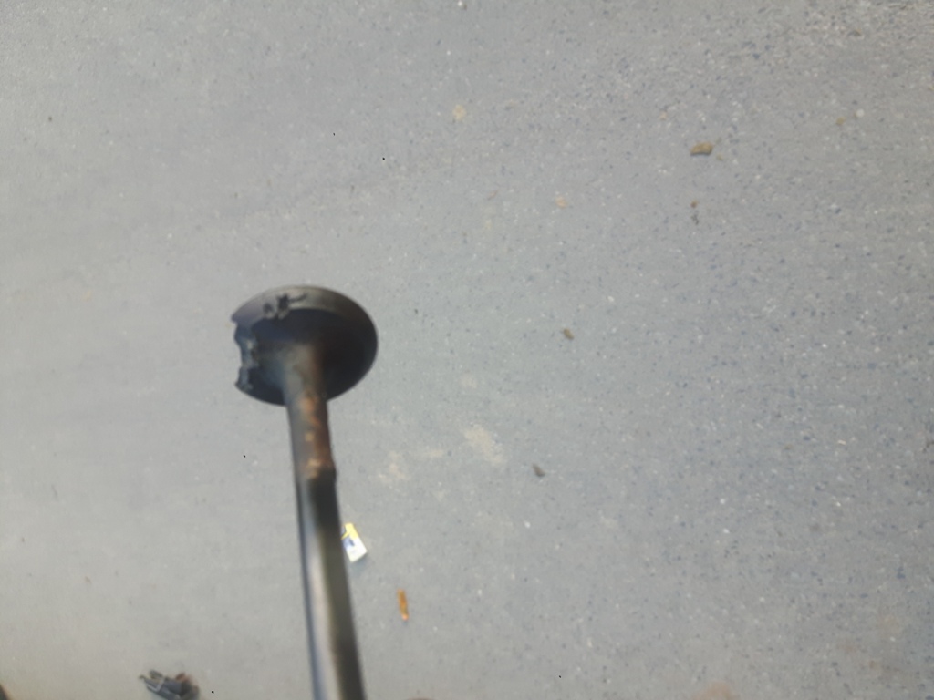

Hello brothers and sisters!
My T5 just lost one cylinder, ive have unmounted motor parts and it was a (I guess) exhaust valve, it was missing a piece :(
The problem is that i have there 5mm valves, but everywhere for sale is only 6mm valves! Couldnt find any in ebay and by my parts dealer!
Have anybody a clue, where or how can i find 5mm valve?!

Interesting they are usually 6mm or 7mm !!
Part number according to Vida for your VIN is 9454610 which is a 6mm valve. Did somebody recondition the head before you owned the car?

Yea head is in very bad condition and it looks like somebody was digiling with it before me :(, i have to find new one now
