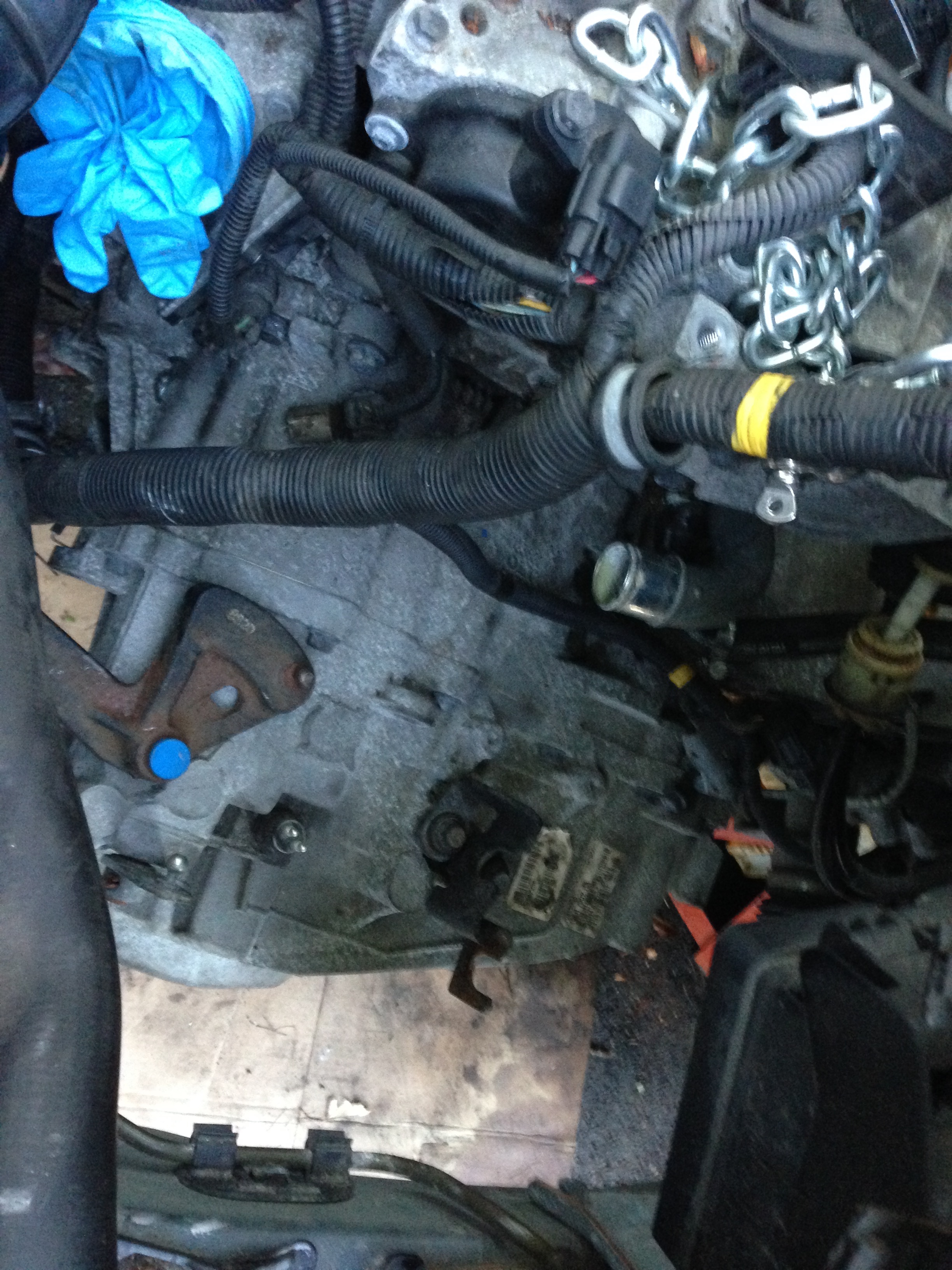

Now I'm reading VIDA a jaundiced eye and sure enough the " 7 bolts holding engine and trans together look like this ....
Captions are all messed up, sorry...will fix
