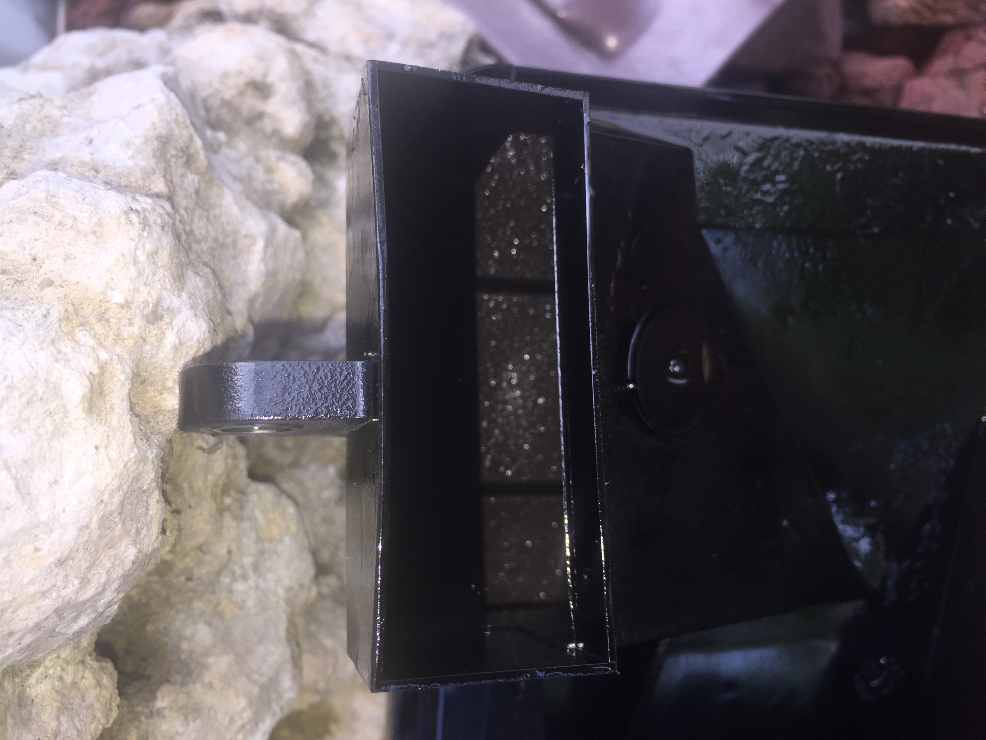

I've done it, it takes patience and lots of shop rags.
Here are the pictures.
Here's a fouled filter.
Fouled Filter
Fouled Filter
Here's the clean filter, mesh is about 10mm up into the filter. The pickup sits about 5-10mm off the bottom of the case.
Clean filter
Clean filter
In order to remove the filter, you need to split the bellhousing section from the main body of the transmission. After that, the pump has to be removed to get the filter out.
Internal view, filter removed
Then, you can install a new filter. so much work to access a $12 filter.
New filter installed
