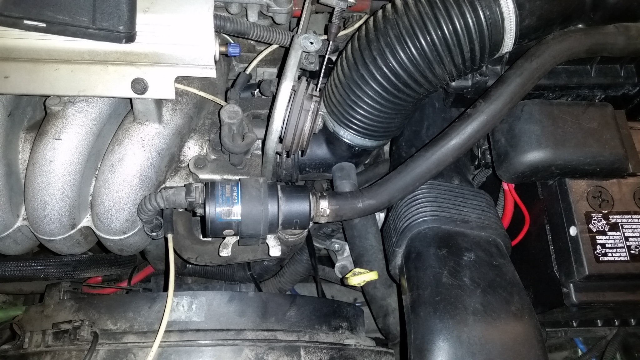

Hi there
I have spent a bit of time researching about the IAC valve and watched a few youtube videos and looked up parts on amazon etc...everything was rosy until I opened the cover...to my confusion, I couldn't find the IAC valve or anything that looked like it? Shouldn't it be a shiny round bottle like structure with 2 big tubes connected to it. I looked again and found a small round bottle like black structure with 2 small tubes connected to it. Nothing like 50+ or so pictures that I see on the internet.
I have a 1996, 850 GLE 5 cyclinder 10 valve 4 dr base model.
My Idle air control valve looks like this below: My question is that is my IAC valve cleanable? If not, where can I buy one? Dealership says Volvo don't make them anymore and I searched around a bit and couldn't really find one either.
Thanks a great bunch!

It's the same I have problems with on my car. I haven't yet fixed mine, but my trusted Volvo mech told me to disconnect the two hoses from the IAC and the wiring, remove the IAC from the car, pour rubbing alcohol into both ends and block them off while you give it a vigorous shake. Empty the IAC and repeat 5-6 times. Do not use compressed air or something harsher than rubbing alcohol as the valve in it is supposedly quite fragile.Quicken wrote: 14 Dec 2017, 02:40 My question is that is my IAC valve cleanable? If not, where can I buy one? Dealership says Volvo don't make them anymore and I searched around a bit and couldn't really find one either.

That's an interesting point. I've always cleaned them out with carb cleaner but maybe it's better to use something milder, e.g. rubbing (isopropyl) alcohol.
